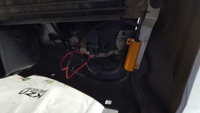

I fit many bulbs and kits. They left the bulb loose those H8 bulbs will burn the fender liner or fog plastic in about 5mins if it's left loose or just hanging there. They get extremely hot. If you can look at the bulbs it will be melted on something. Sorry to hear about this.
Even these get extremely hot I make brackets for them any mount them away from anything which can burn.

I am guessing the bulb was not properly fitted in its housing and could have come loose causing plastic or wiring to burn, therefore the Front Electronics Module did not see a short circuit and shut down that circuit? BMWSA does have a dedicated Thermal Incident Investigator. I am sure he will get to the bottom of the cause.

So it took BmwSA 3 weeks to get the damaged parts to midrand. I was told they busy investigating and they will get back to me, then i was told they still waiting on the parts. Eventually on the 17 December they gave me feedback, that because i used a non approved bmw part (the fog lamp bulbs that steven advertised previously) that caused the fire at the fog lamps. Obviously that is not the case but just an easy way out of putting the blame where it belongs, with Club Motors Randburg ARC.
