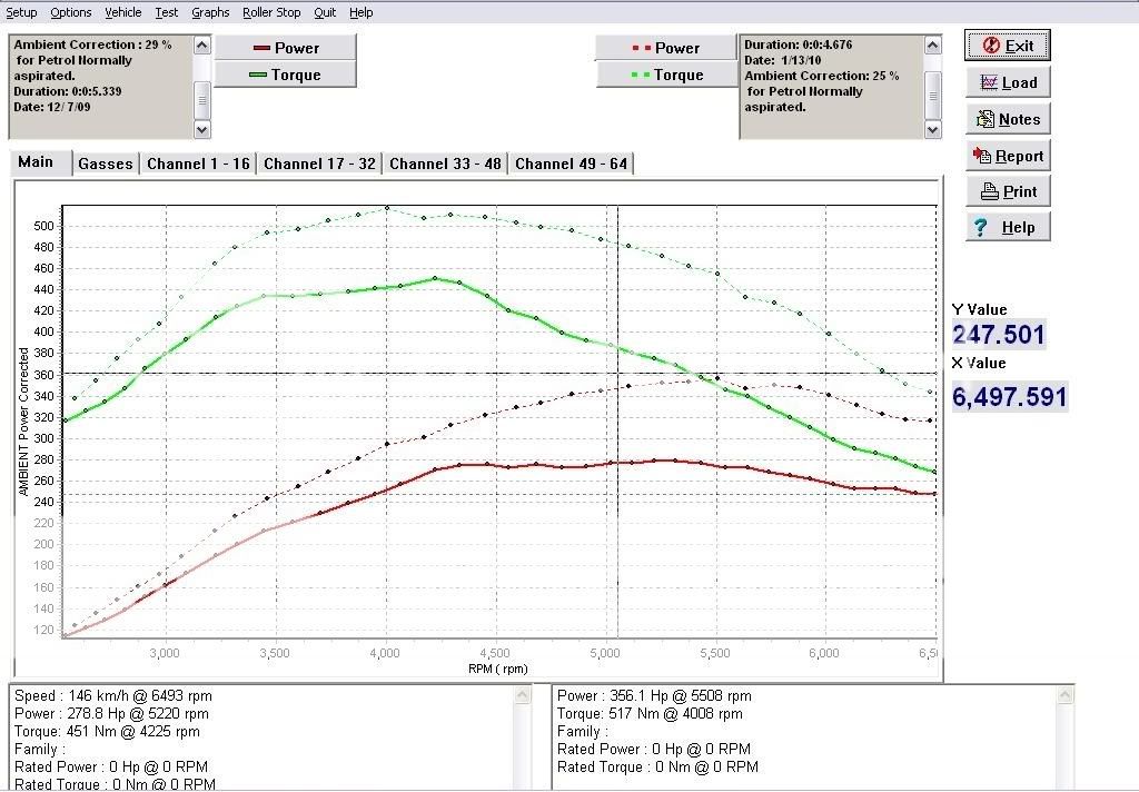

335 with only chip & DP's. On pump nogal. Special one this is. Made a new map to optimise the advantages the 76mm DP's give & it made 356hp at KAR (265kw). The graft is against a the strongest bone stock 335 ever dyno'd at KAR. 279hp with is 208kw. So it's our special car against the strongest stocker tested. Quite a massive difference there, 335 is teh tuna's dream. There's like a 75 wheel hp difference at high rpm.
