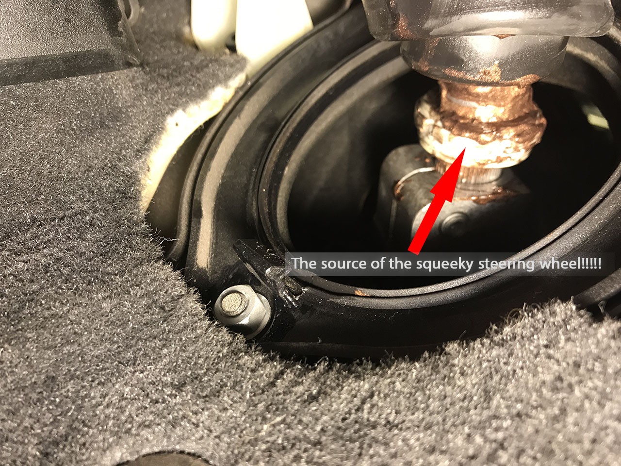

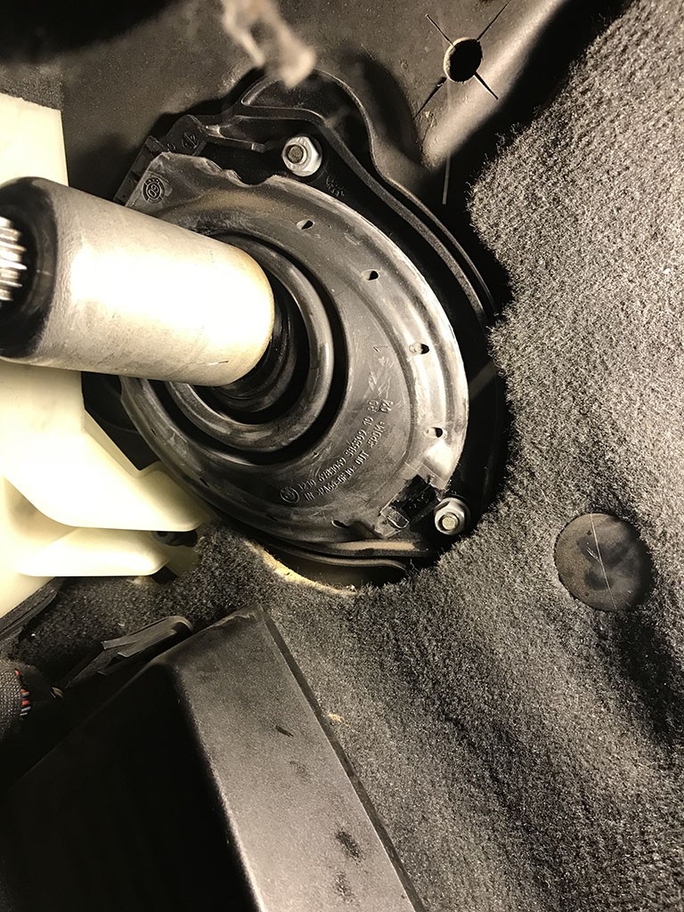

So I finally found the EFFING source of my squeaky/squealing steering wheel!
I always thought it was coming from the plastics of the steering wheel where it joins onto the steering hub/column thing, hence why I bust the Coil Spring cartridge trying to find the source.
I could swear the sound sounded like it was coming from just behind the steering wheel and after all the shit I just went through in the above post I still had the damn squeak/squeal! :rage:
So I scoured the internet and found one vid of a guy who said if your steering wheel is making a noise then try this. So I tried it.
Need to remove this
and this little plastic piece of shit is the source of all this effing drama I just went through FFS!
I greased this thing up with copper paste and BAM! Steering wheel is as quite as a mouse!

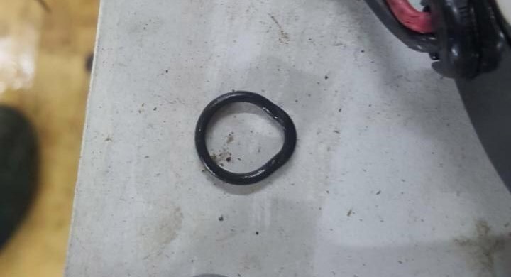

Ever since I got my car back from BMW it had this strange coolant leak, I always thought it was just the radiator as my radiator had a small leak...Well as you all know I changed that recently.
While changing the radiator while I was under the car I saw coolant leaking from a pipe above the downpipes out the turbo. Well BMW recently replaced the turbos so it was something they needed to deal with.
I took the car to BMW two weeks ago and it turned into a horror story as usual. They stuffed up and wont take responsibility and tried to make me replace 5 pipes at 8k and then 10k labour plus 2.5k assesment fee so 20.5k in total.
Anyways not going to go into it all as its a long story but I took the car away from them and refused to pay a cent and took the car to Afzil and he sorted the car out for me. Turned out to be a damn Oring that BMW pinched while fitting the coolant pipe to the back turbo. R60 part!!
BMW Lied about allot of stuff and I have opened a case against them via BMW SA. Tired of these people trying to take me and other people for a ride.
They even lied about changing my oil when they replaced my turbos. It turned out that they only topped it up!

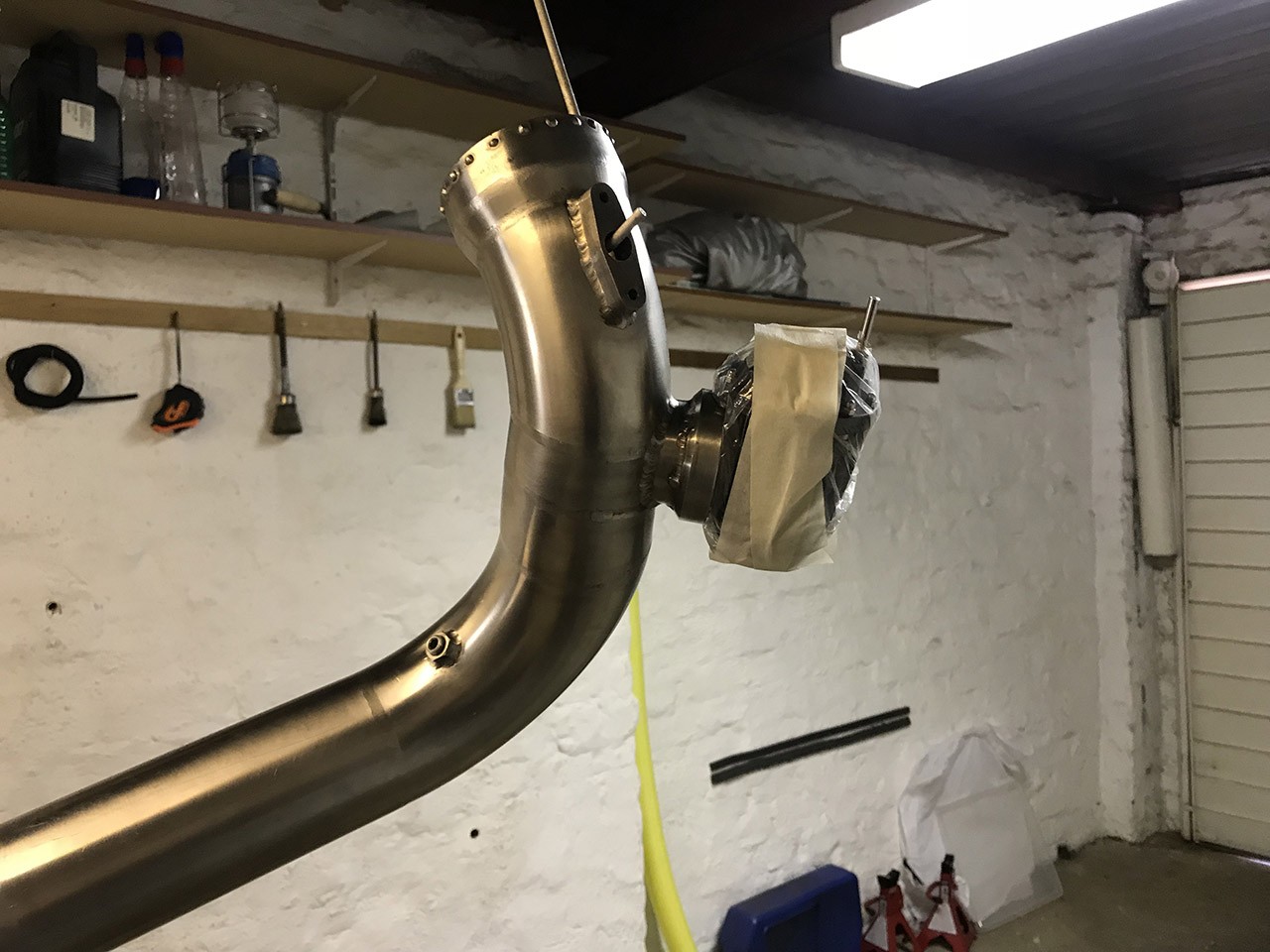

Anyways here is the part they screwed up causing the leak. :dunnoanymore:

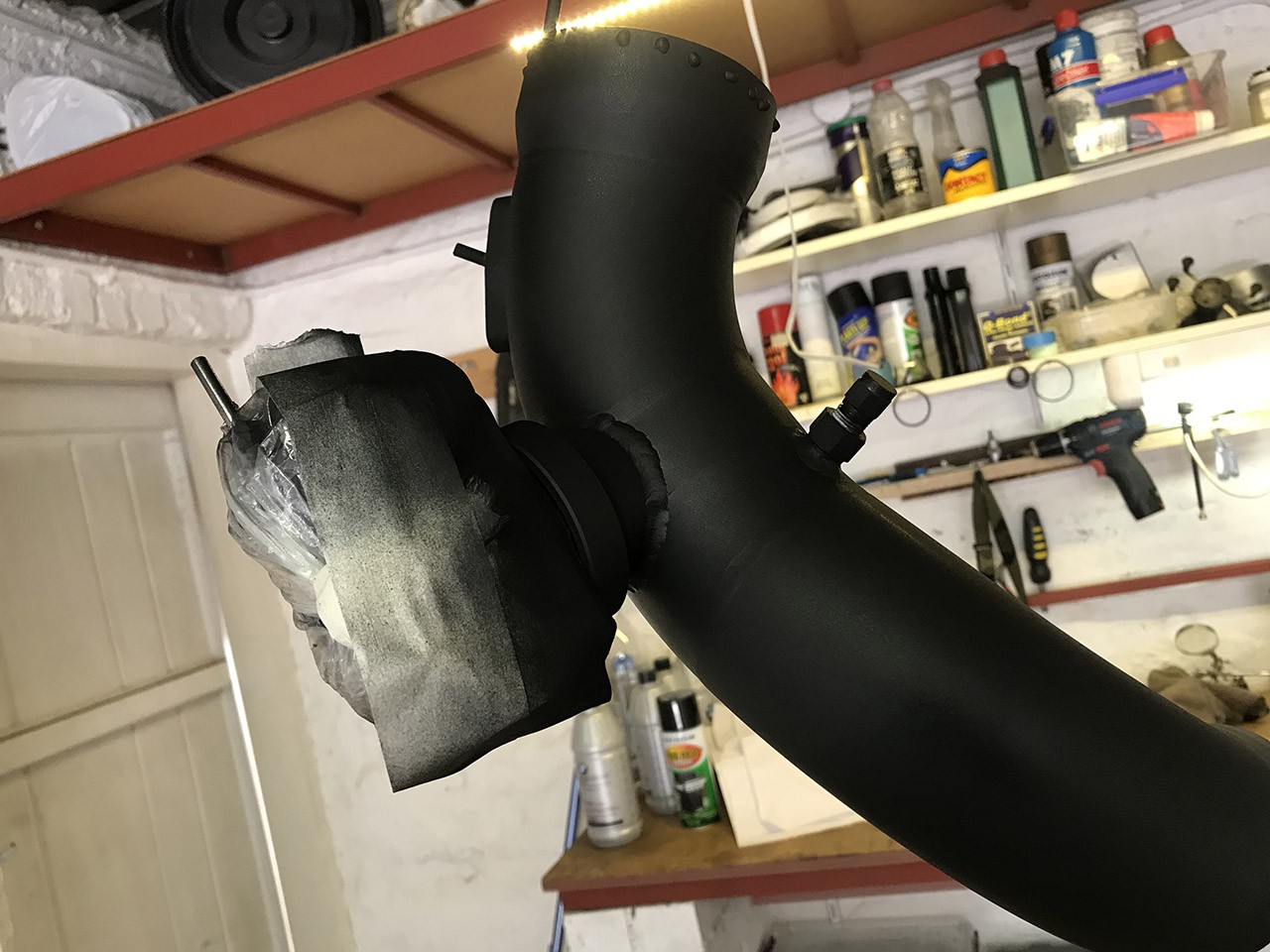

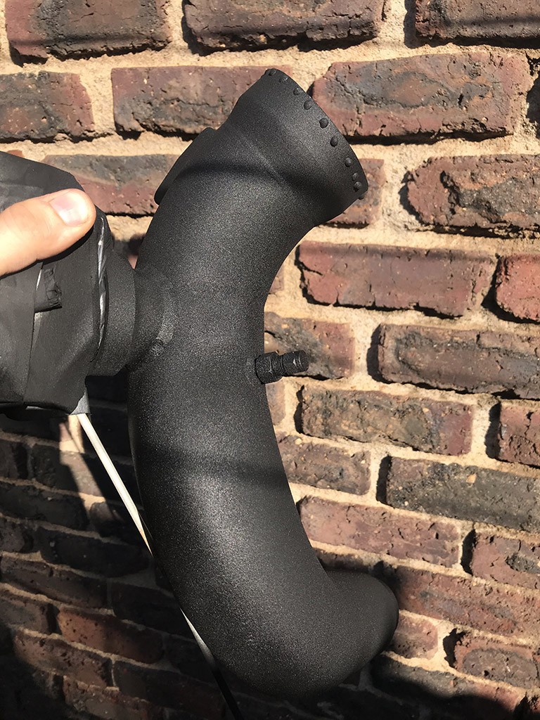

So here is the charge pipe before spray and prepped for spraying. I don't like bling under my bonnet!
Primer applied....Rust-Oleum:
Then sprayed with textured Rust-Oleum paint, looking awesome! :smilebounce:
Afzil fitted my bigger intercooler and this charge pipe for me after fixing the coolant leak! I haven't taken pics of the charge pipe in the car yet but damn this HKS BOV sounds so flipping awsome!

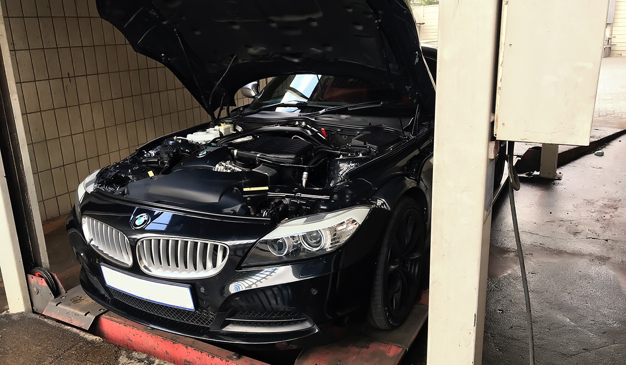

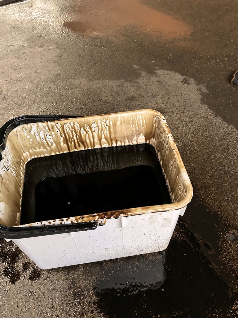

So after finding out that BMW didn't actually change my oil like they told me I decided I definitely need to change out my oil ASAP so I am doing a deep flush.
I first put 1L ATF fluid in the engine and drove to my trusty car wash where I get to use the lift. This lift is getting well used by me. regular chassis cleaning sessions, finding the old mechanic's stuff ups! and now an oil change!
So I drained the oil and this is the mess that came out! No metal filings or anything. Just damn dirty oil.
I bought two bottles of this stuff for now. so I filled up with this stuff which is apparently pretty good oil, at the end of this week I will drain this from my car and fill up with the second bottle and another 1.5L and replace the oil filter and drive with that till the end of the month.
I will then drain that and then put Motul or mobil 1 0w-40 or liqui moly, still researching for now.
