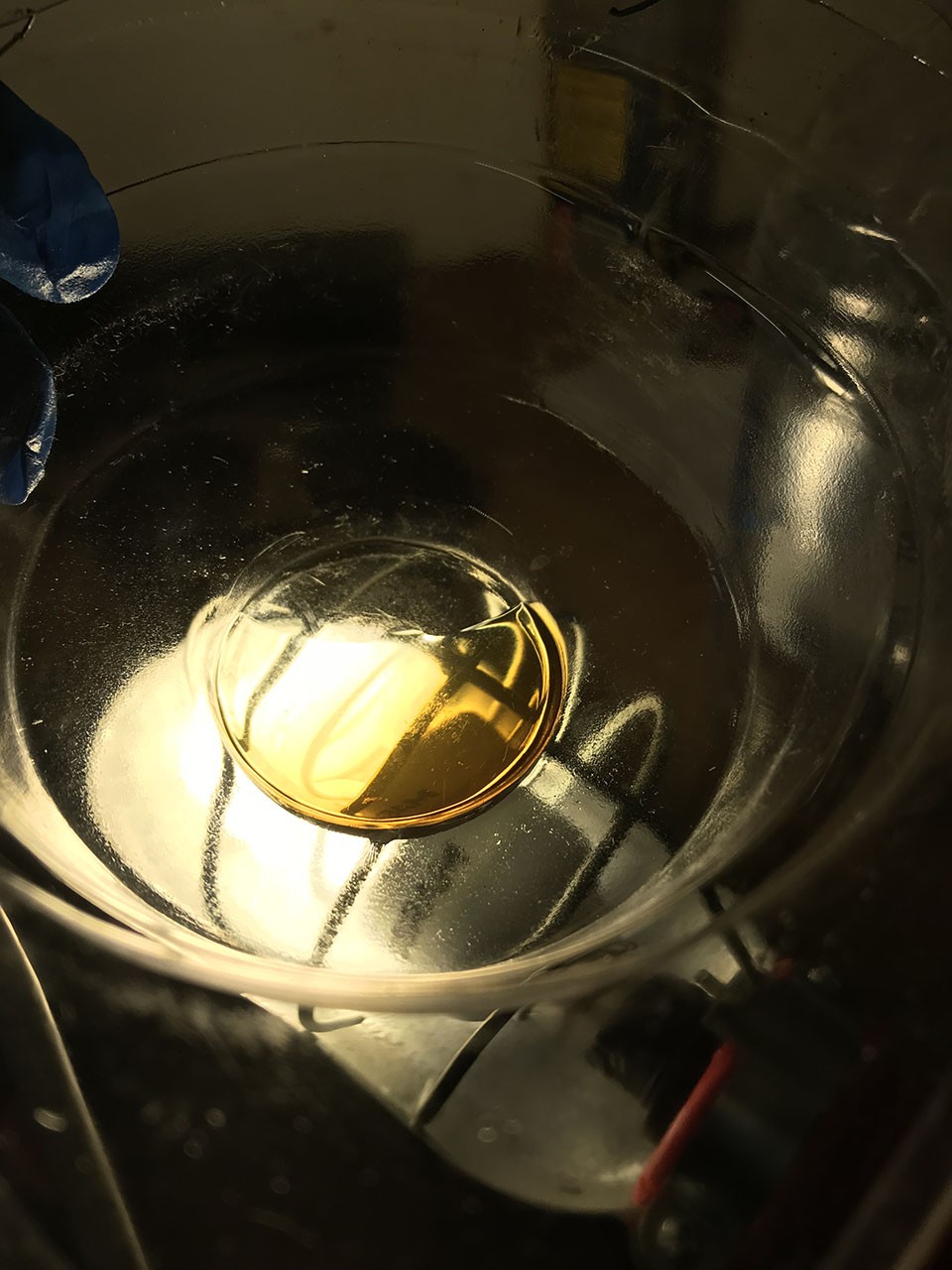

I decided to open the oil filter housing to see how the new oil is looking and I am very pleased with the results. The 4 oil changes definitely made a difference.
As I took the oil filter out I noticed golden drops of oil dripping off. This made me smile and here is a bit of oil I pulled out with a syringe to show you guys. I will probably change the oil out one more time at the end of Jan just to make sure its super clean, Its hyper OCD I know, All I know is that turbos will last longer and sludge wont be part of my cars vocabulary while in my care ever.

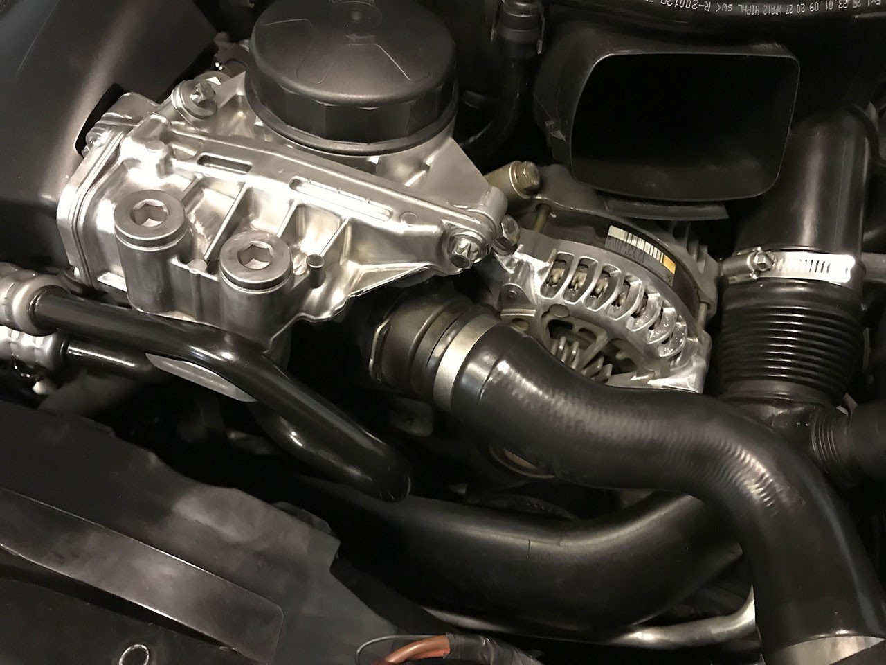

I then decided that my Alternator was looking crappy so I decided to attack it with my Dremel, I went through 3 wire polishing tips, but it looks much better. I also polished the oil filter housing a bit more as you can see.

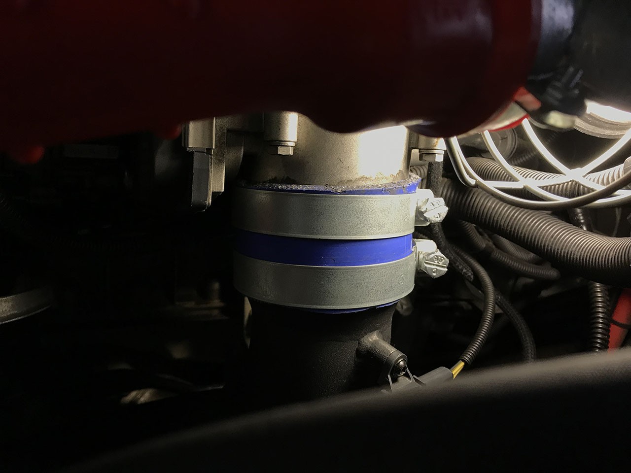

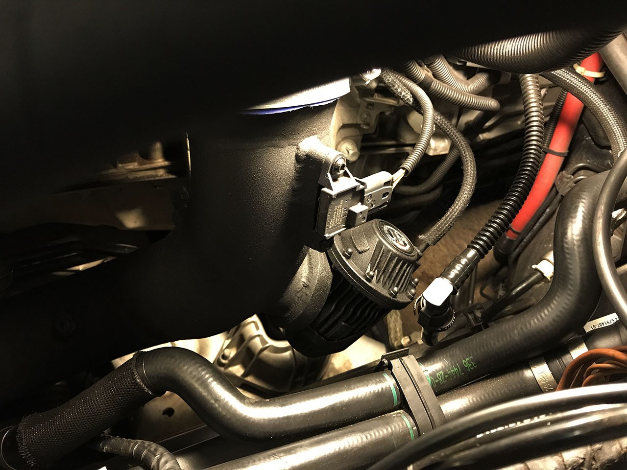

So yesterday I had the unfortunate luck of the charge pipe blowing off from the throttle body inlet.
It appears the clamps were not on very nicely, they were too close to each other so it was clamping the charge pipe nicely but the second clamp was only just biting on the very edge of the throttle inlet.
anyways I managed to get home, car drives surprisingly well with no charge pipe :smilebounce: I feathered the throttle though but it drove fine.

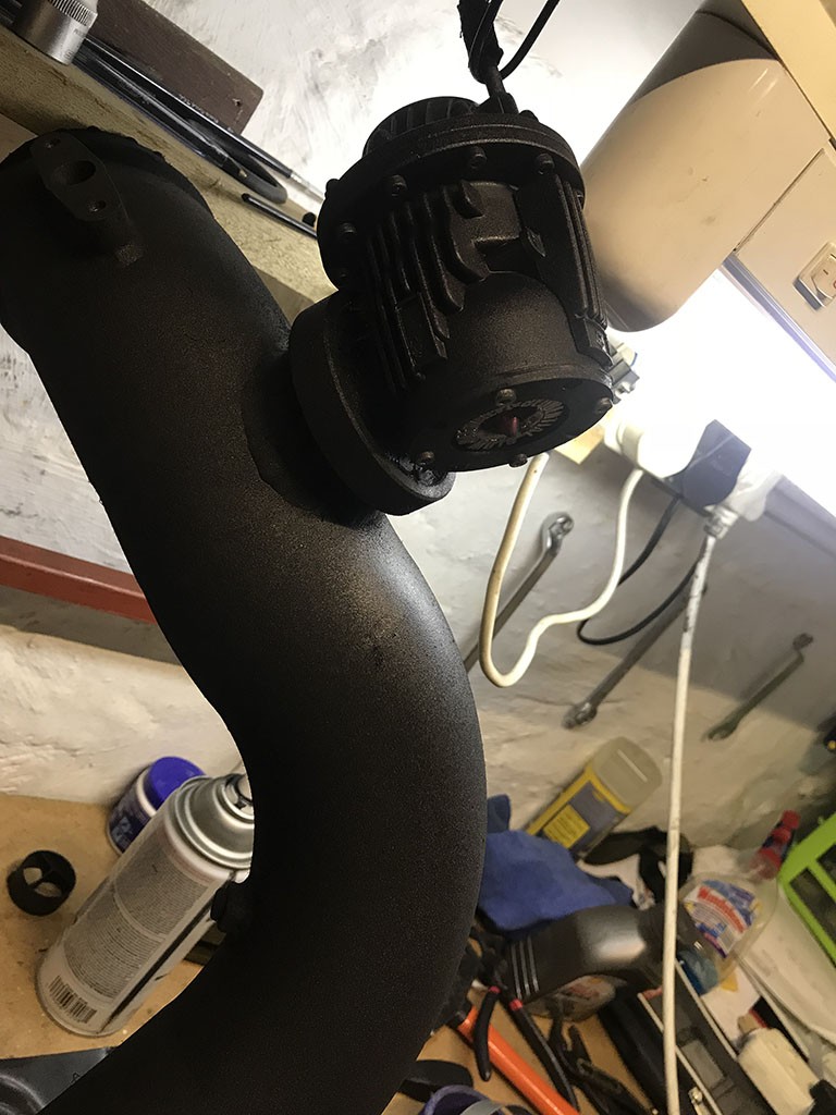

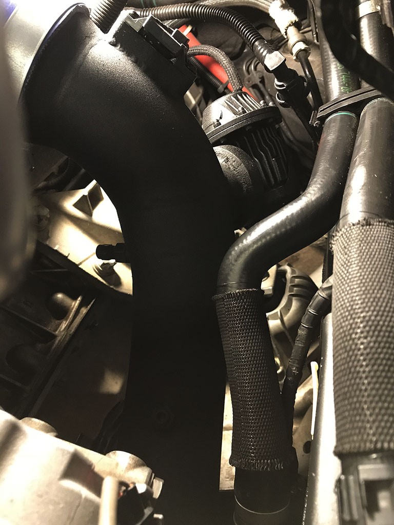

Anyways while trying to put the charge pipe back on at home I found that the blow off valve was completely loose. To the point of almost falling off! I hate the way this HKS BOV uses a circlip and not a proper clamp like every other BOV out there in the world! makes it a mission to take off and put on.

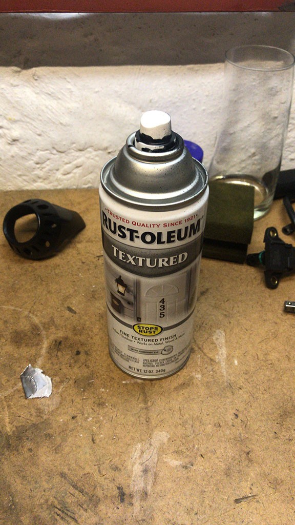

anyways I pulled the entire charge pipe out the car and decided to respray it and also sprayed the BOV while I was at it just because I love the look of this black textured paint so much!
This stuff is brilliant and it holds up very well! It only came off where the charge pipe got scraped against metal parts during fitment. Otherwise it doesn't flake or peel.
Clamps fitted correctly now with good spacing, silicon coupling pushed all the way over the throttle body and clamped.
I am actually going to get some black silicone couplings as I hate this blue s**t in my car! for now it will have to do!
fitted nicely and new vacuum line fitted too.

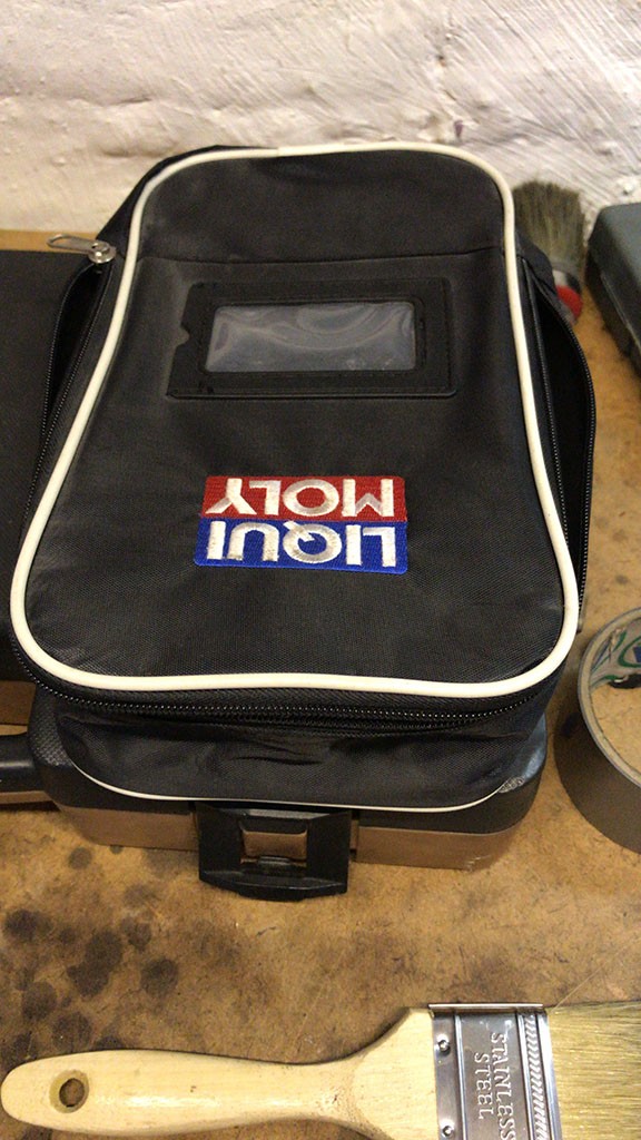

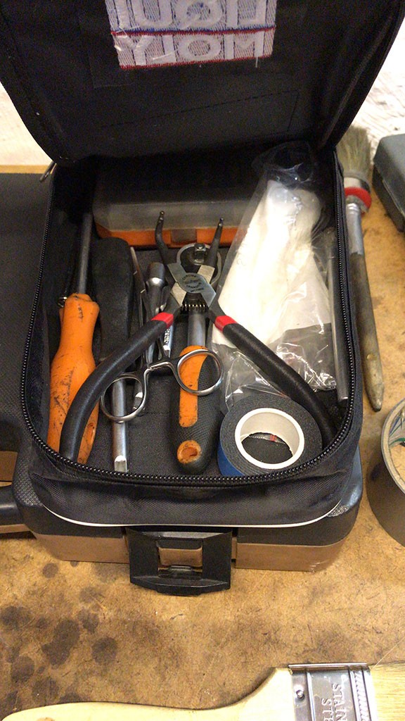

Now incase I ever run into this problem again and im on a long drive out somewhere I have put this nice little toolkit together for myself with everything I would need to remove and refit every part including the circlips pliers.
got the bag with some liqui Moly my dad bought for his Subaru forrester.
It is lined at the bottom with valcro strips so it sits in my boot nice and snug with my tire repair kit.

So today I opened her up a little here and there to see if it was boosting properly and if the charge pipe is now holding correctly. I can say for sure that the dump is MUCH louder which means that it must have had a boost leak from the BOV being so loose due to the circlip.
If this happens again I will need to go find some new circlips and see if that helps or as a last resort ill get a piece of pipe welded onto the BOV itself that I can then clamp to the charge pipe.
