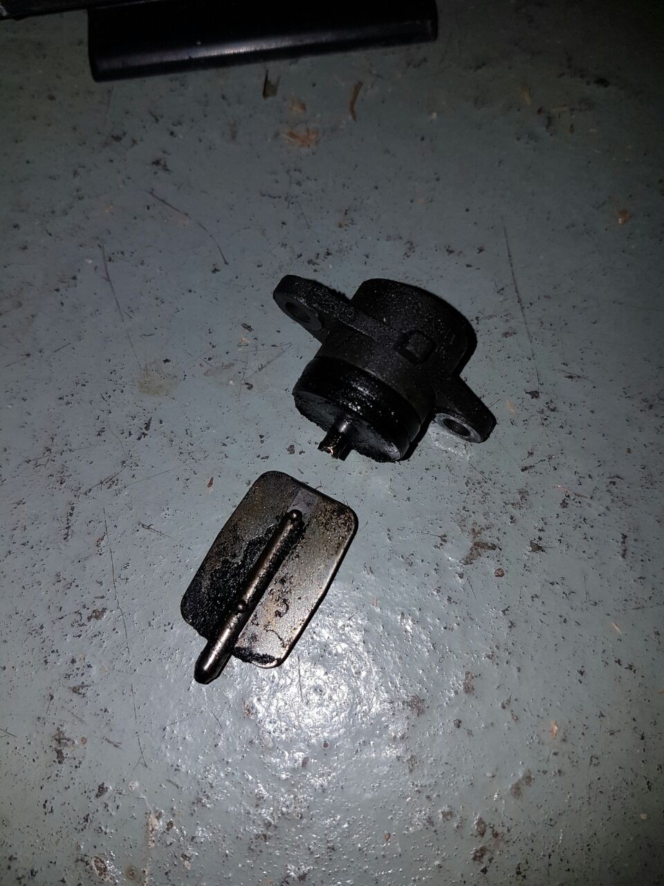

yup.. the shafts broke off where the screw goes through them... please guys, learn from my mistake of not removing them... remove those ticking time bombs!! a friend of mine's e90 320d actually also swallowed a swirl flap yesterday... not sure what year but pre LCI.
here is how mine broke off:

Normally it was told of the screws coming loose then falling into the cylinder. I'm hoping in your case because a big chunk broke that only a valve would have got damaged.

Yeah, thats also what I read, however the screws were still in the shaft but the shaft broke in two. Ill hopefully have the head off by tomorrow to see whats going on.

So we stuck a endoscope in the ports and cylinder to try and see how bad the damage is, due to not wanting to remove the head unnecessarily, however we could not really see too much, there wasn't any major damage visible and no sign of the flap. I took the intake manifold and shook it and out fell the missing swirl flap, all bent and mangled. No idea how it got back into the manifold.. but the sad part is the shaft and 2 screws of the flap is still missing...
