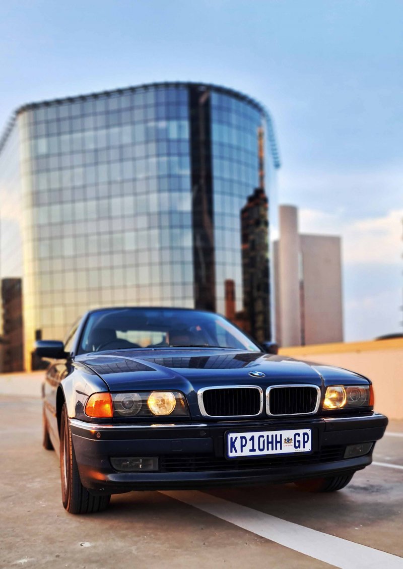

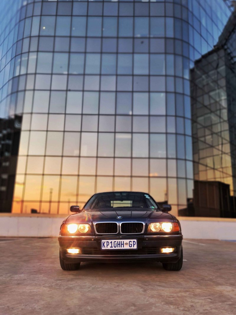

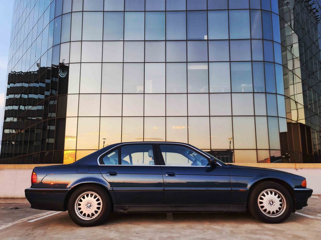

Hello everyone.
On Wednesday I picked up a very nice looking E38 740i with 172k on the clock. Pretty much 1 owner from new but has changed 2 owners since his passing 2 years ago and has not done much driving since.
It has a full service record, the last being Nov 2022 with a number of items done on the cooling system, however, the car is SO HOT! After a 20 min drive you cant touch the hood without oven mitts!
There are no errors on the dash and the cars engine temp is perfect on the instrument cluster.
