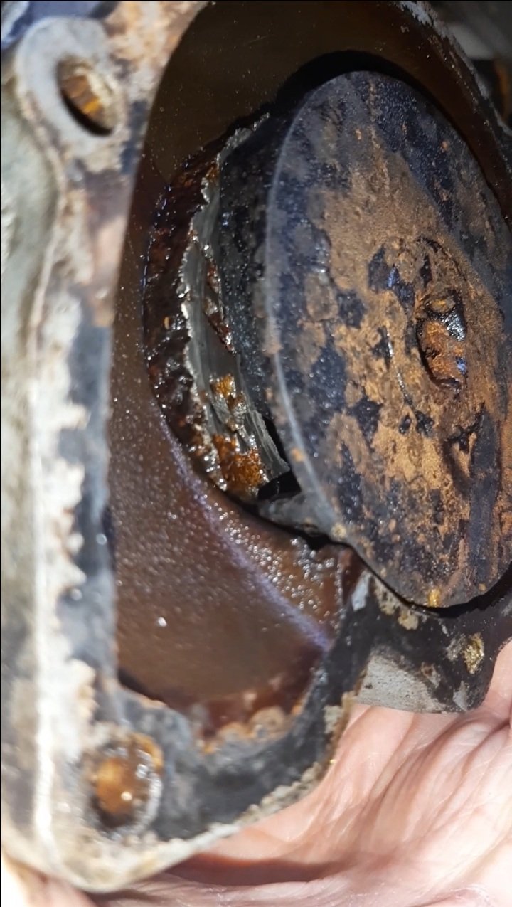

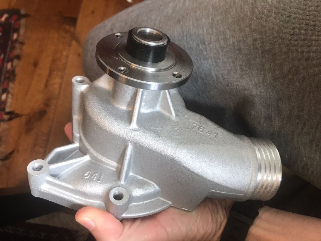

2.) After some major anxiety we were able to find and order a new water pump for the car as the old one was in terrible shape (so much vibration that the fan fouled with the shroud and broke) So, new pump, new fan and new shroud. We're sending the old pump to be re-conditioned, hopefully it's not too far gone.

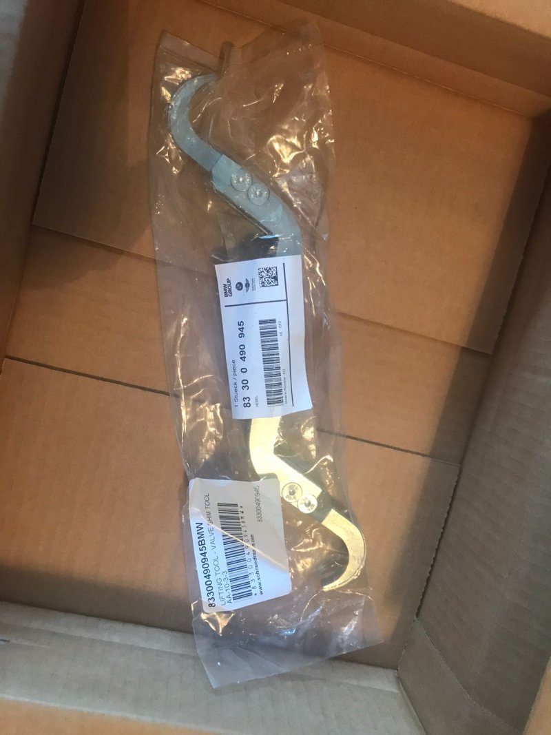

3.) I'm quite keen on doing the valve clearances on the s38 but you need a fancy tool to depress the buckets to extract and replace the shims. This tool you can no longer get from BMW themselves. Luckily, there are aftermarket companies that manufacture the tool, so we managed to order one from Schmiedmann in Denmark. So valve clearances are next on the to-do list along with changing out one of the rear speakers and a good detail. "Nearly there!" I say cautiously but optimistically. Enjoy the weekend.
New water pump:
The valve tool:
The old water pump:
