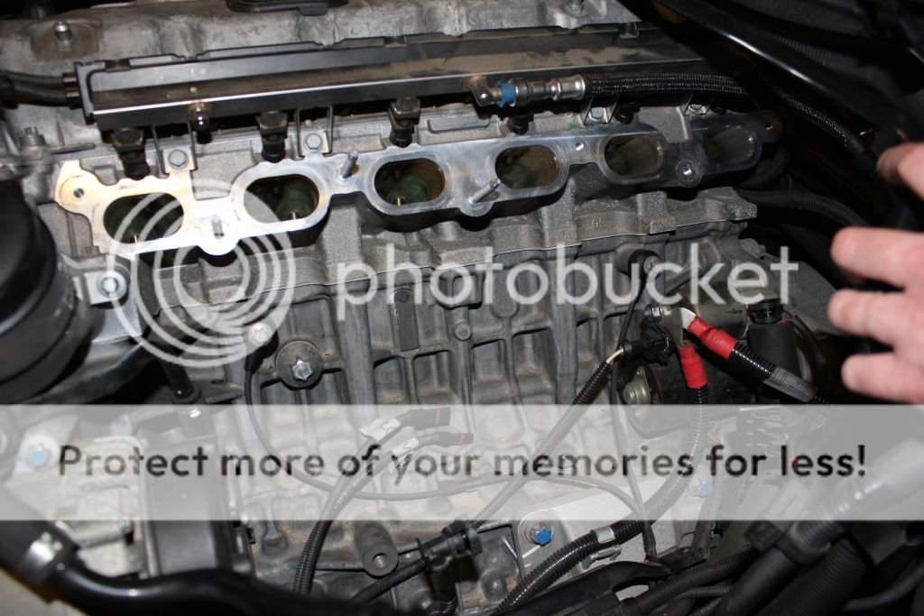

Using the right size and density the walnut shell is blasted into the intake track using a BMW Tool creating a clean surface whilst preventing any damage to sensitive engine components. The process is as follows:
1. Removal of inlet manifold following manufacturers procedures
2. Inspection of the valves and rear of the throttle body
3. Closing of the valves on the port to be worked on by crankshaft rotation
4. The carbon blast procedure is conducted whilst simultaneously vacuuming carbon deposits and walnut shell. This procedure is totally self contained and does not create further clean-up work in the engine bay.
5. Repeat for the rest of the ports
6. The inlet manifold is then replaced using new factory manufactured gaskets.

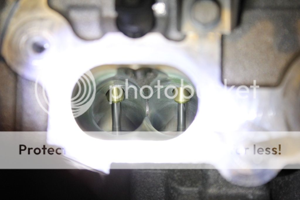

Clean and polished
