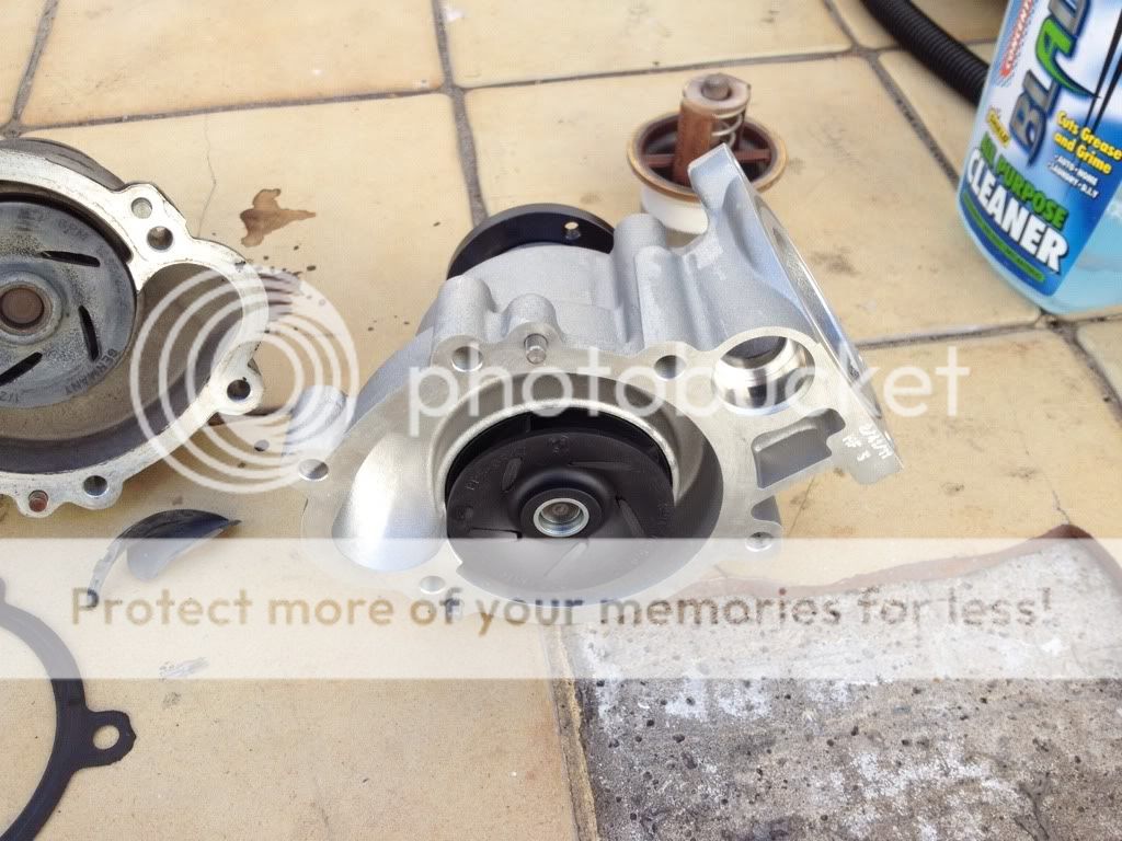

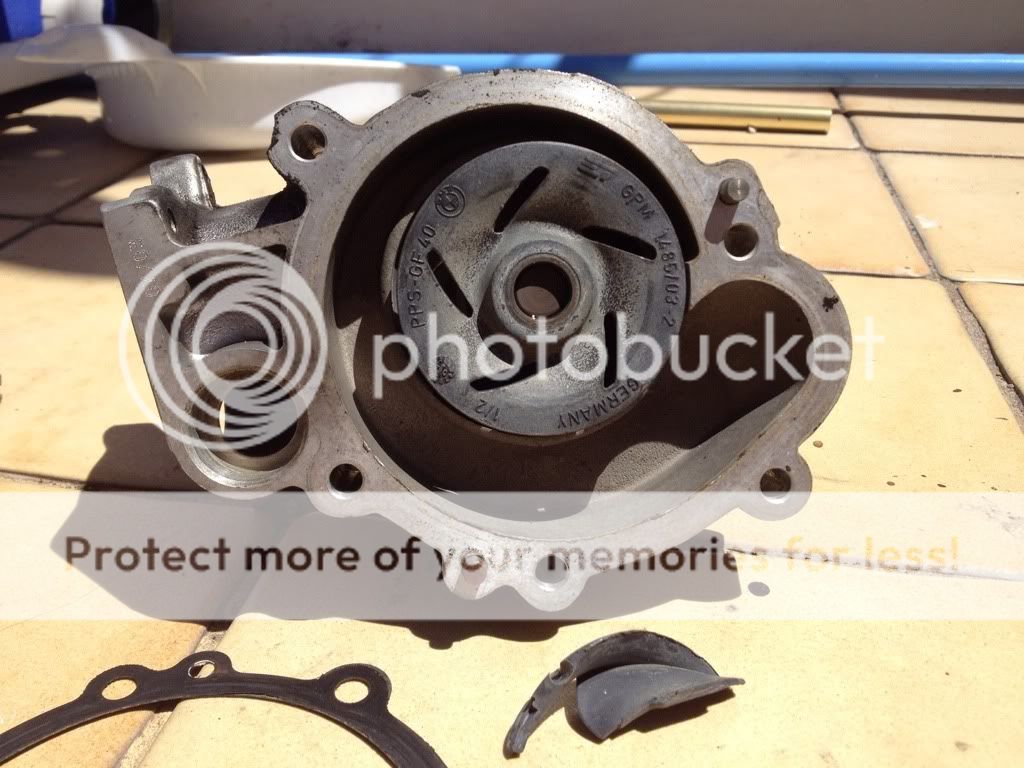

The culprit, disintegrated waterpump. The piece below is part of the impeller, it was destroyed
Shiney new OEM waterpump

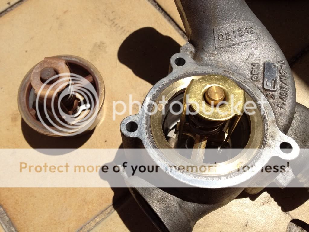

Old and new OEM thermostat

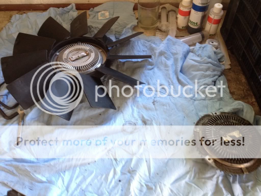

Old and new OEM fan clutch

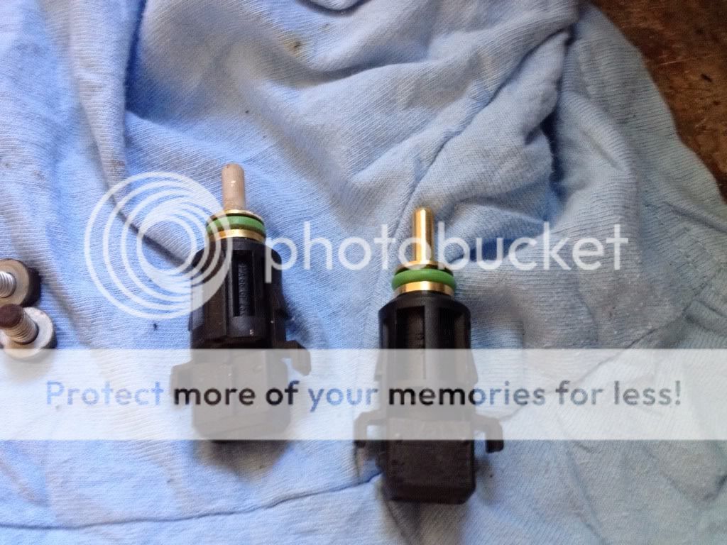

Old and new OEM water temp sensor

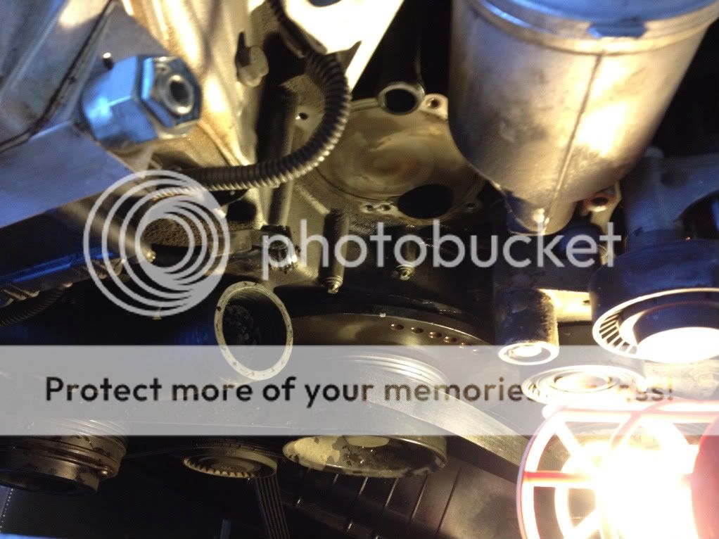

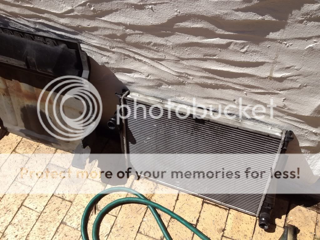

Radiator removed so I could give it a proper flush and clean
There used to be a waterpump there :)

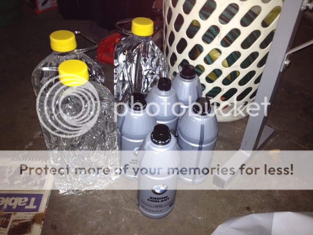

Coolant and distilled water

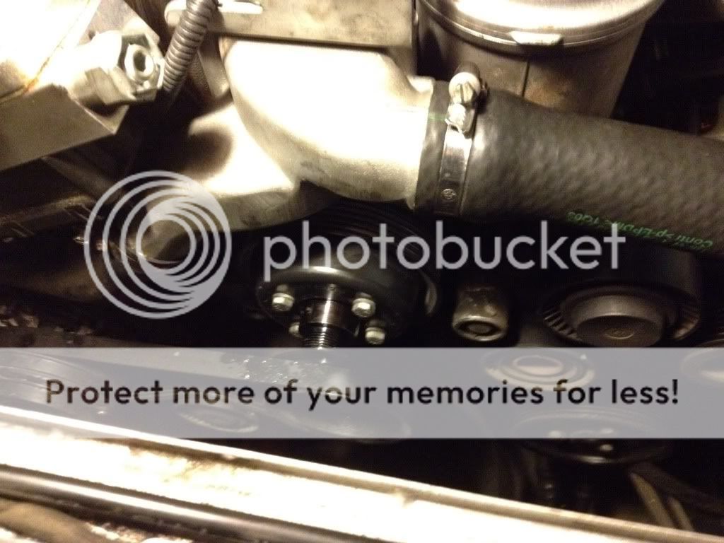

waterpump, thermostat and radiator reinstalled

Gizmo said:
How did the bearing on the water pump feel? play?
bad, like 2-3mm, easily moveable up and down.
compared to the new one it was night and day

Noob question here.
Why distilled water?
distilled water is "free" of impurities. They basically boil the water, and condense the steam
