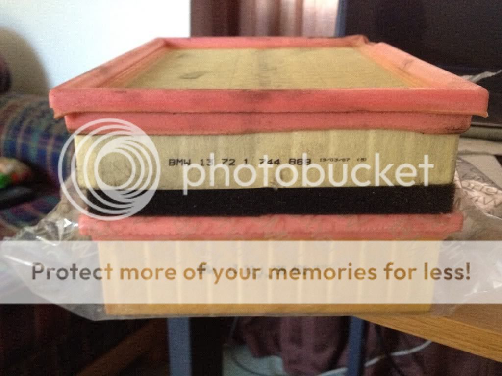

releasing 2 clips and removing the old filter element is hard enough, but the real tough job is removing the new filter from the plastic wrapping.

does the old filter have foam?
yes it does, on the dirty/underside, not sure why. looked on m3forum, and all the pics have without.

And to those wondering the filter in the M3 is exactly the same one that is used in the entire e46 range, everything from the 318i to the M3 uses this filter, so if it good enough for the monster of an engine in the M3 I doubt it will be holding your non-M e46 back too much.
The air filter that I took out of my car when I serviced it the first time also had the foam and the new one didn't.

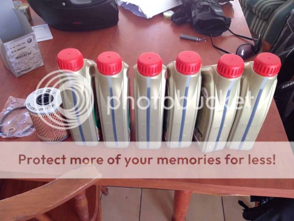

Oil Service:
6 Litres Castrol TWS - R1377 from zeemax
Oil filter kit - 11 42 7 833 769 - R150
Did this today, super easy to do, really no need to pay someone to change your oil
Took about me about 3 hours to do, but that included 2 hours between me removing the sump plug and old filter, and reinstalling.
No point in posting all the steps I did, I just followed this DIY: http://m3.madrussian.net/diy_oil_change.shtml :)

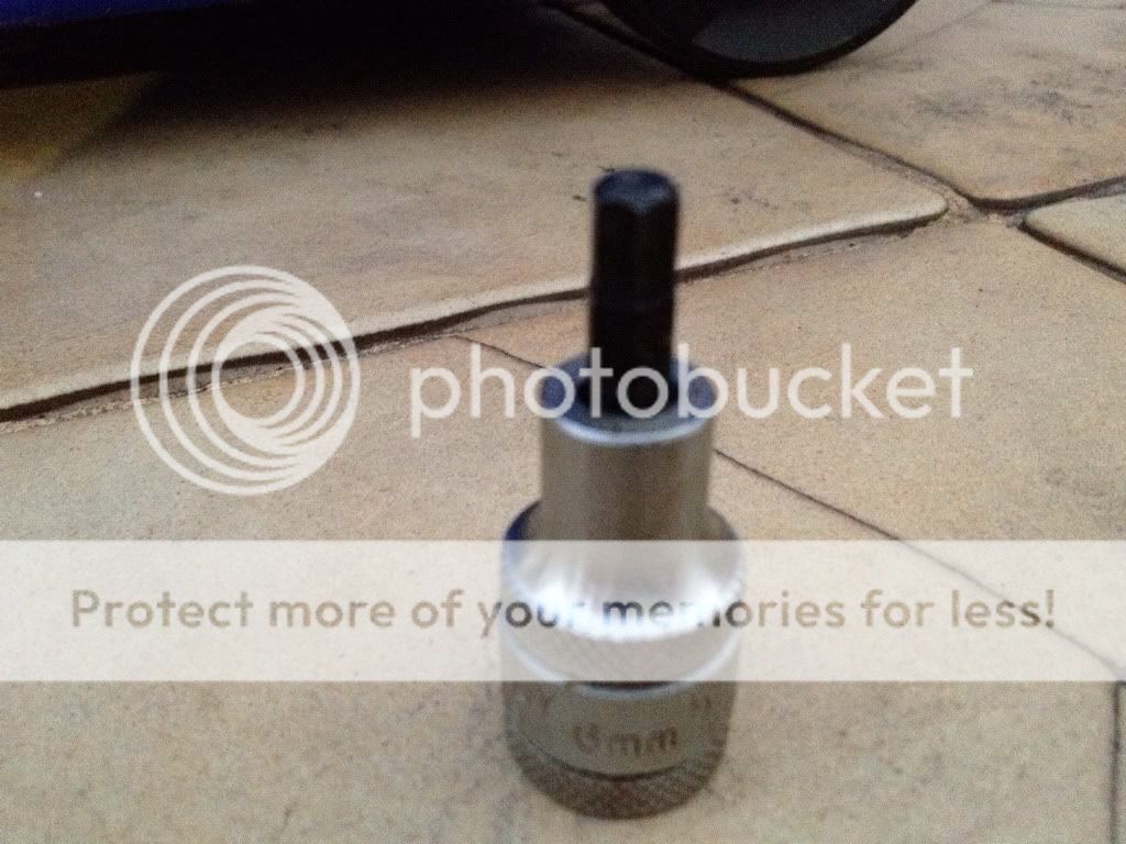

1 thing, do not attempt to do this if you do not have a 6mm hex 3/4" socket. An allen key just wont work, you might strip the sump bolt, and then you wont be able to torque it to spec.
Difficulty: 3/10
All the sundries needed, 6litres tws and 1 oem oil filter kit

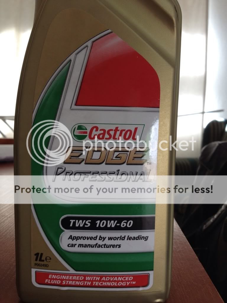

This is what the Castrol Edge looks like that you are allowed to put in your S54. DO NOT use Castrol Edge Sport 10W60!!
6mm hex 3/4" socket

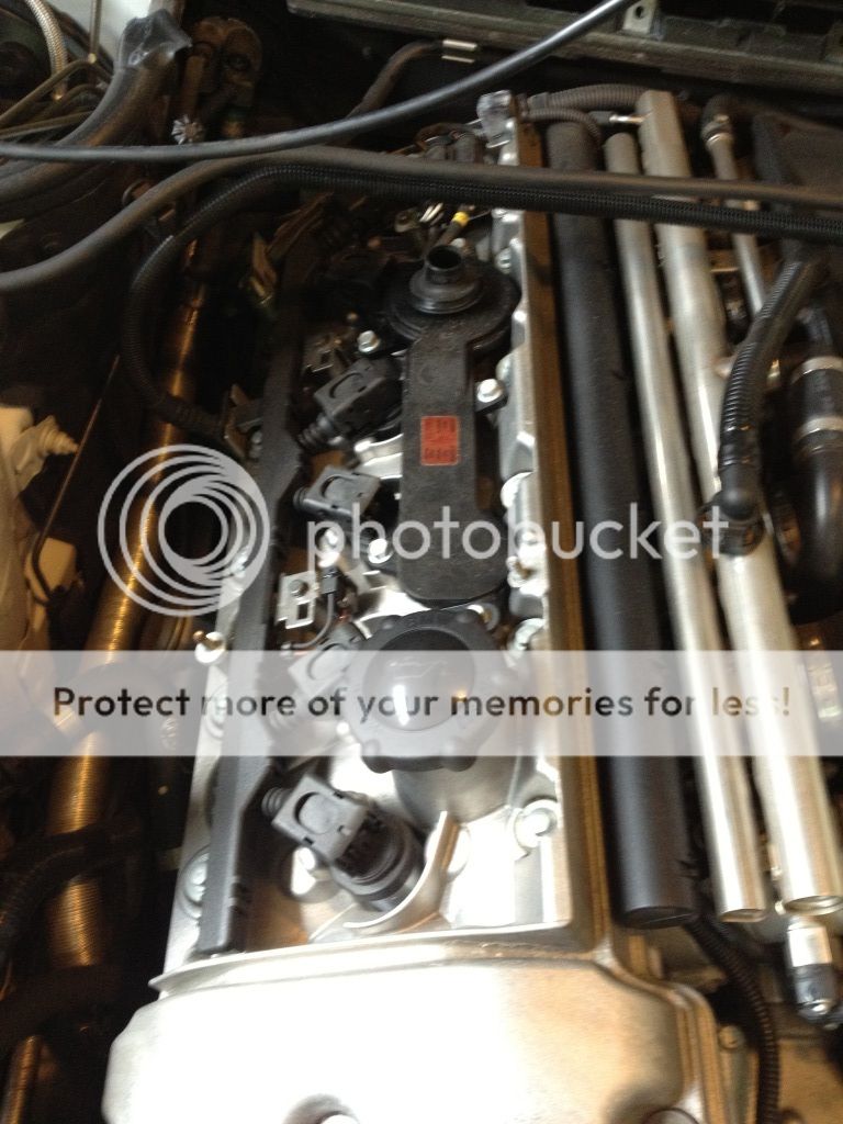

Spark plugs:
for some reason, I forgot to do this :fencelook:
6x OEM Packaged NGK DCPR8EKP Spark Plugs -121 200 229 02 - R1360
Total time: +- 1.5 hours.
Difficulty: 3/10

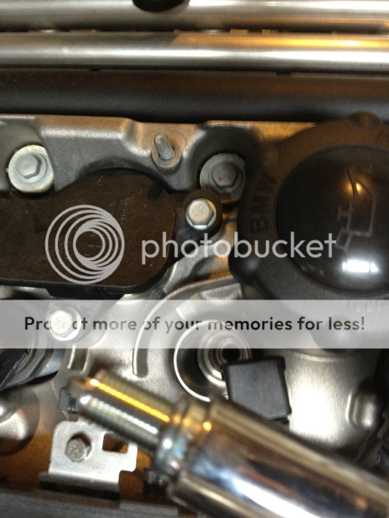

More fiddly than difficult, made even worse by the fact that BMW dealers clearly dont give a shit and use the correct tools, as the previous plugs were way over "torqued"
No 5 & 6 are the worst, there is really little space to get leverage.
I pity the V12 DIYer :)

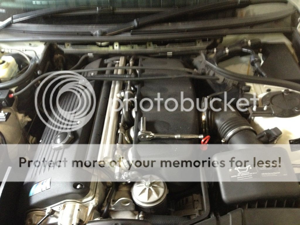

Some useless pics :)

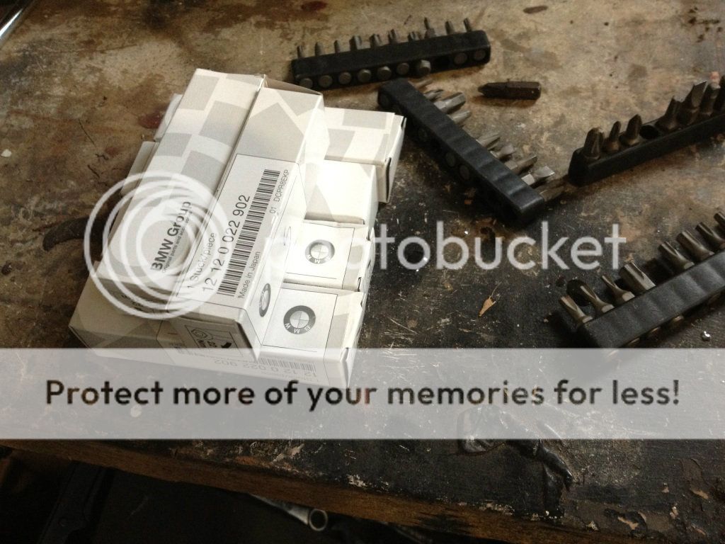

6 of the best
strut bar and microfilter housing removed

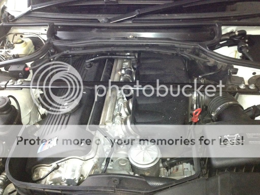

engine cover removed
clean "channels" no oil leaks, etc

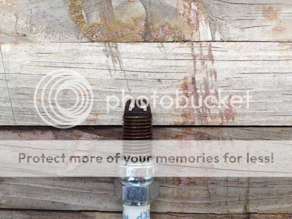

state of old plugs. pretty much consistent for all 6. not too sure what you can read from these, but they look OK
all back together
