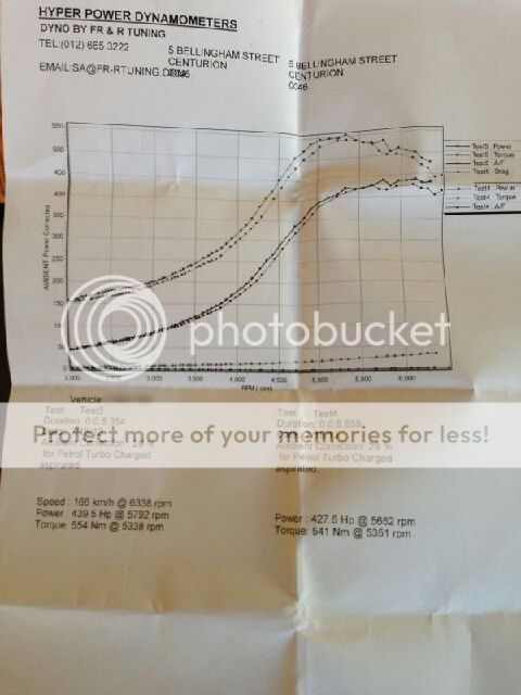

439hp at FRnR
Stock cooler, stock injectors, stock internals. Base map.

After some fine tuning after Drag Wars, the following results were obtained:
439 whp
554 Nm
This setup has a lot more room for improvement with the boost set at only 1.6 bar, which is just starting to get into the X54's real efficiency range. With an upgraded fuel system and DSG clutches, we should have no problem achieving 500whp +
