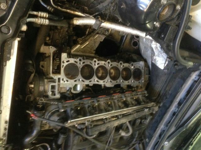

Just an update, I decided to go ahead and do the rebuild, imo now, oil on ur spark plugs and oil usage of 0.5l every two weeks and a cloud of black smoke after a few revs is definitely your rings, and a sloppy head recon. So exhaust guides, valve stem seals and rings had to be redone. Head was skimmed. With the head off, I could see that the rings needed to be redone.

How were you able to determine the rings were toast by removing the head? You would need to remove the pistons to do that.

Just on what you have said here indicates that compression would not have been ok.
Guides being worn means that compression will be low.
It also means that the car will smoke and burn oil.
Unless the bores were marked you cannot see whether rings need replacement given that your combustion chambers would have been full of burnt oil from the worn guides.
Was the block honed before new rings were installed and if it was honed what size rings were used.
ichigo
Yeah block was honed, not sure on the size, it was not done by me personally, I went to visit the mechanic many a times as it took 7 weeks, so everytime he explained what stage he was at and what he discovered as he took it apart.
One day I was there the head was off and he had seated the new rings and showed me where it was honed and then said the old rings were paper thin.
My point I'm trying to make is that the previous owner/mechanic said he spent 12 to 13k on the head and replaced all the guides and valves. And if he did that, the head would of had to send it in and the block would be exposed as I saw it, so he would of seen or if he cared he would have examined the block and determined the rings needed to be done.
But I'm over it now, I'm just glad I found someone I can trust and who could get it sorted out.

This is how I saw it that day. What am I missing or maybe I have my parts mixed up? >.< Its not my actual car, just a pic off Google.
