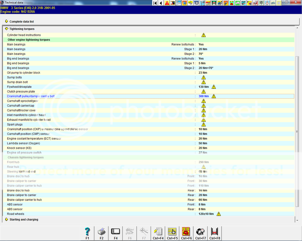

Hi there i know someone probably asked the question already but im in real need as i have to get the engine up and running before monday. I need the torque settings for the main and big end bearings can anyone please assist :hammerhead:
Thanks alot

ballisticz466
Might be to late for this. Autodata snapshot for you.
I hope it helps.
BladeHunter
I hope it helps.
Thanks for the upload it was a bit late but thank you. Where can i buy autodata the one you used for the snapshot?
