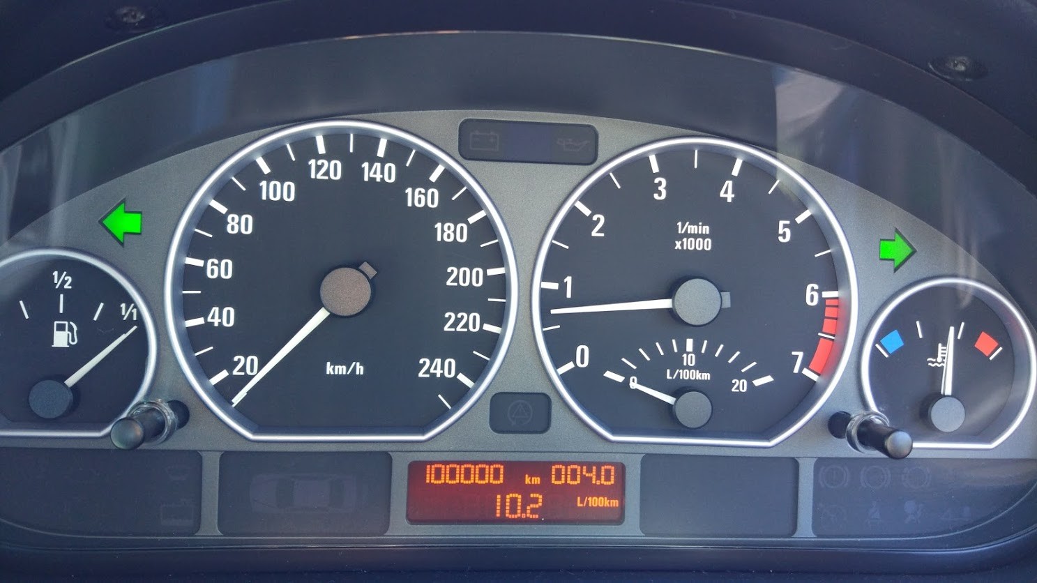

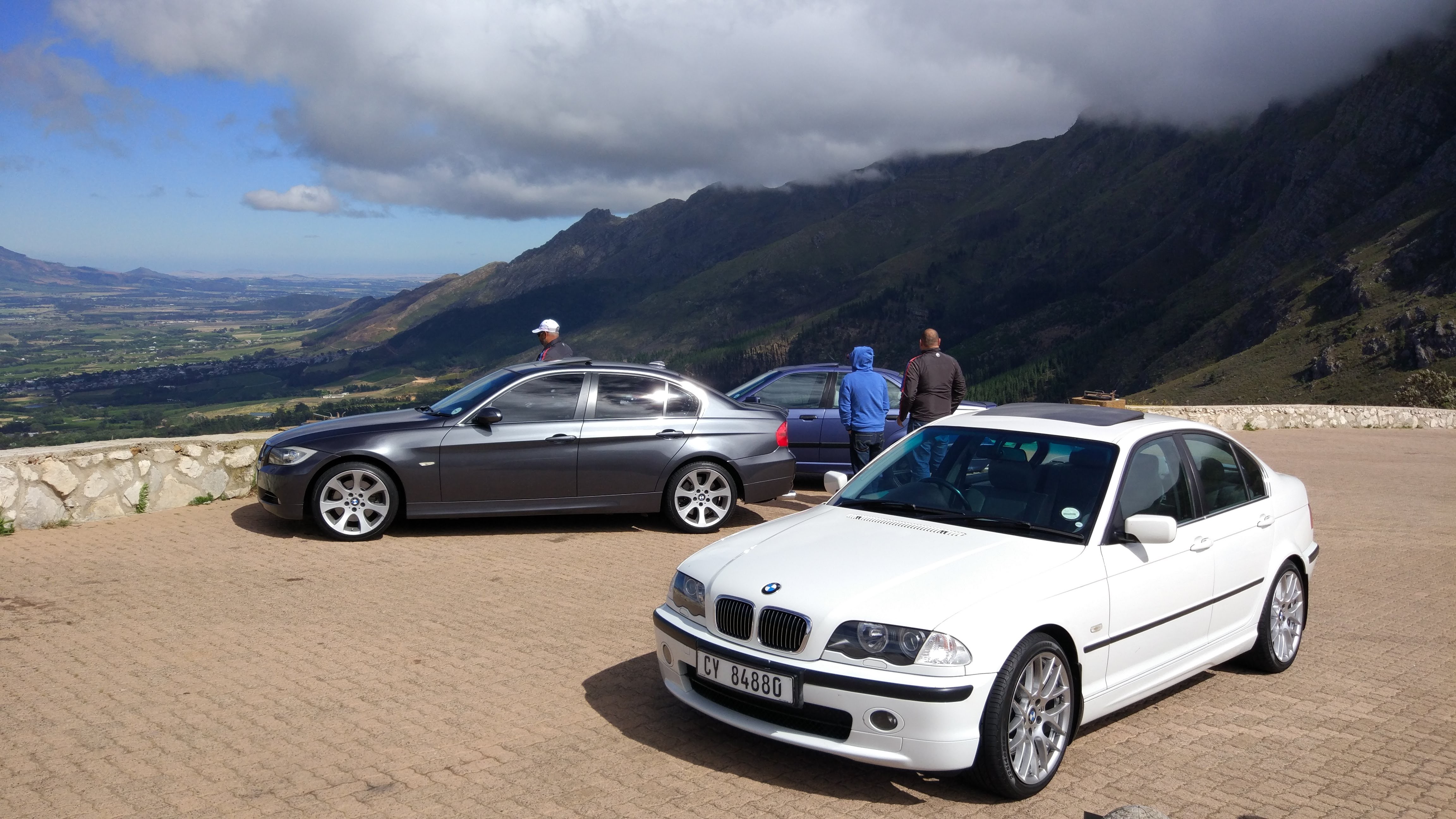

Car reached it's first big milestone in September 2017 when me and the wife went on a road trip to the Franschhoek Uncorked festival. Was a beautiful time of the year driving through the town and also enjoying the 330i at the same time. Apart from the long trip down from Durban, this was probably the longest trip since buying the car.
Just before:
Switchover: (note, the emergency lights are on which is why both arrows green)

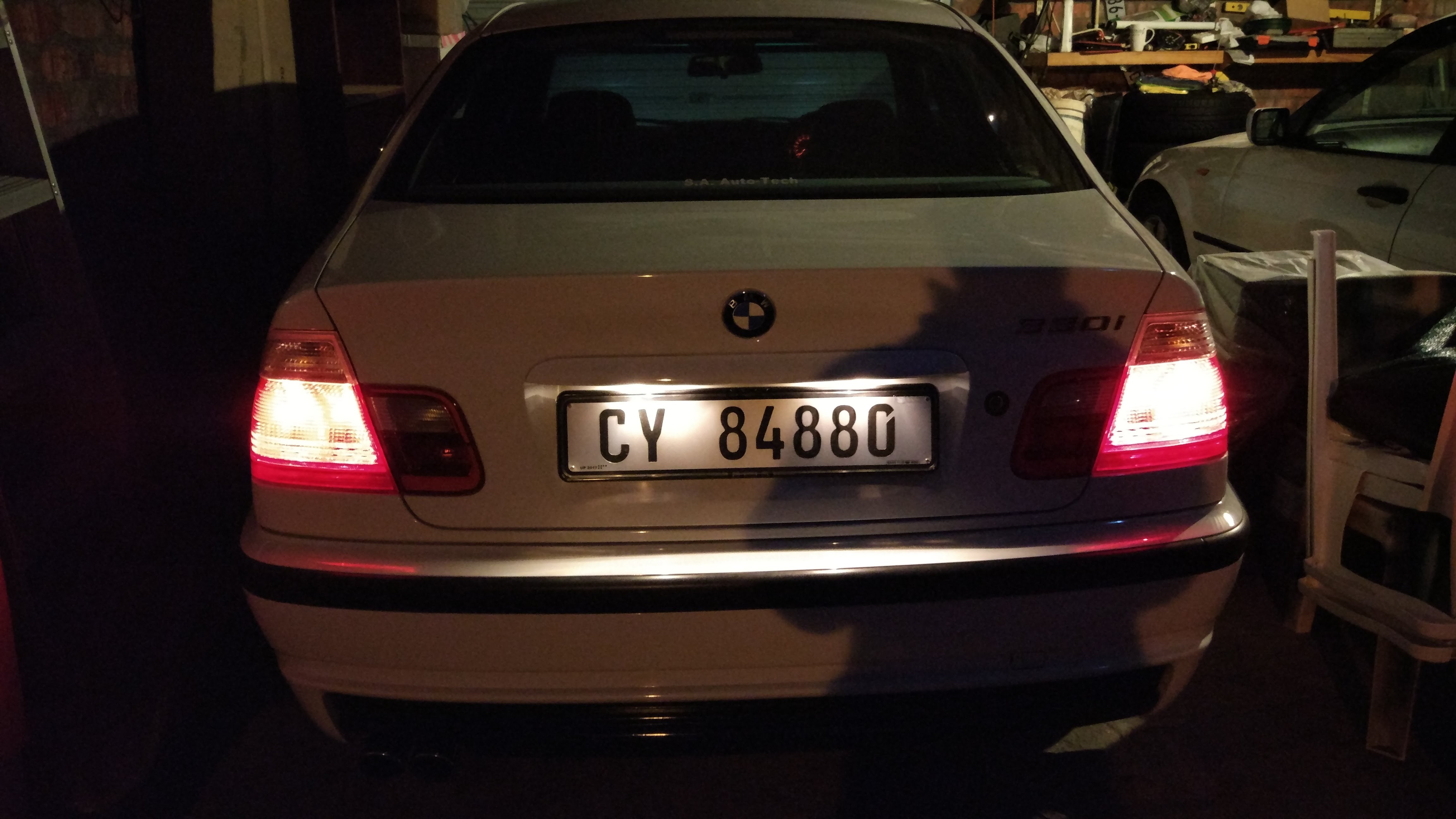

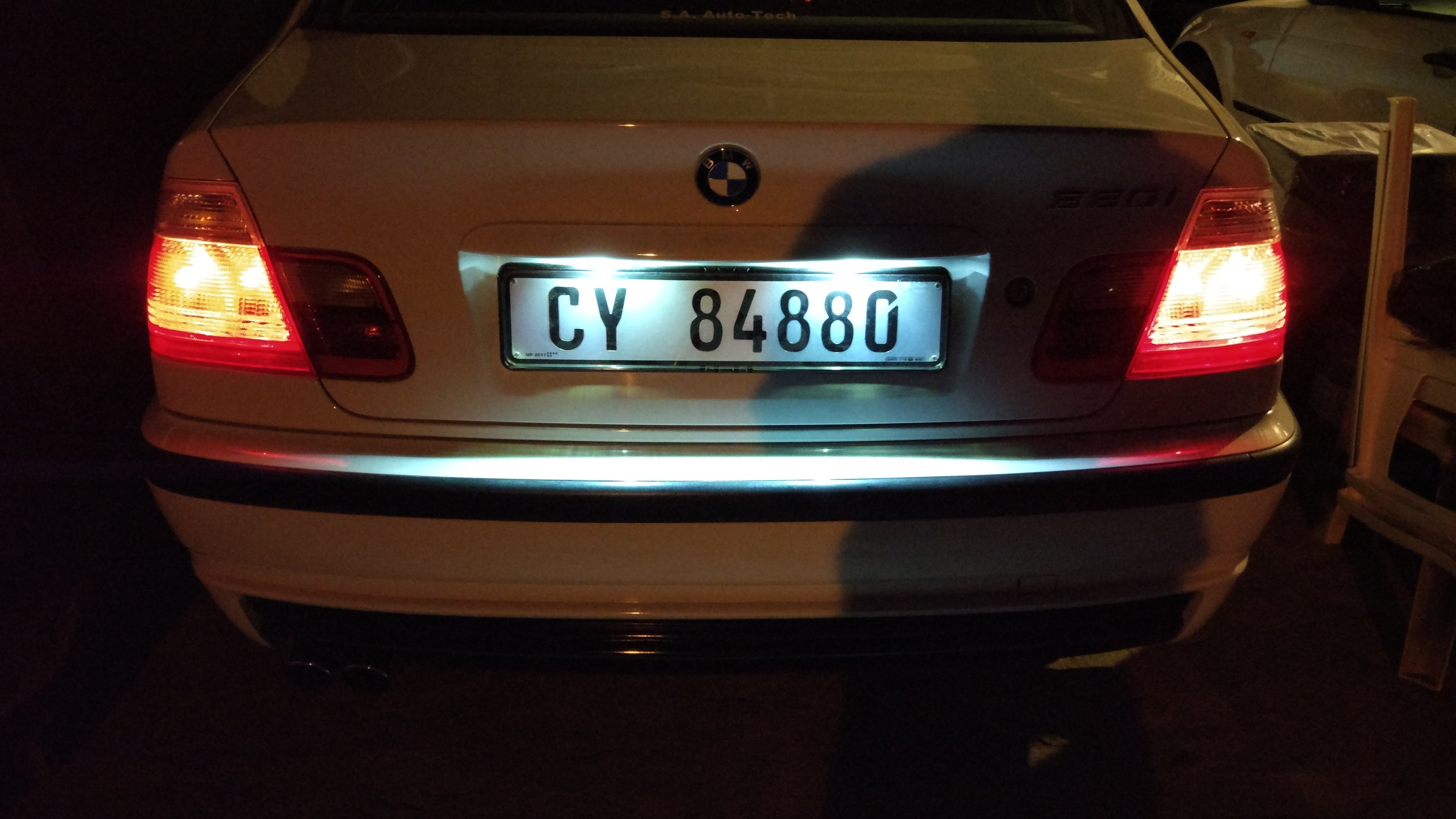

Then I made a minor change, by changing the rear number plate lights to LED versions. The new cold white light look fit with the rest of the lights on the car, where the front lights are cold white being xenon, but also the spots are cold white.
Before:
After:

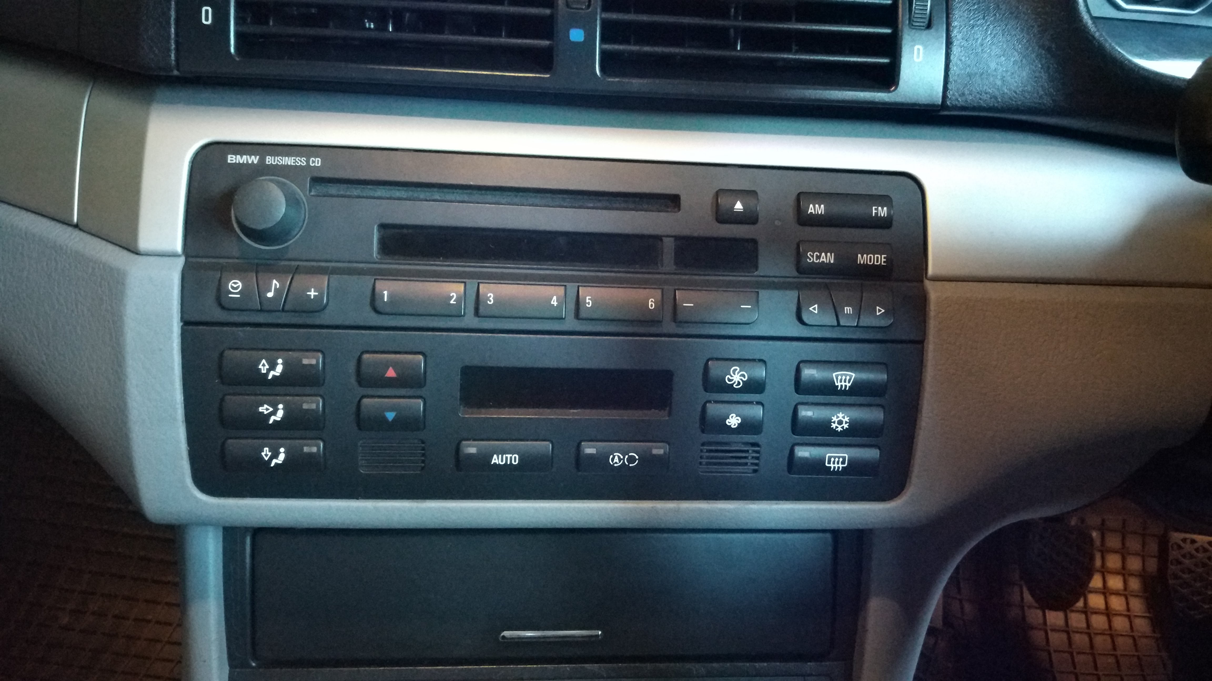

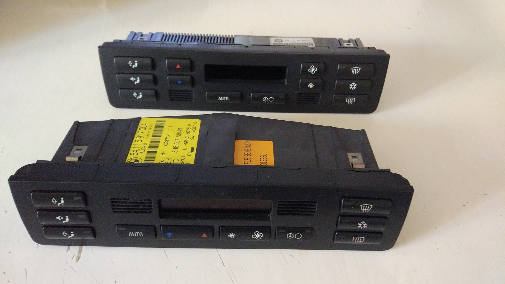

Then early December I changed the radio and the climate control panel in the car. The issues I had was this:
- Radio -> Volume knob was worn. Tried to replace it with one from another cd front loader here that I took out of the 318 which had 1 channel blown. Eventually I couldn't get the knob off the tape radio, but seeing as both were philips, looked the same, I ended up moving the amp board from the tape radio on to the cd frontloader and added that to the car.
- Climate control -> When reading errors, there was an error about the left footwell flap motor. Reading up said it is rare that this happen. When I replaced the IHKA unit, to a newer one, the errors changed, but those I cleared by coding the module to my vehicle, as it seemed to have come out of a diesel E46.

Climate Control Units:
After the fact:
