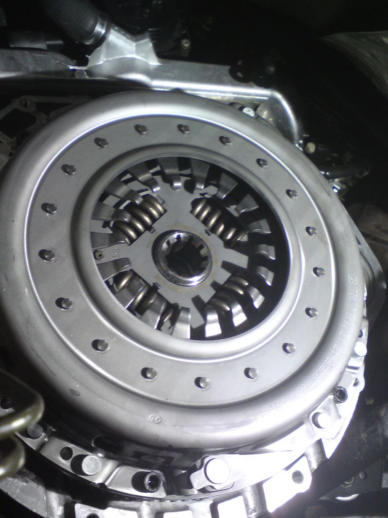

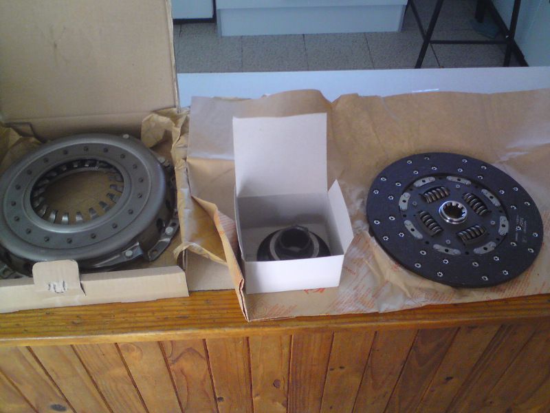

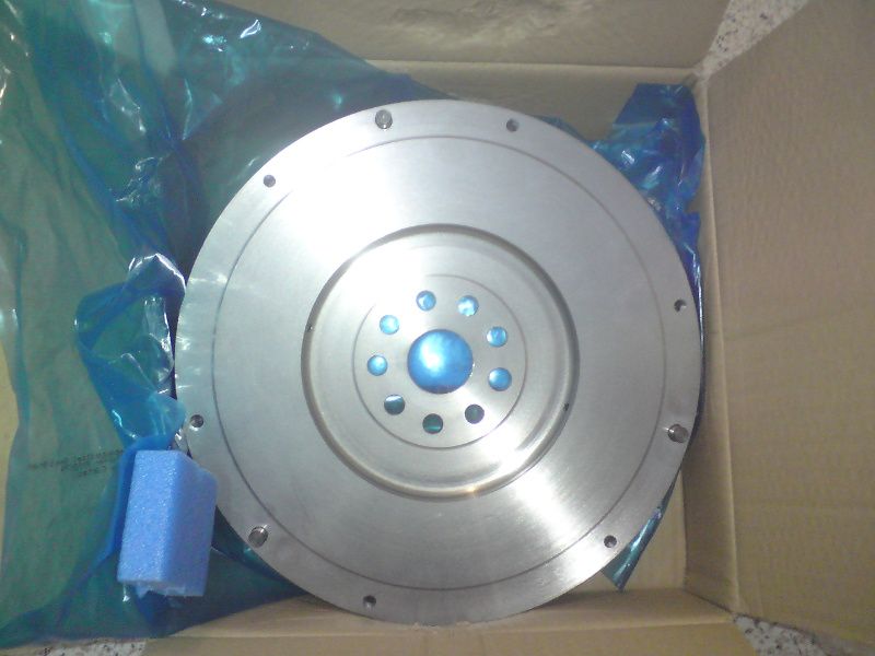

This "upgrade" was one of the fruits of our (I say our because I was at least not alone im my searching) many searches I found that the clutch used on the 850CSi is in a lot of ways very similar to the what is on the 540i6....with two very distinct differences, it uses a single mass flywheel and the clutch is one of the biggest known to man, at an astonishing 280mm (there are actually a lot of clutches bigger, it just sounds more dramatic this way)
So on to some pics:
The new clutch and flywheel:

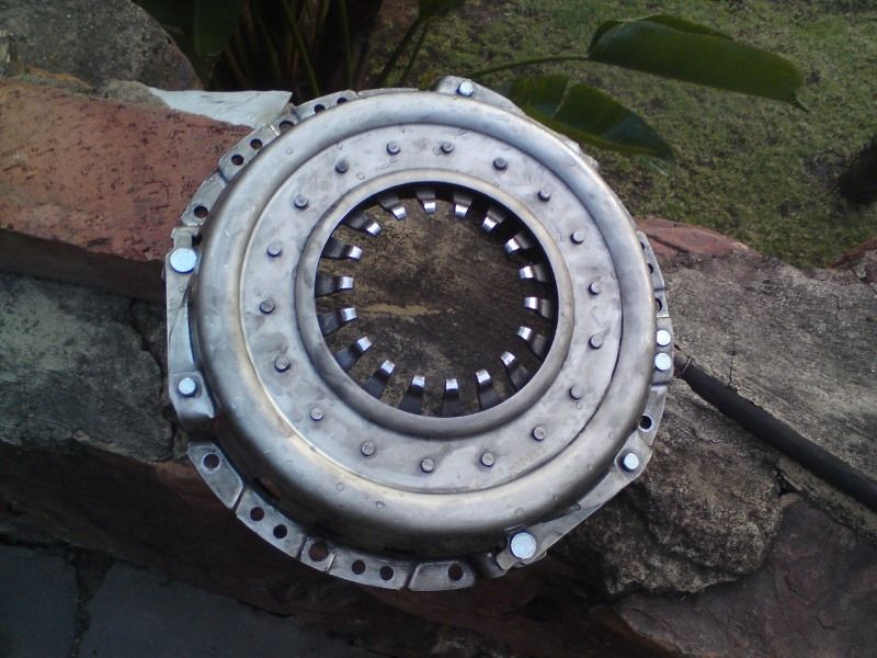

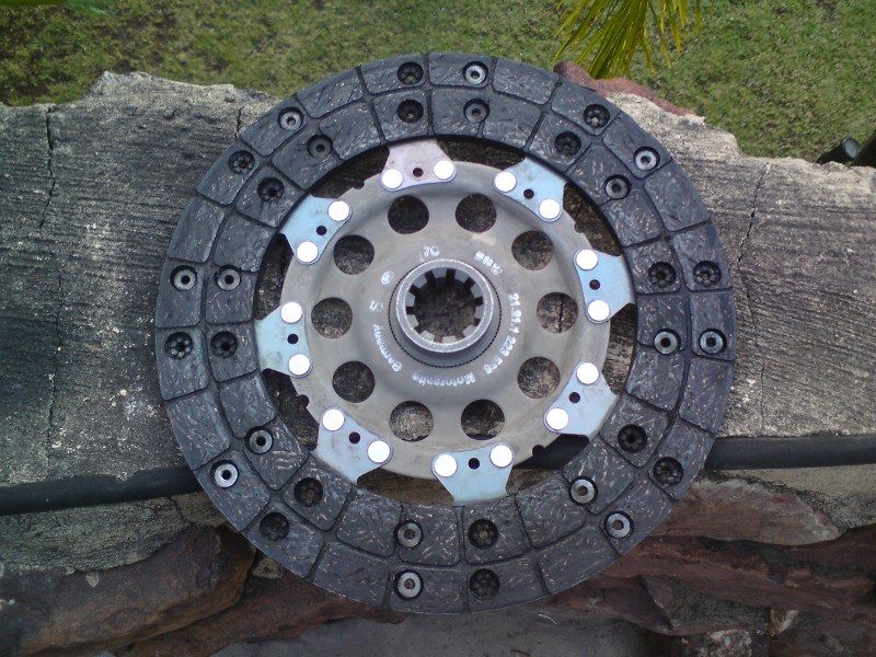

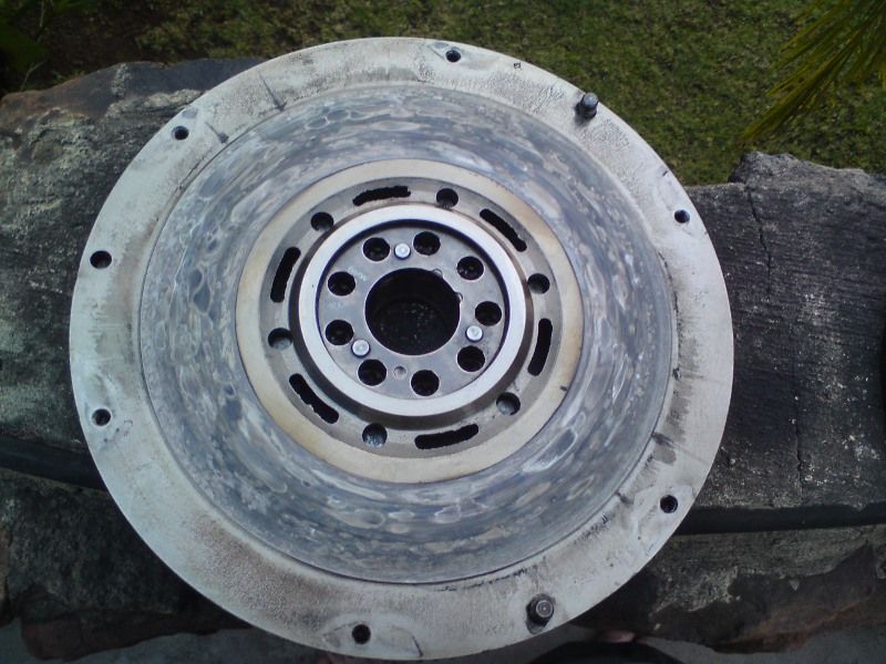

The old clutch and flywheel:

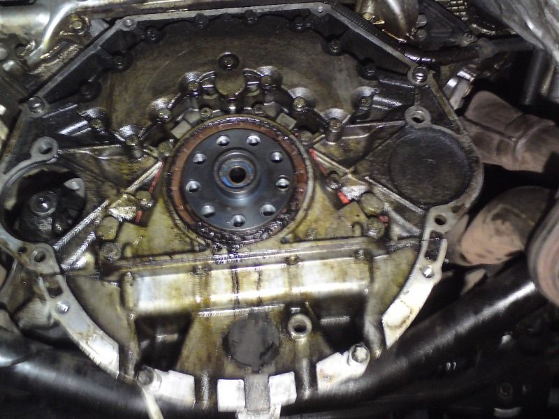

The clutch was actually not that badly worn but it was slipping due to oil contamination. The leaky rear main seal had made quite a mess of the back of the motor:

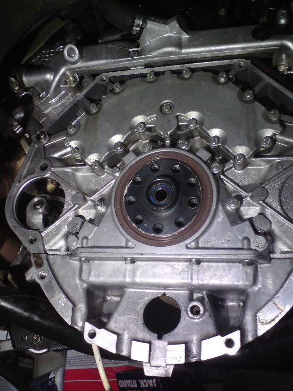

So cleaned off and a fresh rear main seal fitted:
New clutch fitted:

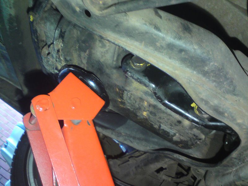

So I also fitted a 3.15 LS diff:

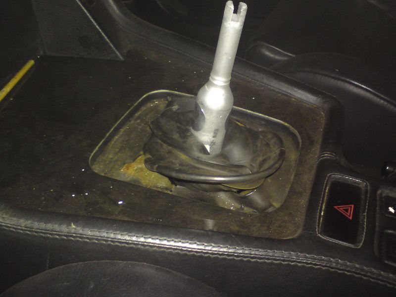

Fitted a e60 545i SS with all new shifter bushes and rubbers:

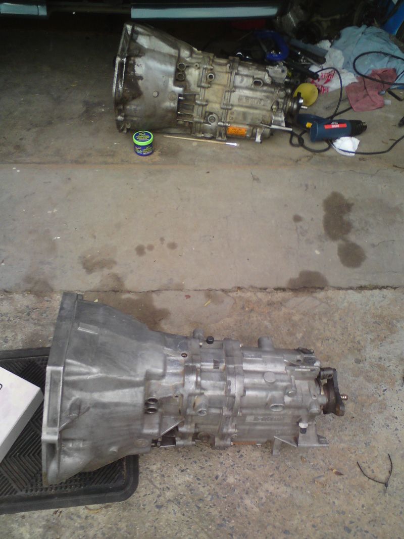

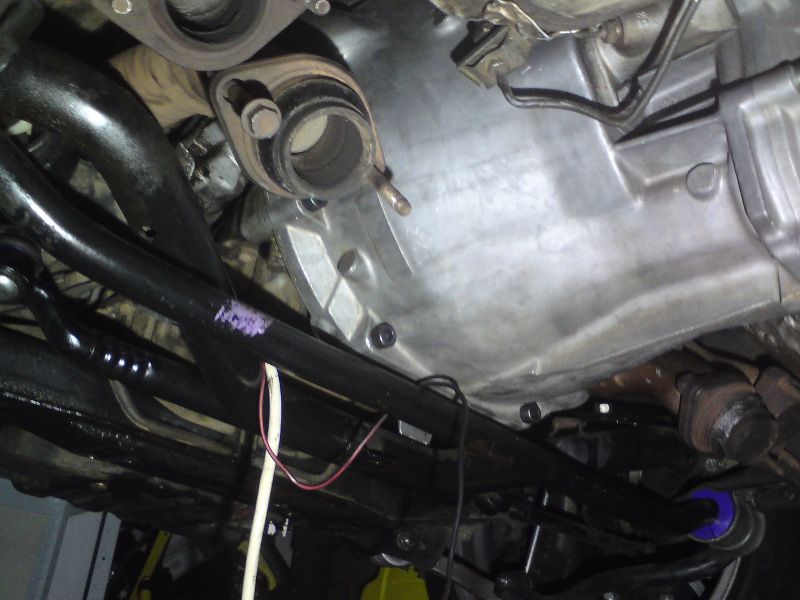

And also replaced the gearbox with another one that I just "happen to have laying around":
