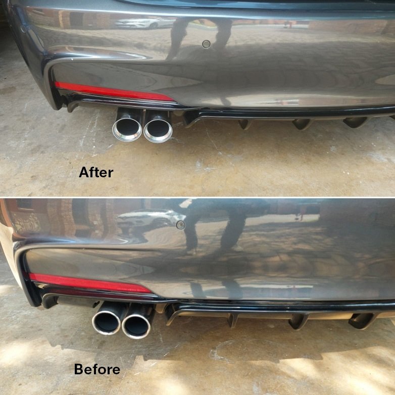

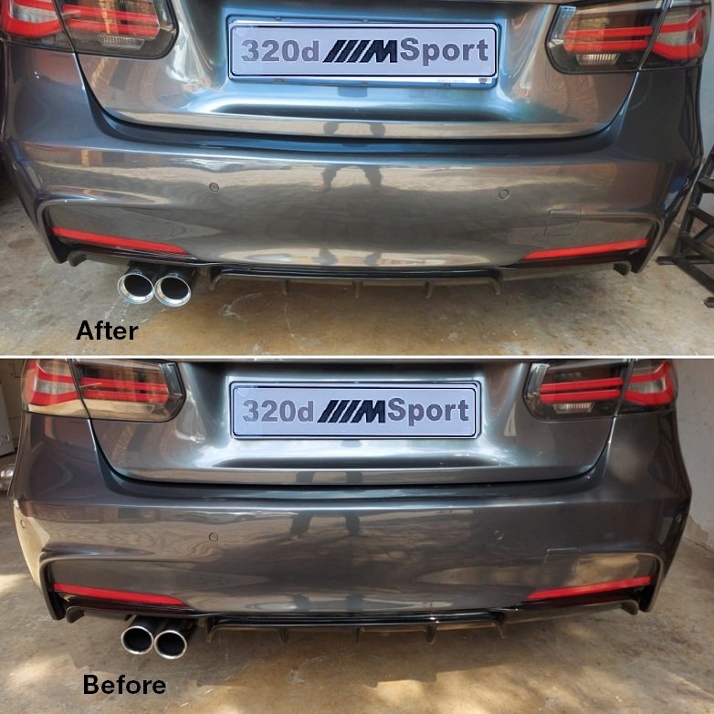

Shucks, car looks mint! Still need to get the side skirt extensions for mine.I finally got round to the detail I've been planning. Took much advice from forum members here - you know who you are

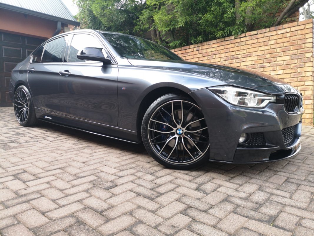

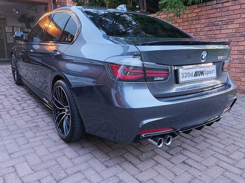

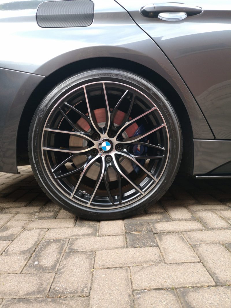

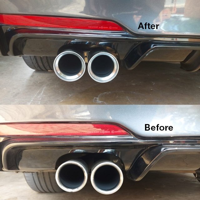

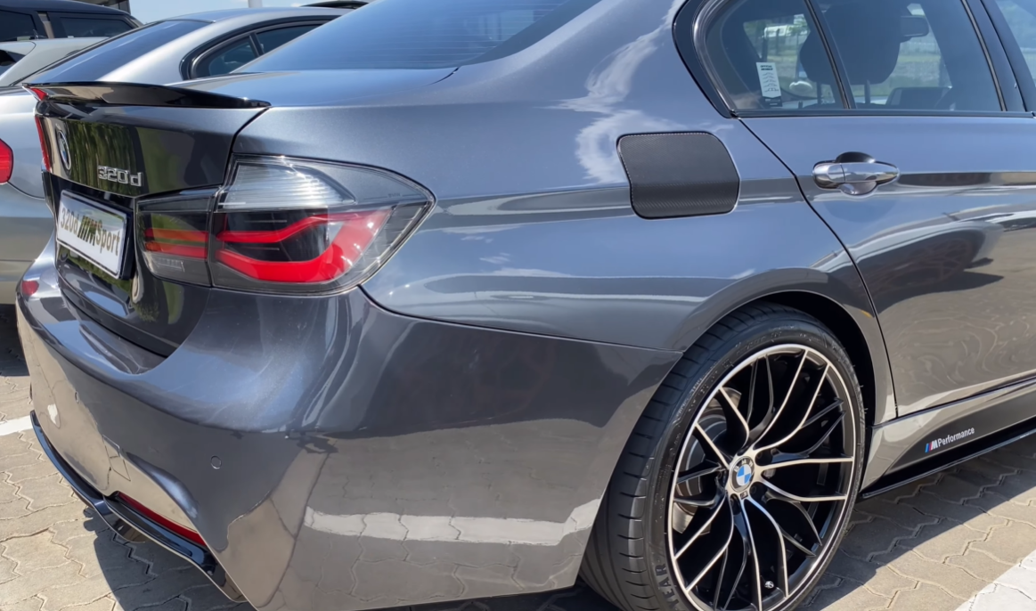

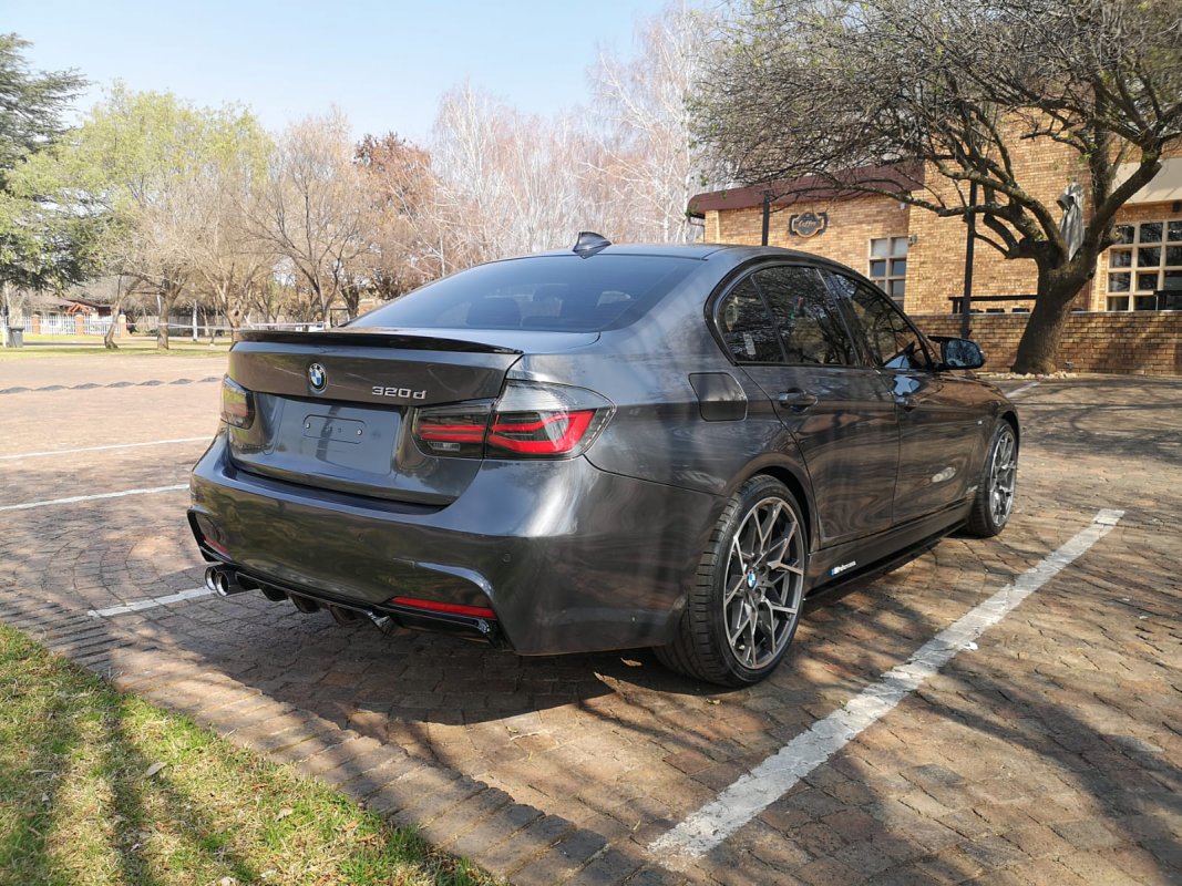

I spent 9 hours on the Friday, another 1.5 hours on the Saturday and another 2 hours on the Sunday. The method is broken down below for reference in case anyone is interested:
Friday activities
Foam wash with Clean Green and rinse
Snow foam wash with Carchem Snow Foam and rinse
Shampoo wash with Clean Green and rinse
Decontamination wash with DNA-e Iron Extreme and rinse
Clay bar (Shield) using Clean Green as a lubricant
Shampoo wash with Carchem Shampoo and rinse
Dry the car
Polish using Menzerna Medium Cut Polish 2400 - I bought a Tork Craft Random Orbital Polisher machine. Its nothing pro but better than by hand. I used a Waxedshine medium pad.
Wax and buff using Collinite Liquid Insulator Wax 845 - this was the first coat. I let this coat cure for about 15 hours.
Saturday Activities
Rinse and dry
Wax and buff - 24 hour cure
Sunday activities
Sealant with Waxedshine Aquabead - super easy to apply - you literally spray a mist on to a panel at a time while still wet, count to 10 and rinse off - that is it. I know this is a sacrificial layer as it won't bond well with the wax, but hoping it will provide some protection to the wax and allow the wax coating to last a little longer. I am applying it with each wash as a top up. Will see how it goes but thus far the results are good, shine and beading is there.
Lessons learnt - firstly its a lot of work - although I really enjoy the DIY so that is OK for me but be aware. It was something I've wanted to do and now I've done it. Products (Shampoo, Snow Foam and tyre dressing I had, I bought the clay bar kit + Iron Extreme + Wax + Sealant + foam applicator pads) plus the polisher and pads (smaller backing plate + 2 cutting pads) cost me R3300. The polisher is a once off and some of the products are multiple use products - especially the wax will last a long time. Next lesson, I could have spent more time on the polishing, but being my first time I did not want to go to hard and make a mess of it. Overall, very happy with the results.
View attachment 6459 View attachment 6461View attachment 6463
