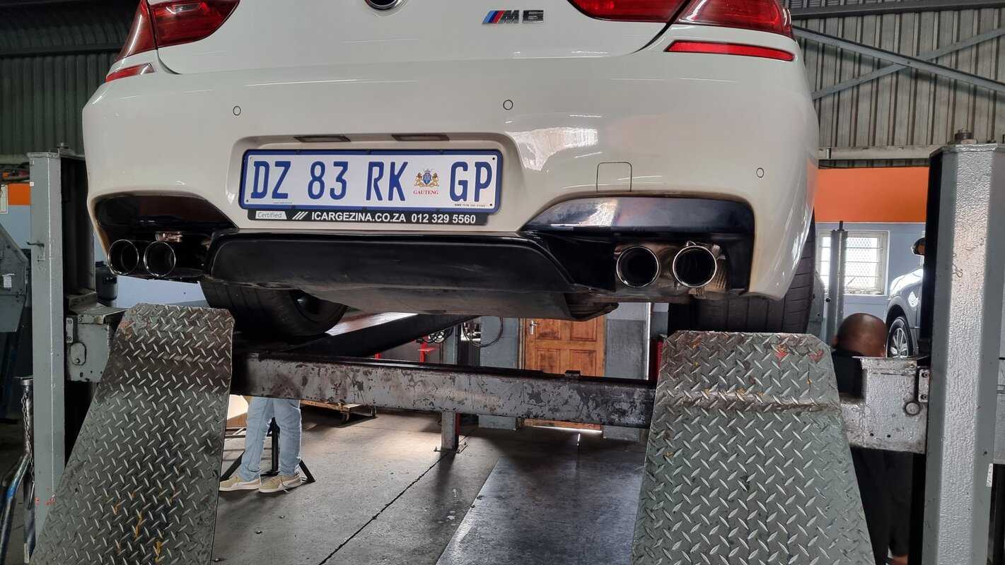

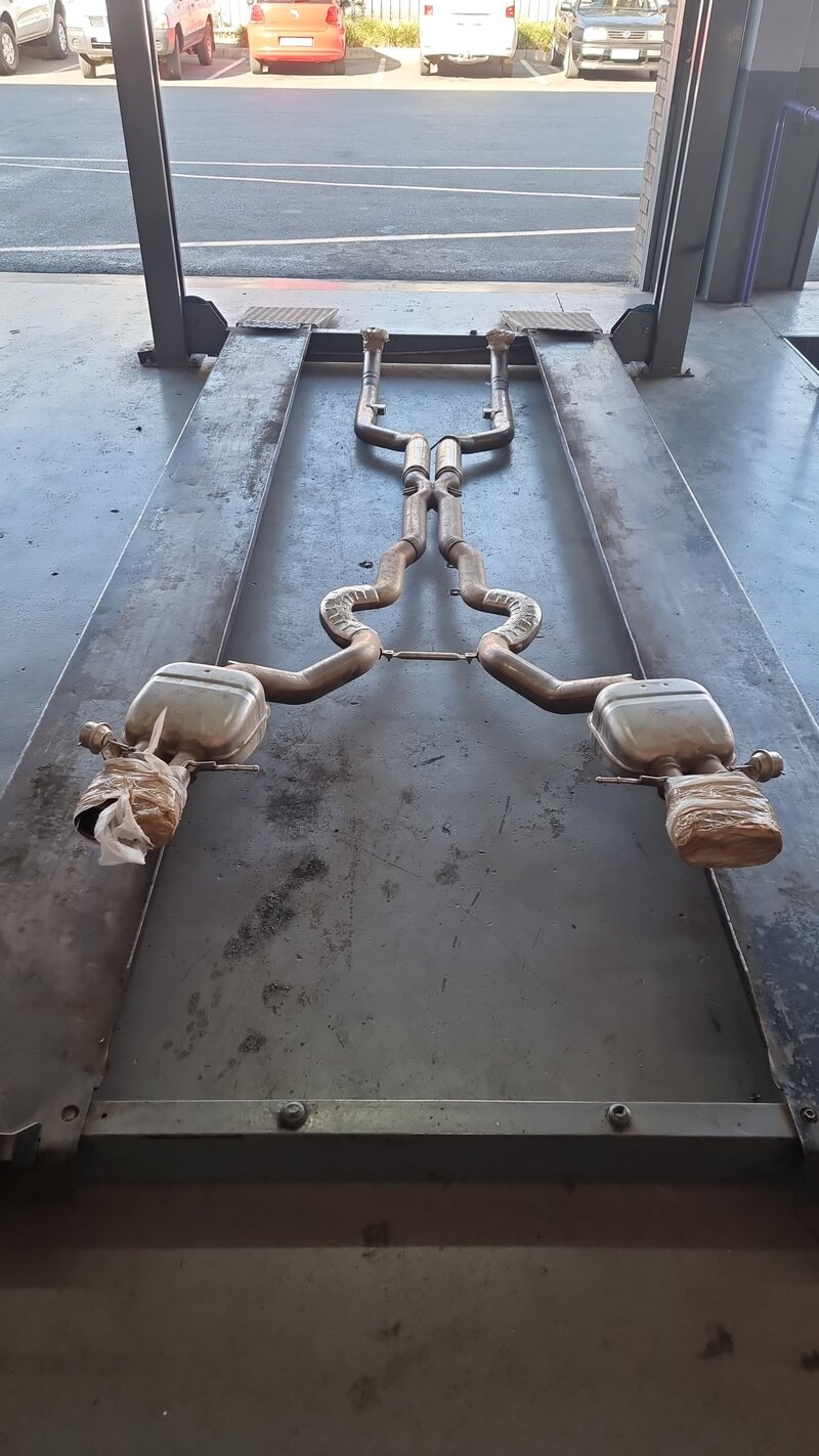

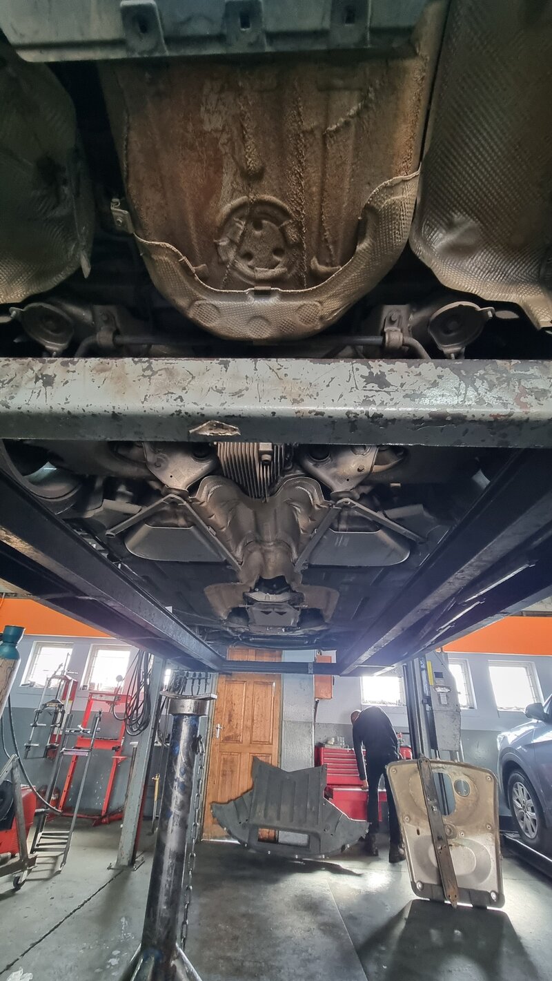

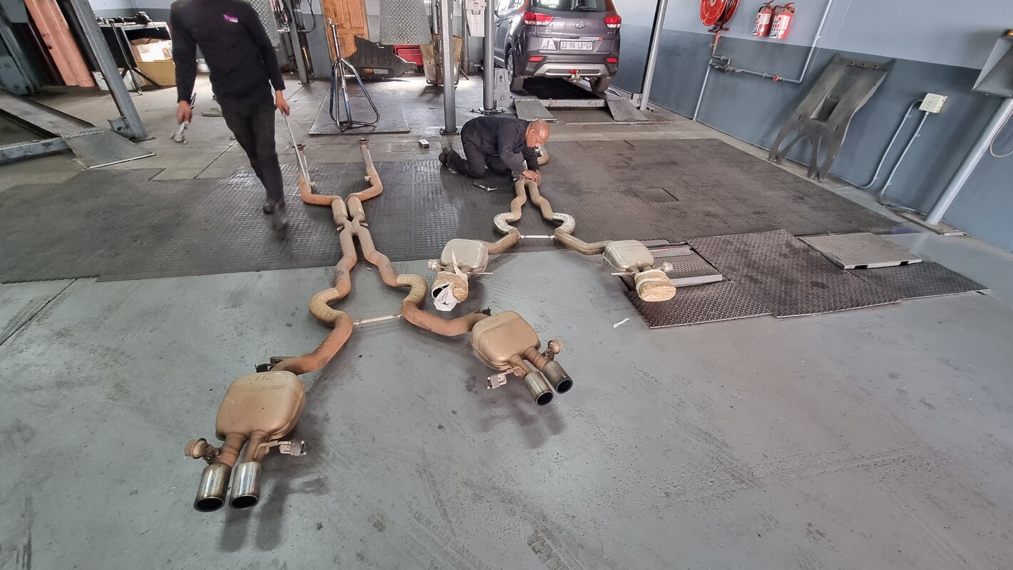

When I arrived the Exhuaust was waiting for me, still with the tips and the front openings wrapped up by the seller.
Car got on the lift and we started removing covers, brackets and bolts etc, and the old exhaust came out.

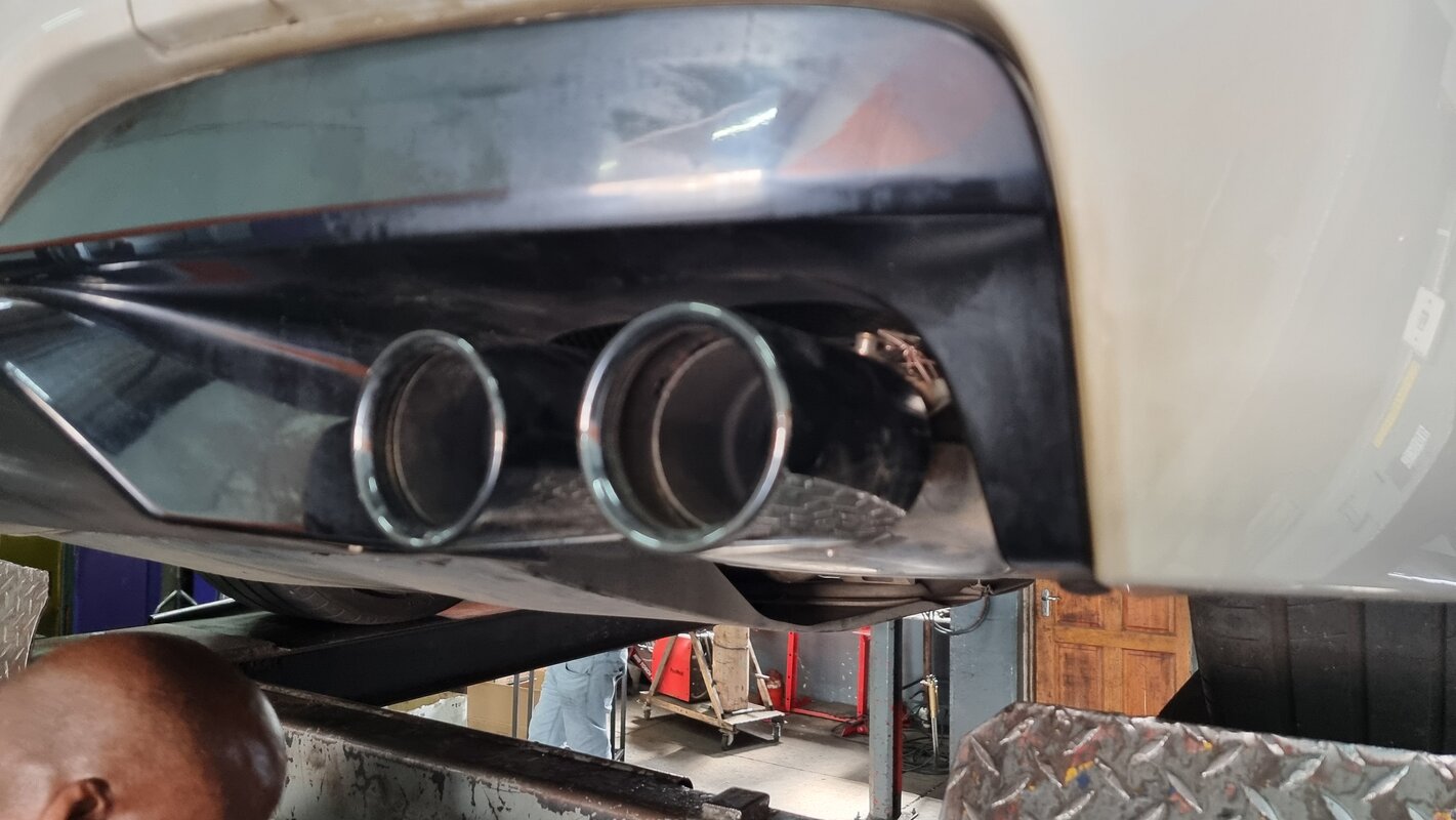

New exhaust went in easily, no issues at all. I bought new OEM DP/Exhaust gaskets and seals for the install today too. And the tips are dead straight and line up in the diffuser perfectly.
I am very happy with the look, and the start up has a nice deep tone, I can hear the difference from stock to Comp, it's not overly dramatic. I'm still yet to have a cold start which I'll do tomorrow morning, but I don't think it will be stupidly loud, even with the downpipes.
The car also starts up smoother, and I think this could be down to the old exhaust having a leaking gasket between the DownPipes and the Exhaust connection.
Might be placebo effect, but the car does feel somewhat smoother on the drive. Whether it's related at all. No idea.
The exhaust tone MIGHT change slightly as the exhaust gets a few heat cycles, but I'm not sure if thats related to new exhausts only. But this exhaust was apparently removed off a M6 that had only 25 000km on it.
So guess tomorrow's cold start will be an interesting one to compare again the old exhausts cold start.
I'll let you guys know the outcome.
But Im happy with the look and tone of the system now. Especially with the down pipes. No drone whatsoever, just a good deep rumble at idle. It's lovely.

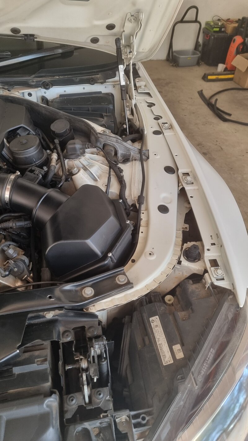

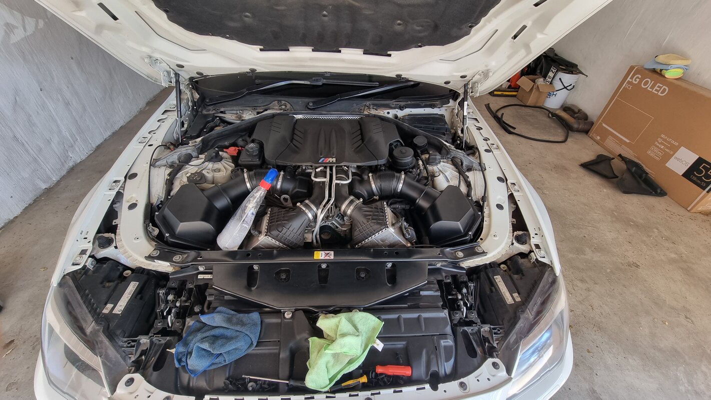

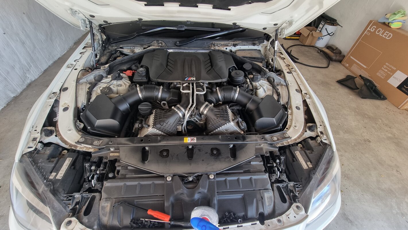

Still be trying to track down the possible battery drain source, still no luck, so a couple weekends ago i decided to strip all the plastics off the engine bay to try find anything that may look like an aftermarket device, and i found nothing, so saw how dirty everything was, so took the opportunity to give it a clean, will do it again at some point with some engine cleaner/degreaser, a brush, and the pressure washer. but for now, its better than what it was.
Before with Plastics stripped
After a quick clean:
I cleaned the black plastics also by the headlights, but need a good brush and some detergents for a better job, so will strip off again later on.
