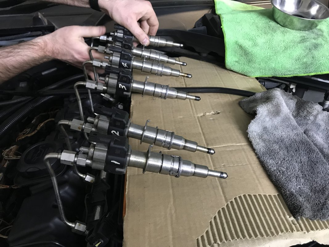

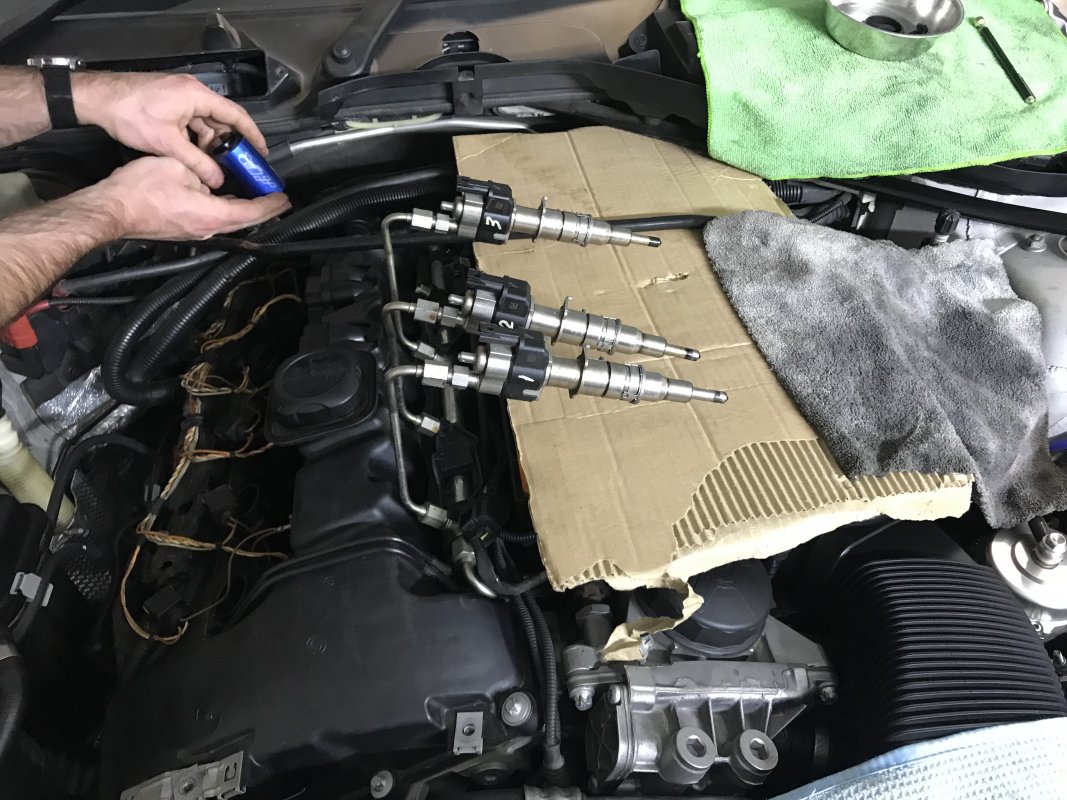

Nice, It was good to see that none of them were leaking as its been bothering you for a while that you might have had a leaky injector. At least we gave the tips a good proper clean as well.Howdy guys.

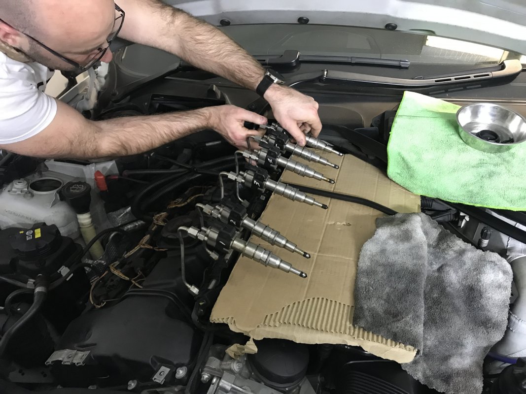

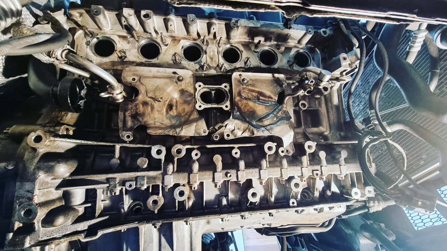

So just a quickie update.

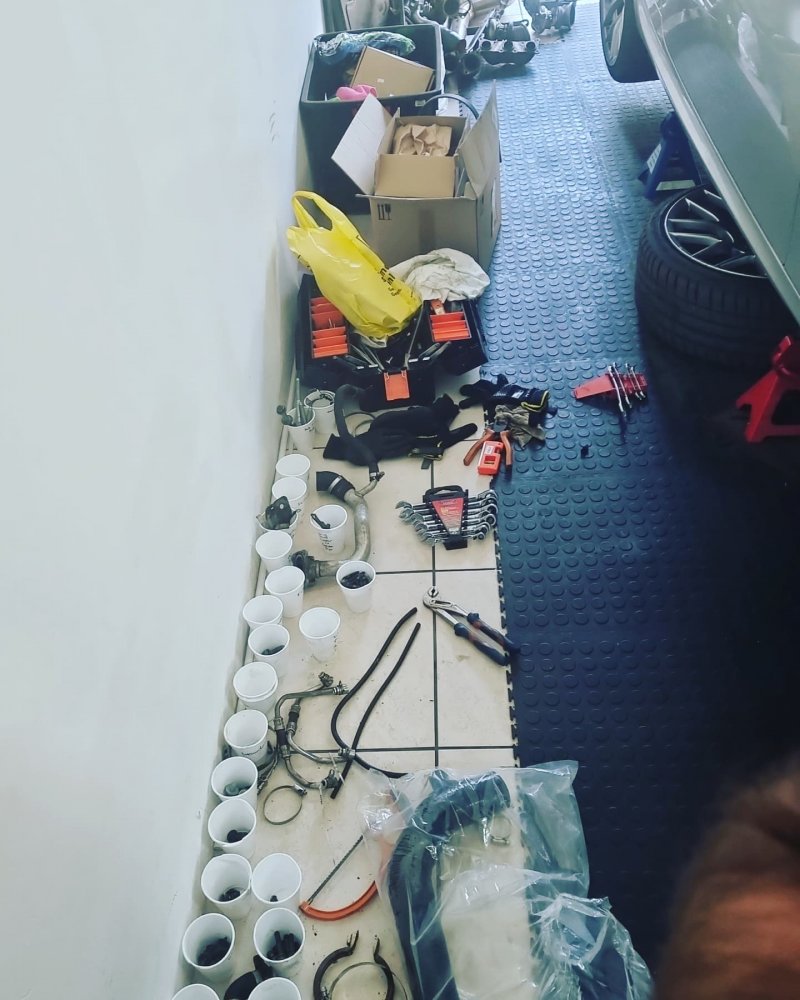

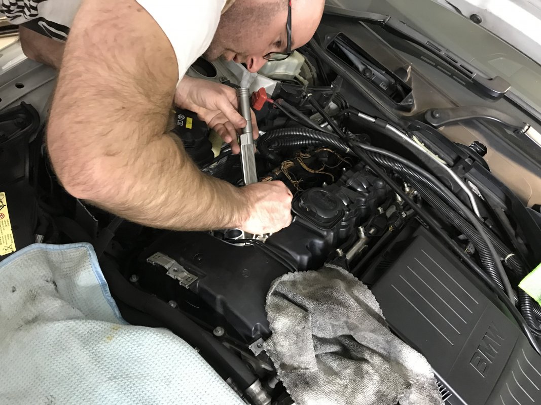

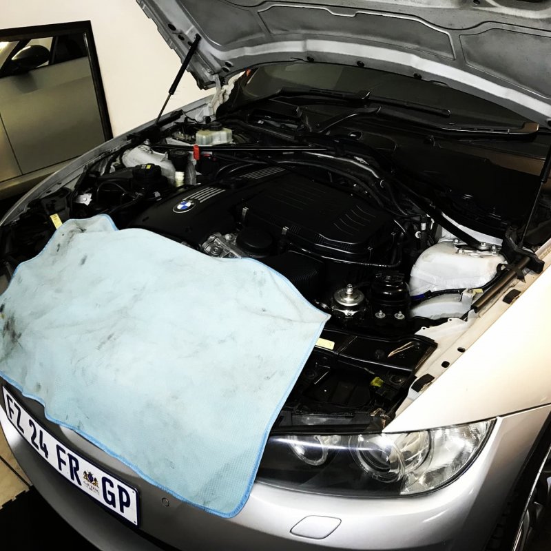

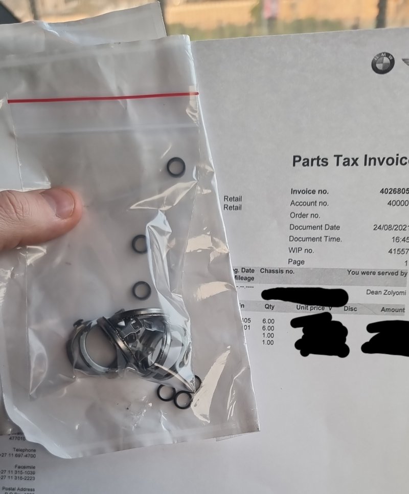

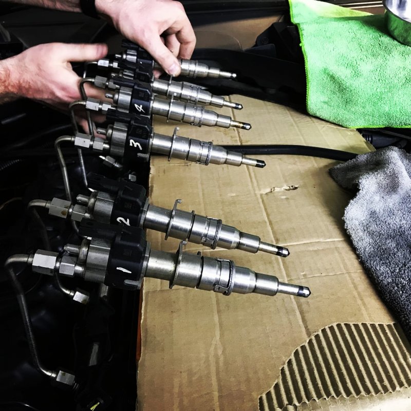

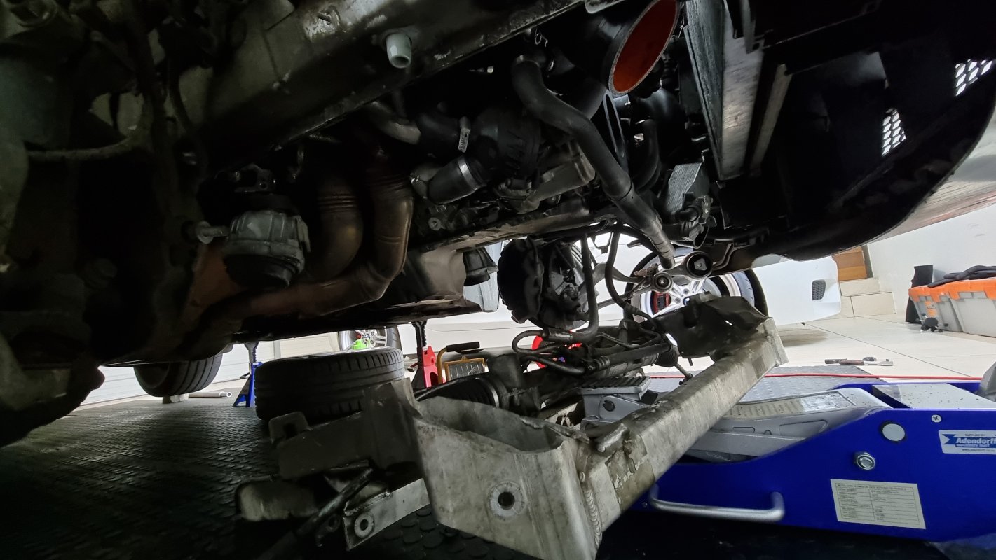

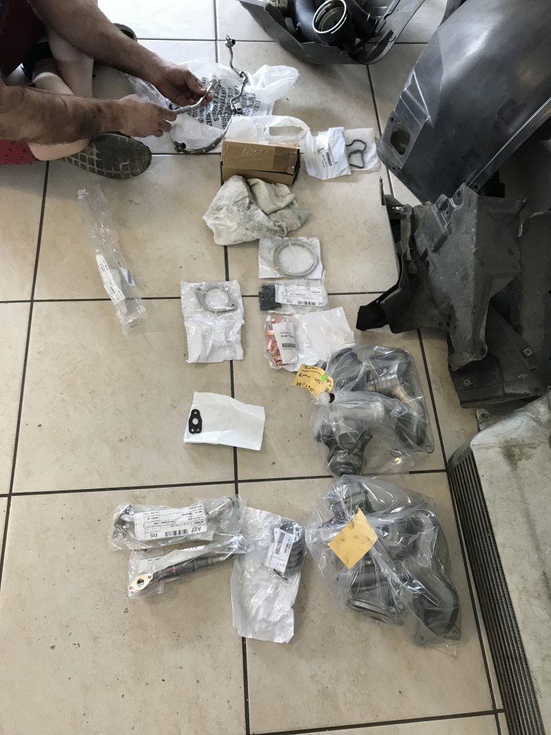

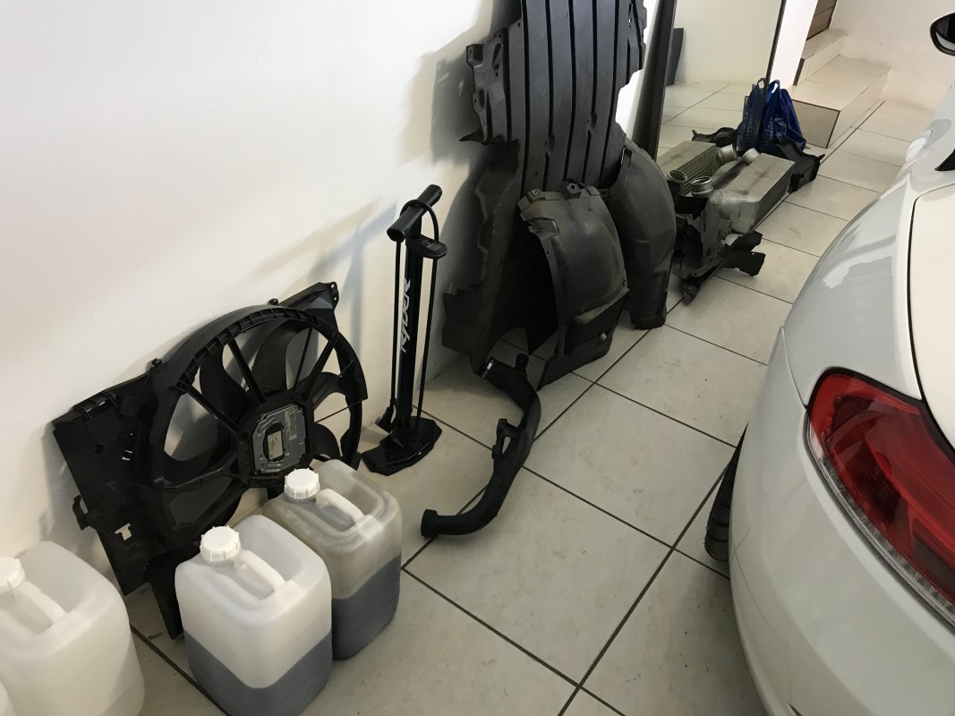

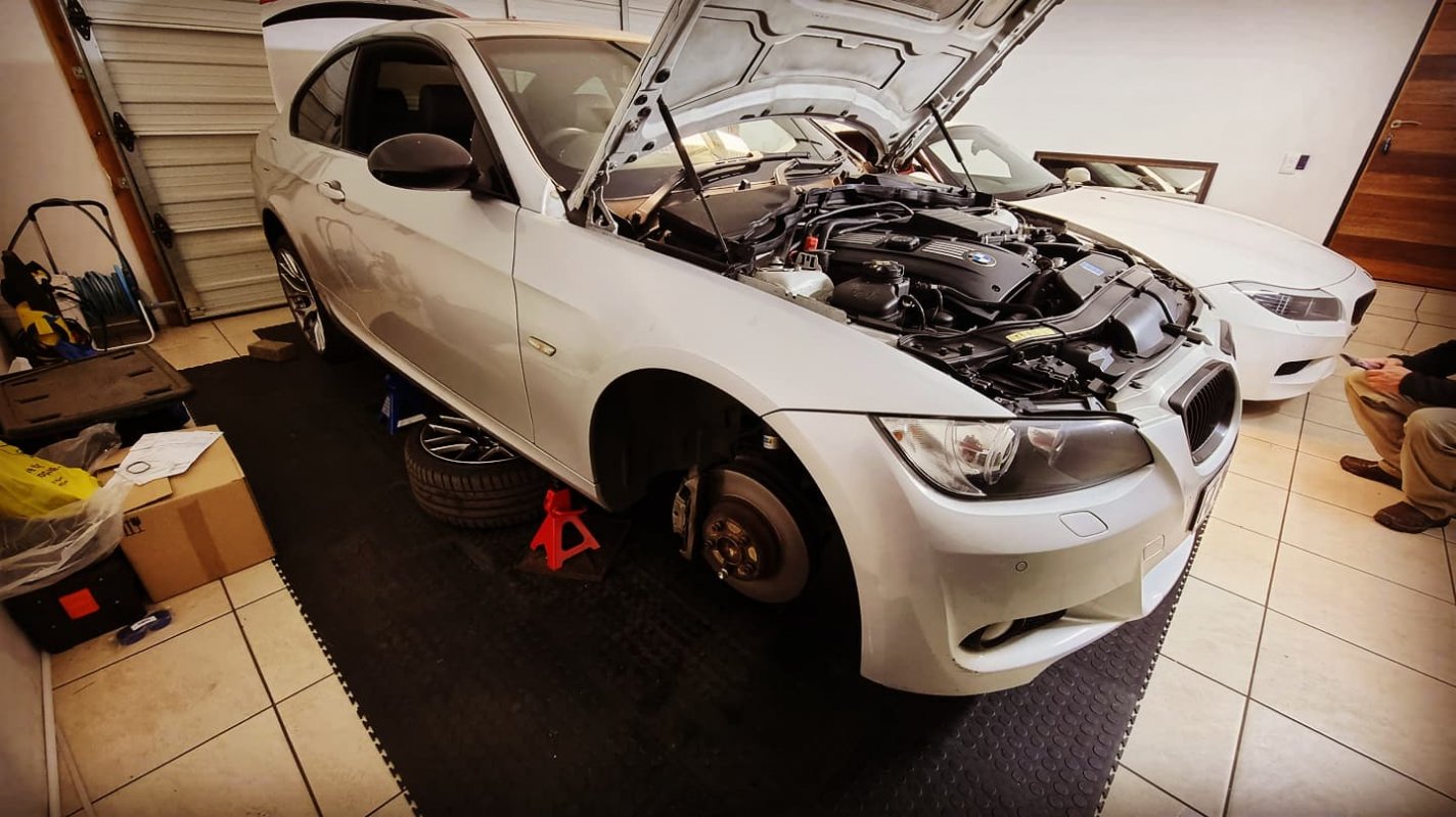

After purchasing the above seals and Decoupler elements, I arranged with @osiris and I met back at his place this evening after work as the banter and vibe is always good when working on the car.

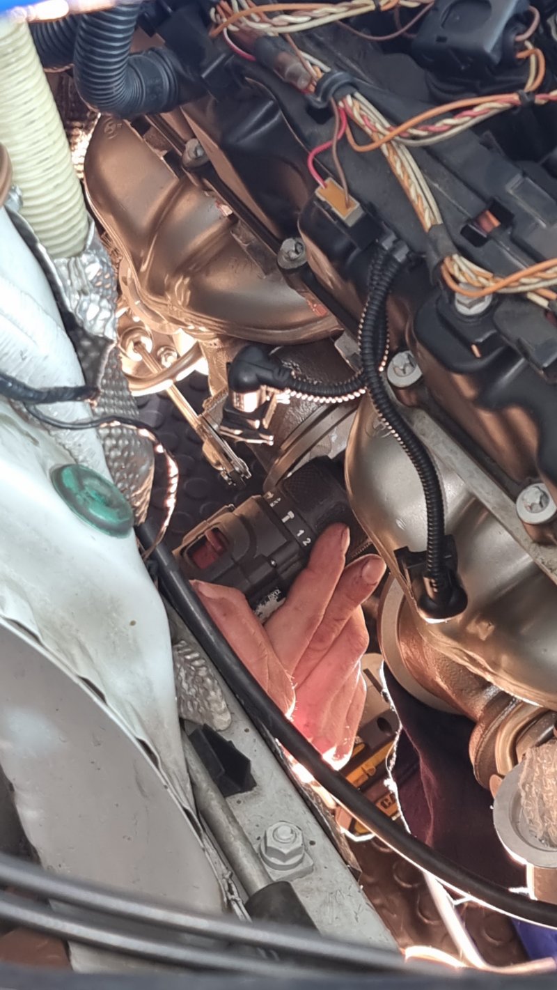

Prepared the car

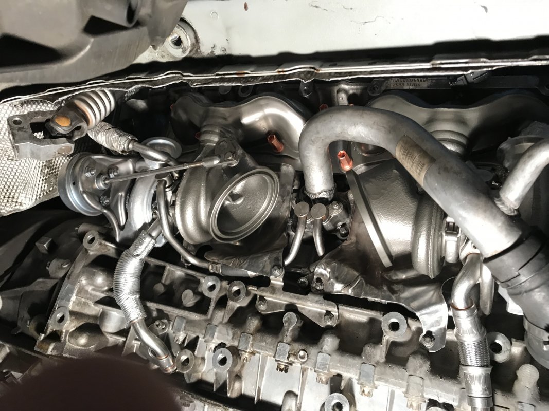

Then got out the coils, Fuel Lines and Injector brackets

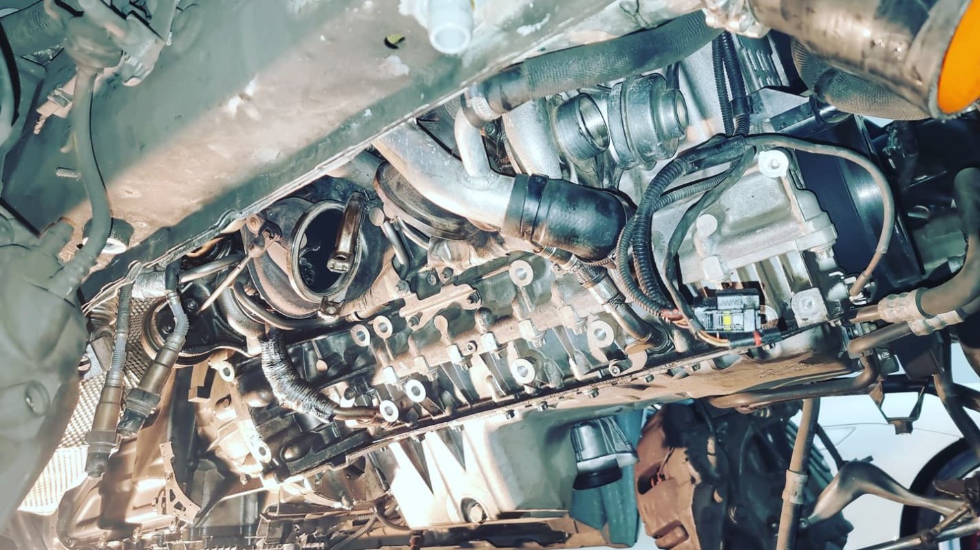

Quick inspection of the bores and that all is clean and no issues

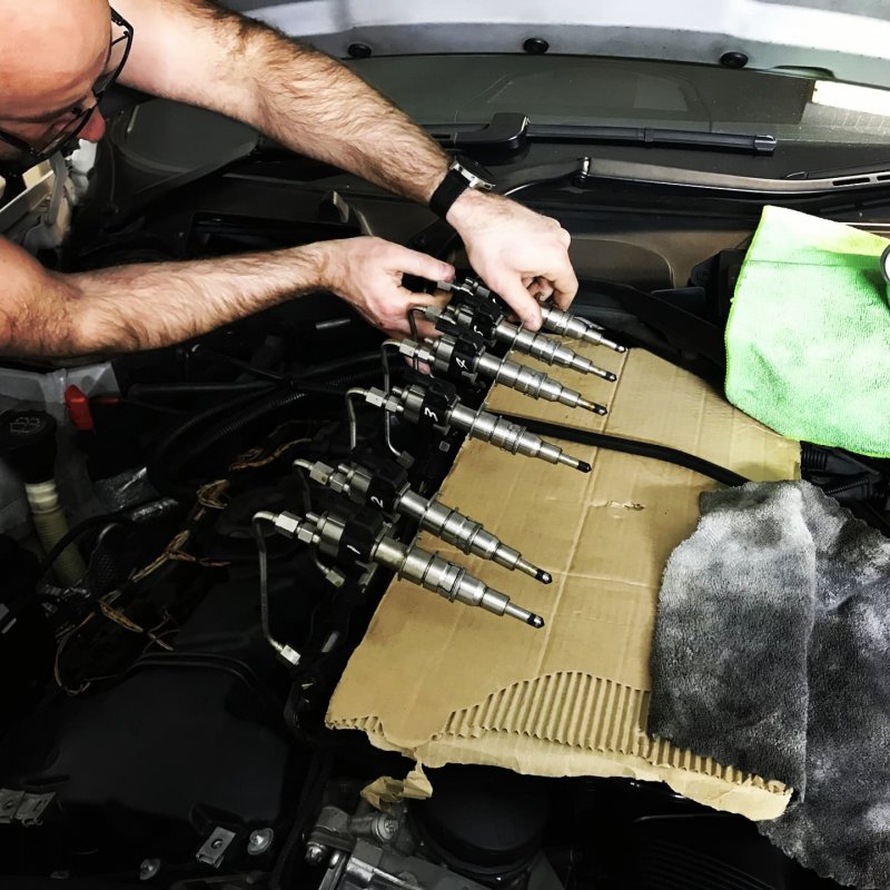

Went ahead and removed the injectors with the Precision Raceworks Injector removal tool. And proceeded to fit the injectors opposite and outside outside engine for a leakage test.
Happy to report after a couple tests and swings, none of the injectors leak which was a great sign.
@osiris even went as far to fit his old leaking Injector to Cyl.1 to make sure we doing it right and sire enough his old Injector leaked immediately.
So I'm a very happy guy.
Didn't get any pics of the seal fitment and reinstall. But it went flawlessly.
The car is still currently unassembled in the garage, but all injectors are in. Didn't want to finish and start car so late. So will finish in the morning and prime and start the car.

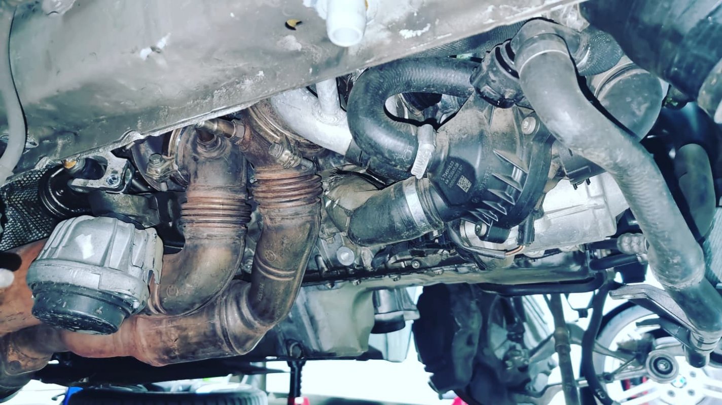

Howsit man, I have stock Downpipes, and just had the cats knocked out, both @osiris run our Stock downpipes this way, no issues, and same benefits as aftermarket DP's.Howzit, what downpipes do you have fitted? Want to fit the TMSS pipes but live in Cape Town. Need someone to take in their E92 335i, to use as a template, but so far no takers??
yup, I ran aftermarket downpipes for ages. I did back to back dynos with the gutted downpipes vs aftermarket downpipes and there was no difference in power just cooked engine mounts and irritations when trying to remove O2 sensors etc.Howsit man, I have stock Downpipes, and just had the cats knocked out, both @osiris run our Stock downpipes this way, no issues, and same benefits as aftermarket DP's.
using the 3inch aftermarket downpipes are nice, but they sit very close to the Engine mount, and end up cooking them over time. stock gutted downpipes are more than sufficient unless you aiming to extract every last bit of horsepower, which i doubt.
Just go to a local exhaust shop, and have them remove yours, knock out the insides and refit.
