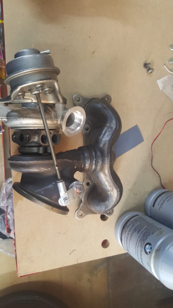

2 Months ago, i bought myself the Wastegate repair Kit to fix the Wastegate rattle ive been having on my car, i knew the only man to go to for this was Afzil AKA @ByeByeM3 after reading the reviews and the great word of mouth promoting of his work.
So last week Thursday the Car was dropped off early, and Afzil started his work.

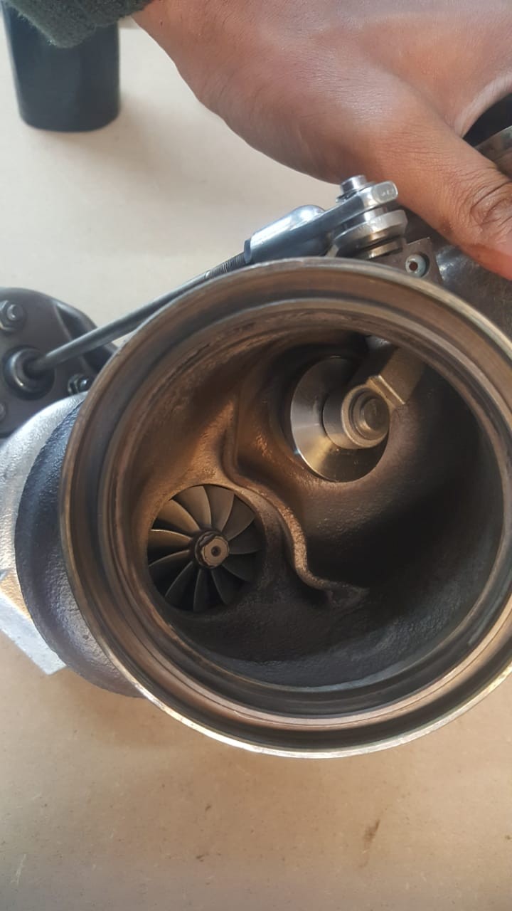

the Turbos were stripped in that day, and the following was sent to me of what was found.

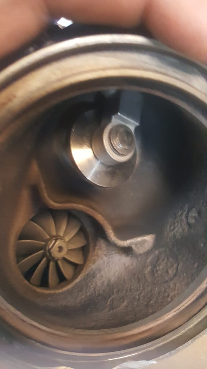

Rubber Grommet had been sucked into the one turbo and was subsequently eaten up and destroyed

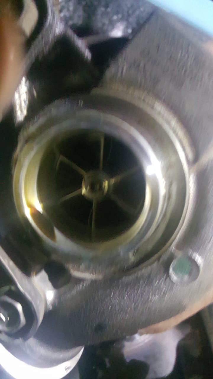

First Turbo that ate the Rubber Grommet was showing some signs of blade wear

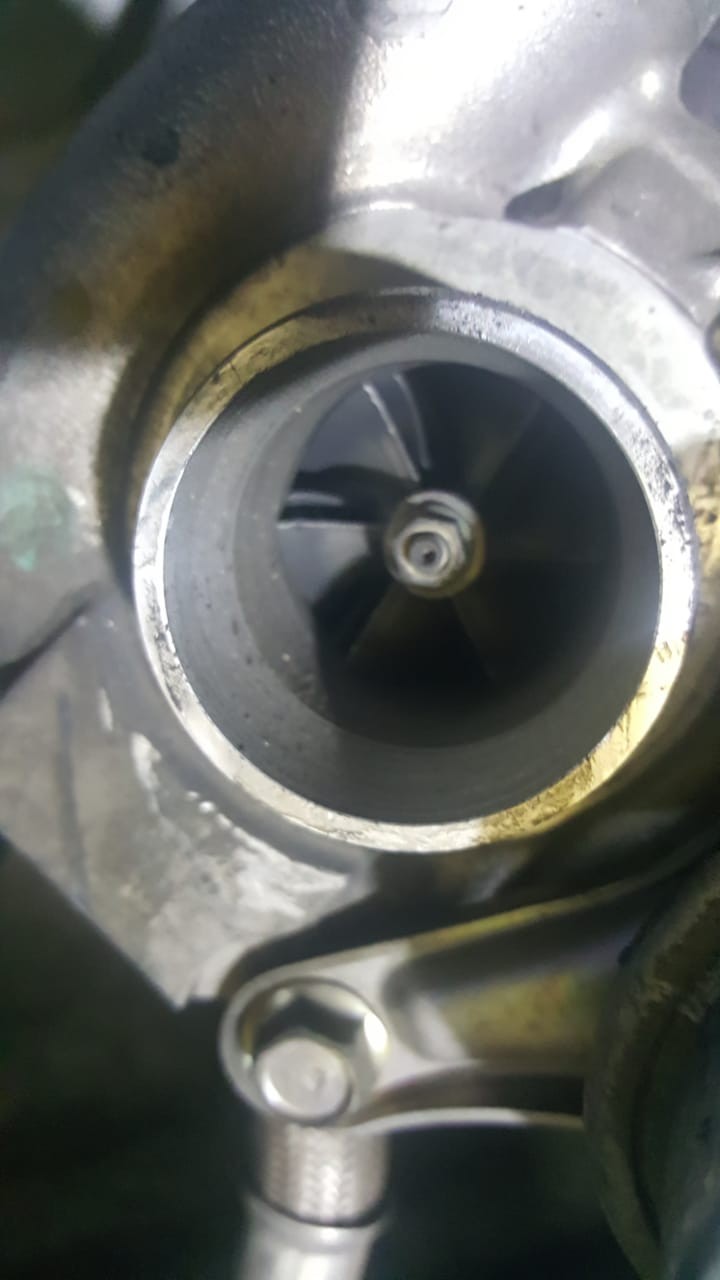

Next turbo

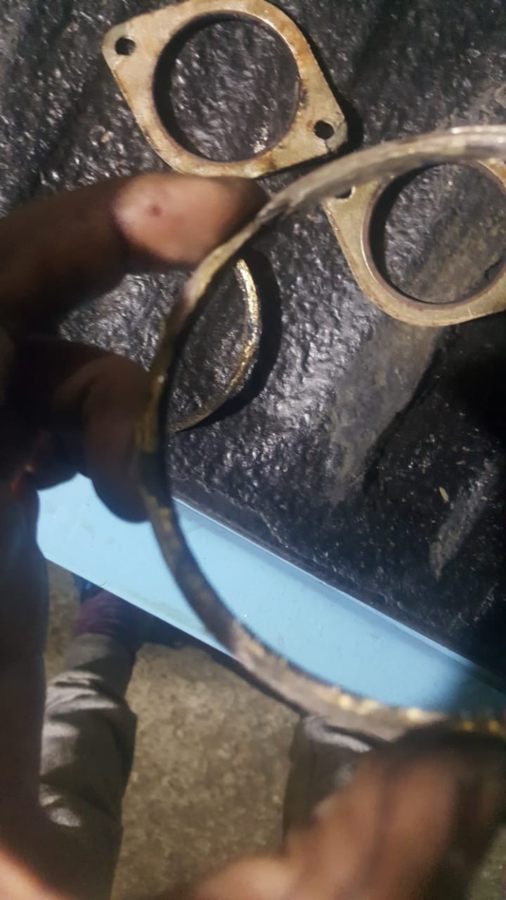

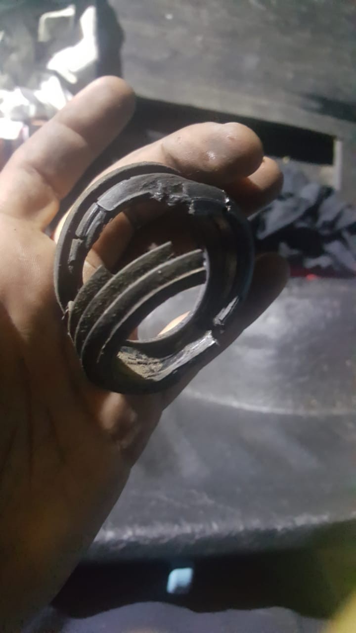

Downpipe gasket had blown and was not in great condition, so this was replaced

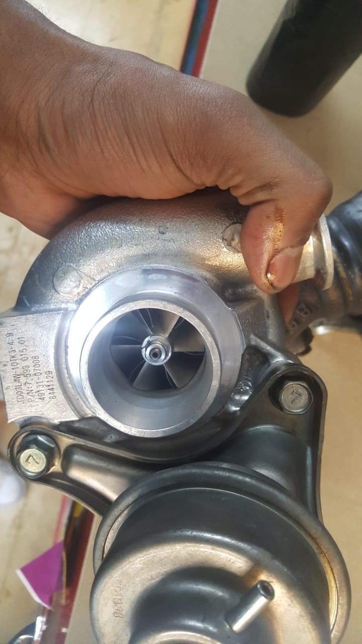

He received the Turbos back, and all had been refurbed and balanced, and he had fitted the Anti Rattle kit with new flappers.

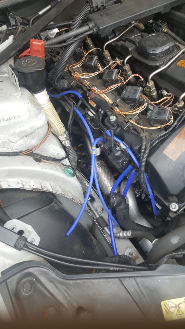

New Vacuum lines were replaced all round, as the old ones were stuffed, and broken (the new ones i had replaced with osiris were also removed to make them fresh and all the same.

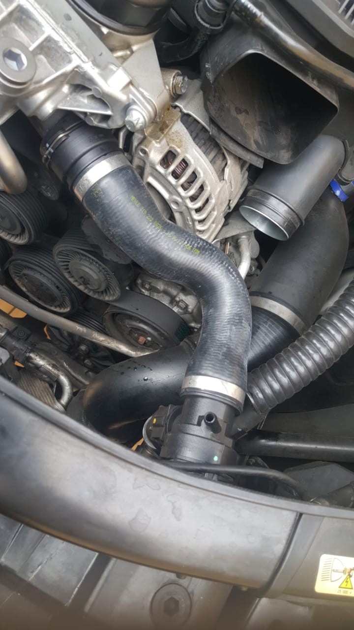

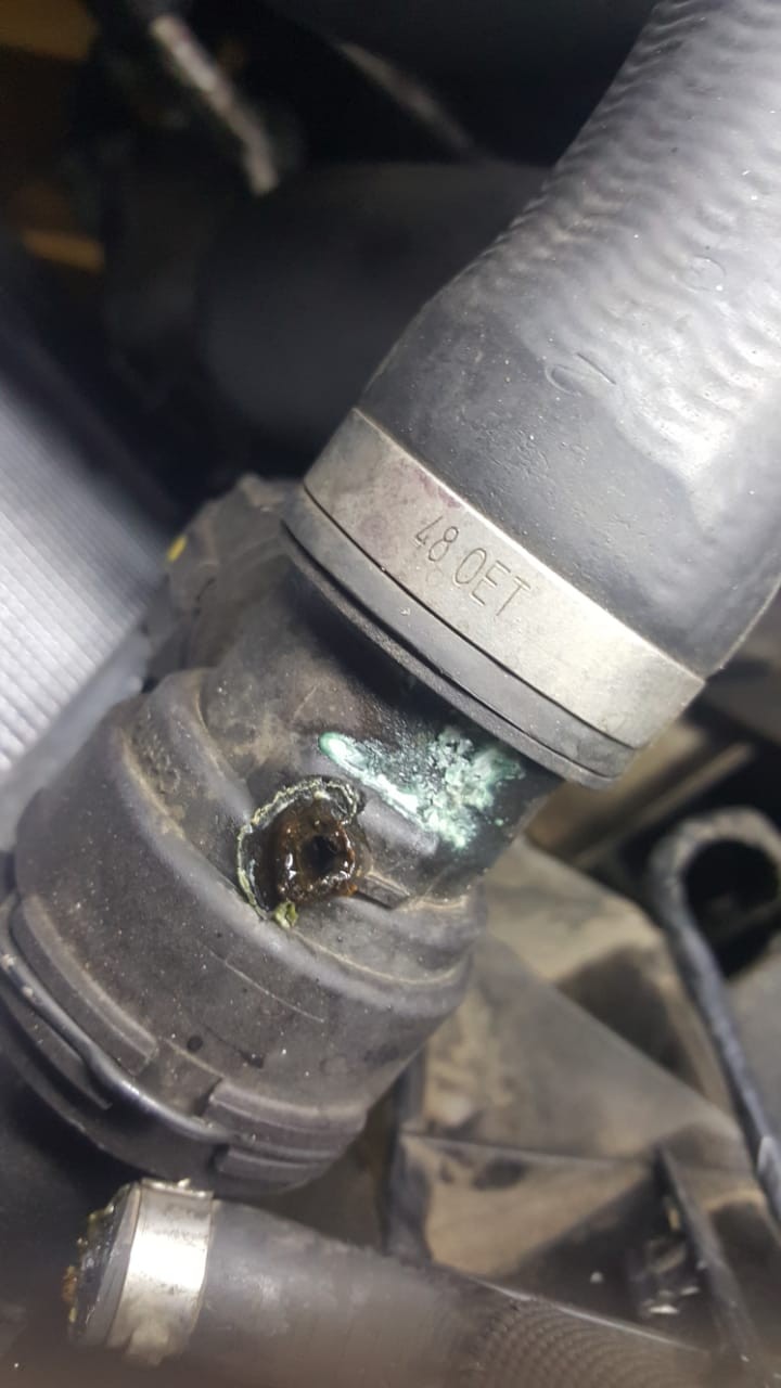

Afzil had also found that the top radiator pipe nipple was broken, and he had bought a new replacement pipe for me.
New Pipe fitted

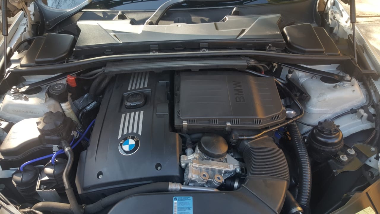

Here is the final pic of everything fitted.

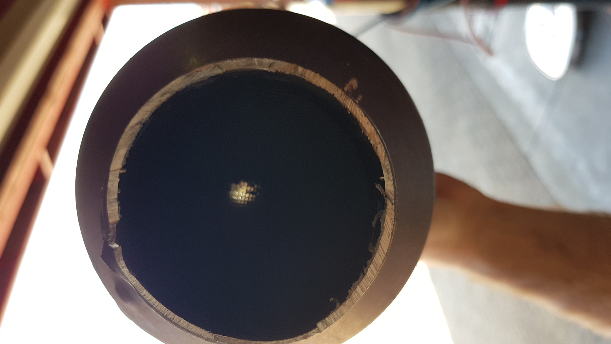

In summary. It was regarding the plausibility of the stock secondary cats getting blocked. And draining the car of power.

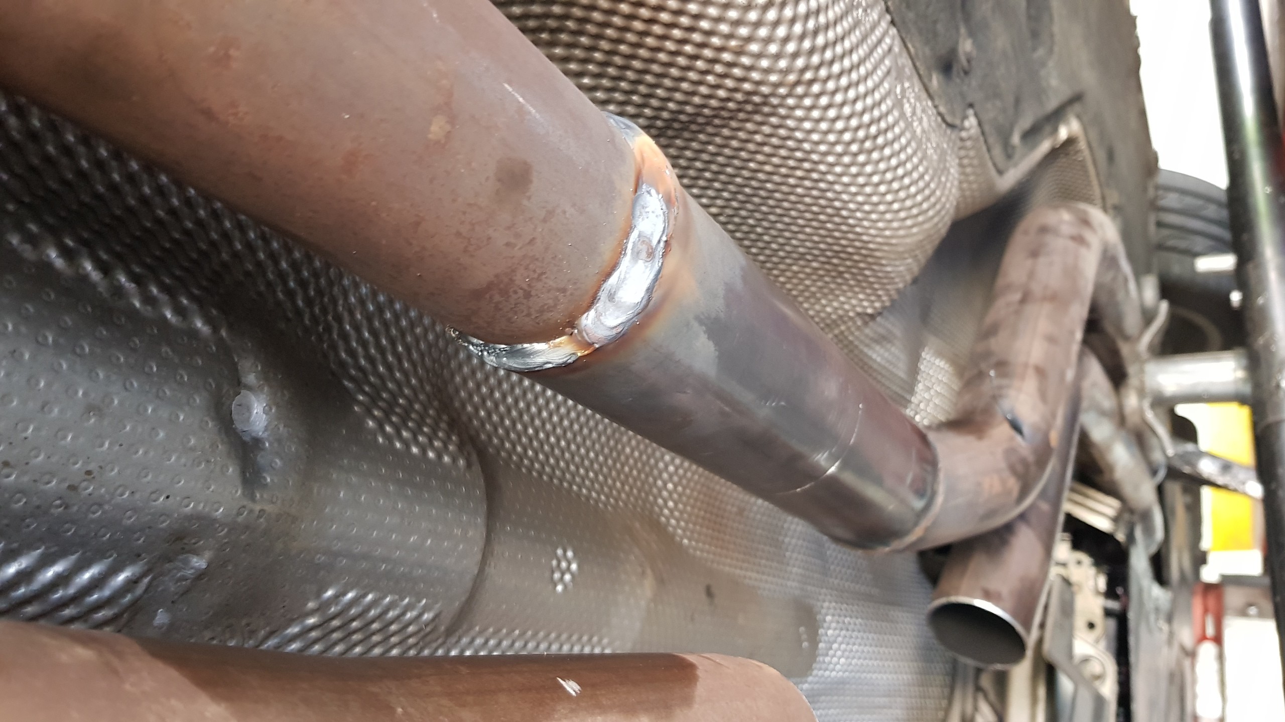

So. I made the decision to go to SupaQuick (I know, there are loads of more reputable exhaust shops around, but for testing purposes I just went to them as they were close by.)

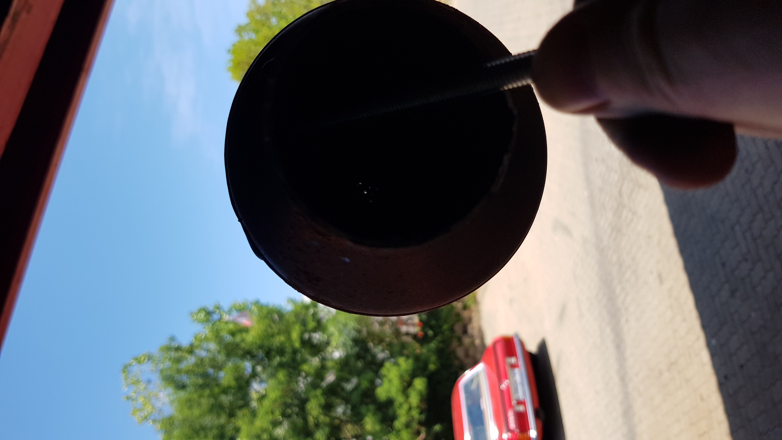

Once the car was up, they removed the cats. And this is what the result was.
Right side Cat. This is ok-ish. As the honeycomb mesh shows direct line of sight.
Left side Cat. Totally blocked. No light at all going through.
So the Secondary cats were straight piped. Job was decent. Albeit I'll be looking at a full system in the future. This will do for now.
