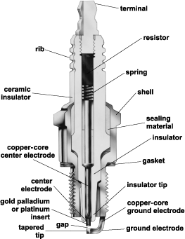

less than 200km after a service a spark plug fell apart.
long story short i had a "bad" plug from Bosch.
the platinum insert fell out of the insulator of the plug.
