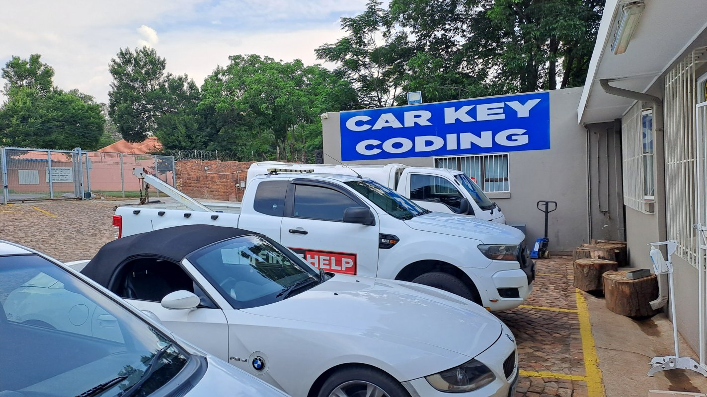

Coding/cutting a key
After my key started acting up again (remote working intermittently), I went to Central Locksmiths in Corlett Drive today. Within 1 hour they cut/coded a new key (I wanted a new fob because the old one is pretty tatty) and fixed my old key. Excellent service at a reasonable price.

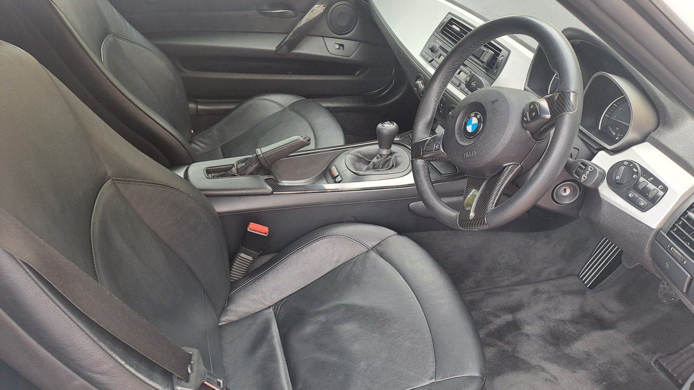

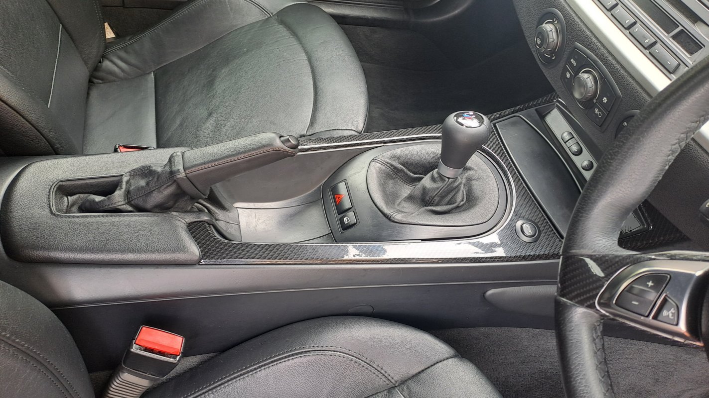

Small updates...
Carbon warp on door pull handles, selected parts on steering wheel and gear console.
I did not want to wrap the dash panel because it would darken the cabin too much. However, may think about this again next year, when I have more funds.
The main reason for the wrap was to cover all the scratches.
It did not cost much to get this done, so for what I paid, it serves its purpose. The gloss look may not appeal to all, but I am not complaining.
Ceramic coating was also done. Hard to see the difference with this camera.

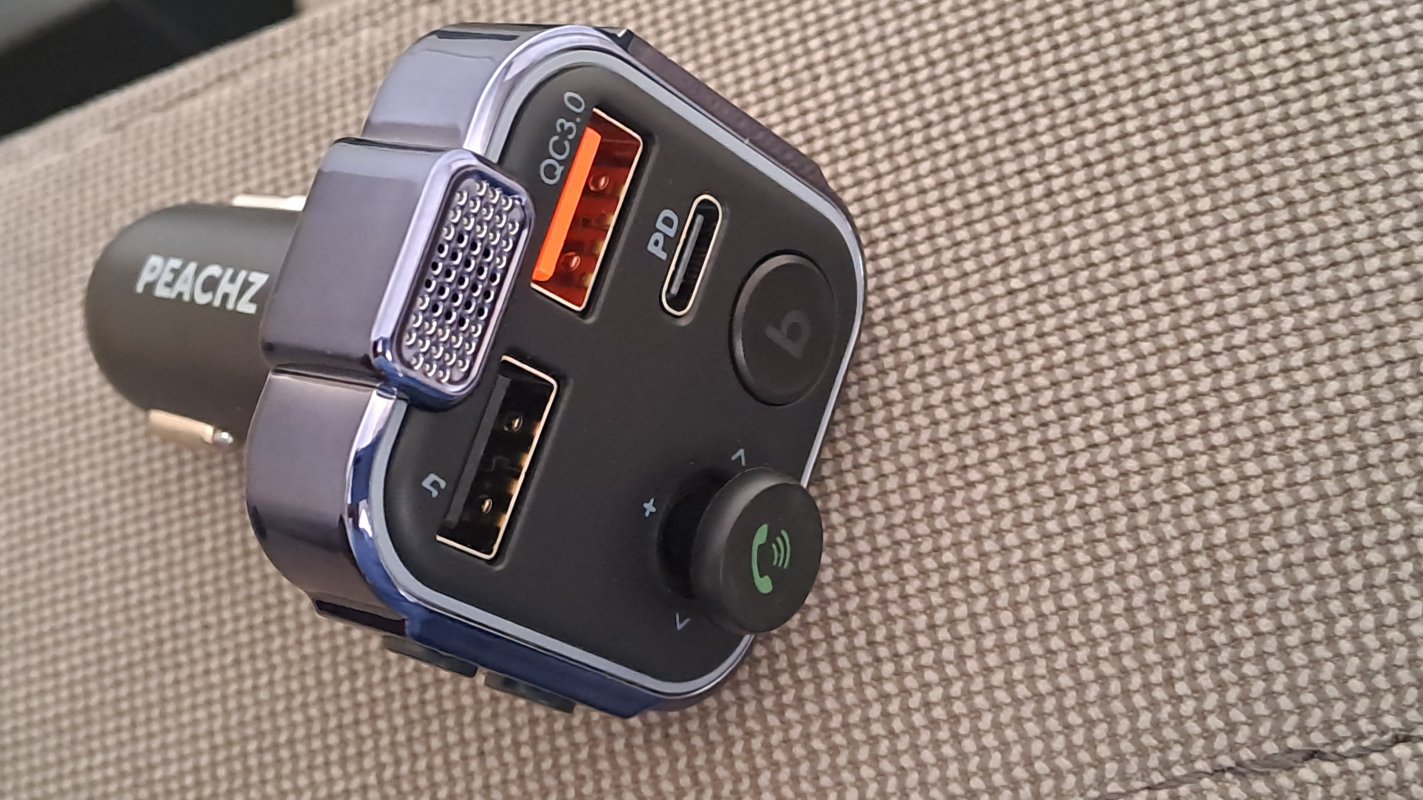

I bought a Bluetooth Aux+FM Modulator for handsfree calls and music streaming. It is one of the more expensive units on Takealot and has good reviews. Will test it this weekend. Also heard good things about the Peachz brand from Toby Shapshak from Stuff Magazine.
Update on the FM modulator:
I see now that it has no Aux, so just using FM. Reception is excellent - no static. Bluetooth handsfree also works well. The unit has a mic that picks up your voice and has noise cancellation as well (so someone can hear me when my exhaust is barking :)). It also has a nifty car battery voltage readout to let you check the status of your car battery. The fast charge port also works well. Only negative is that the E85 keeps the socket powered even when the car is switched off, so you have to pull put the device when parked. For R499, it is a bit pricey than other FM devices, but it works well.

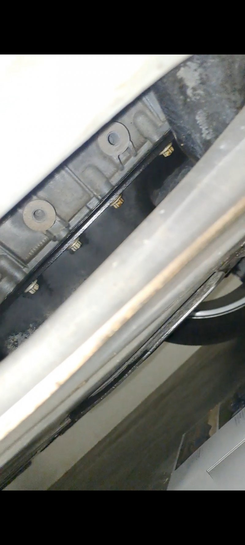

I saw the oil level on the computer has dropped by 1 bar, so 250ml I guess. The oil was last topped up just over 1,000km ago.
When I checked underneath, there is no dripping, but the oil sump gasket area and bolts look moist.
Will monitor it. I will place paper under the car while it is parked in the garage when I am on holiday.
From what I read up, it is quite a job to replace the sump gasket. The subframe has to be dropped. However, this is a common issue on these cars/motors, so one of those maintenance items to add to the to do list.
Anyway, not too phased. Will get the mech to look into it next year.

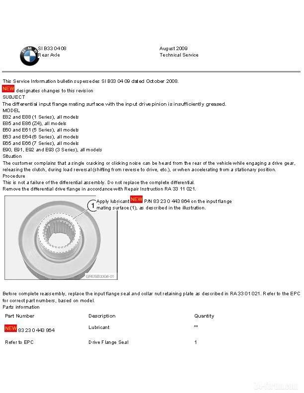

There is a low speed clunking noise that occurs when you accelerate from stnadstill slowly or when you engage 2nd from 1st slowly. Feels like it is related to a change in inertia (maybe wrong term to use) at low speed.
Anyway, it appears to be a known issue on the E85 Here is the BMW bulletin on it. Will ask mechanic to check it out while it is gone in for the oil issue. My propshaft was serviced recently - not sure if that impacts this issue at all.

So the car is leaking a bit more oil...
Seems like a new sump and gasket are required. Rear main seal will also need to be assessed. And while this major surgery is underway, I asked to also check the status of the clutch and flywheel as well.

Update...
When they removed the sump, the clutch was also checked.
Looks like the clutch and flywheel are pretty worn after 17 years of use. In theory, these could last a bit before being replaced, but while the sump is being replaced and that labour is underway, it makes sense to attend to these items. I decided to get it done and take that hit now rather than defer that maintenance cost.
