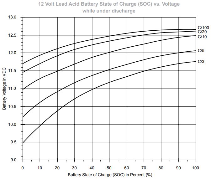

How old is your battery? Are you doing lots of short trips?
