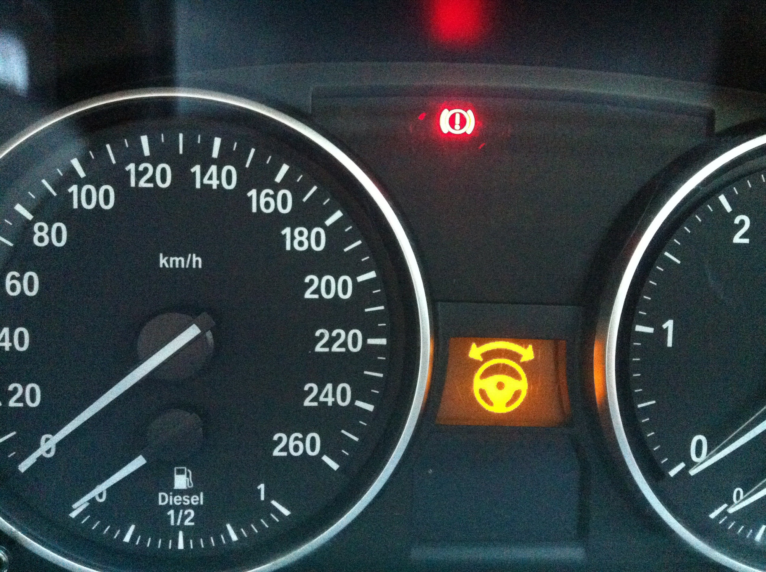

Got the steering wheel with two arrows yellow warning light and car will not start. Is it necessary to replace the CAS and the steering column?
BMW wants 12K?
any advice??

Get someone with a cable and do the following:
If you have completed this DIY (thanks yakev724) and still get that pesky yellow warning light, I found a way to clear it (credits to Micha from the German e60-forum.de). Apparently the ELV has an internal counter that causes the yellow (and red?) warning light to display. This counter can be reset using EDIABAS ToolSet32. The count is stored in the CAS and needs to be cleared in CAS and ELV. Load CAS.prg in ToolSet32 and run the commands "steuern_elvcounter_cas_loeschen" and "steuern_elvcounter_elv_loeschen".
This procedure may even unlock the locked steering column with red warning light, but I haven't had the red light since I performed the DIY. I'm assuming this because after my steering column was locked and I had towed my car to an indy shop, the mechanic was able to unlock it by "resetting" something.
BTW, this counter reset worked for me, but as with any advice you find on the Internet, you do this at your own risk. Bonjour ;-)

Update... BMW replaced CAS as they couldn't connect to the car, 5.5k later, tried reprogramming the new CAS, they said I have to replace Steering column first for a further 14k. Got a second opinion from another dealer and they said its a BS story. I demanded my car back in the condition I dropped it off and miraculously they manged to do the software update on the new CAS and the fault was gone.
Three weeks later, steering with arrows showed up again. So clearly, the CAS didn't need to be replaced! I was only able to start the car by turning the steering full to the left, you hear the ELV lock and then unlock then it starts.
This weekend I followed the DIY removed steering col, opened out ELV module. Most of the moving parts were quite smooth, but I noticed the worm shaft end was a bit gritty, so sprayed some WD40, applied a but if grease and it felt smooth. Connected sterring col. and it locks and unlocks, tried it over 10 times.
Put it all together, took the car for a drive, when i parked I released the fob and it didn't lock, the error came back!!
Ther icon I get is not the same as many others with steering and lock, the icon I get is the steering and arrows. So I don't know if it is maybe something else??
I read up on the SZL but I don't get the DTC fault or the triangle with half circle icon??
Next I will check if a new battery will fix, otherwise I will get the emulator from Italy.
Where can I buy the cable from and what software should I download?

I think you are chasing the wrong issue, I think that could actually be a faulty steering wheel position sensor but I haven't had that issue before so I don't know if that is the symbol for it.

Hi buddy it's the small motor that's giving you problem have change it out and problem never came back

I had an issue on my car last night playing with Abrites. Turns out I just needed to clear the ELV counter. Maybe you lucky and that's it?

it's been more than a week now and i haven't tried anything new, and the error hasn't come up again. i can hear the steering lock working very smoothly, so the DIY seems to have done the job. As per the DIY post, it acted up soon after doing the DIY, but it resets or something after a day and the error is gone.
so if you experience a similar problem, i suggest that you don't replace the CAS or the steering column (as the dealer would ask you to do) until you try the DIY fix first.
