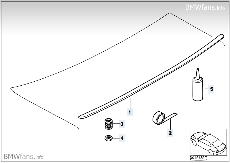

This is the one that the dealer supplies, this is an e46 part number.
Really thin double sided tape. Sorry but had absolutely no marking on it, so I dont know who makes it.

Which dealer and what is the part number? What did you ask for, just double sided tape?
Hi Calypso
Part - 51 71 7 901 759
Number 2 in the pic. Though it doesn't come in s small roll comes in a big box loosely looped.

I recently put the thin-lip boot-spoiler on my 540i, using the dealer supplied tape, as I really didn't want to second-guess the way it would be done originally. Do not like the idea of using glue for this at all. But this is my preference. The tape is really thin, and unlike other double-sided tape I have seen before. If I was to give my advice on this, I would say just get the tape from the dealer. For an E39 it cost me R130.
