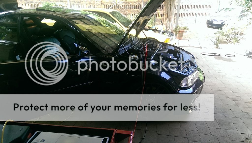

Anthony wanted to de risk his new M3 and we have been talking about it coming up to Jhb for some time.

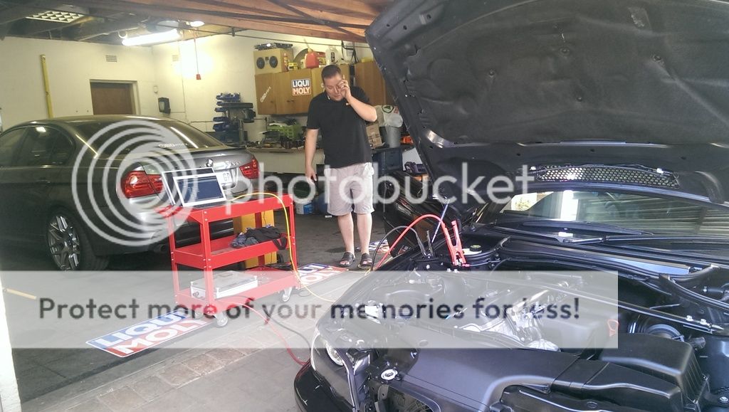

To cut a long story short the car arrived mid December and I drove it straight to Gert for an upgrade on the ECU operating system as well as an upgrade on the throttle software.
The throttle is far more linear now with good feel so for those of you who have been thinking about it I encourage you to do it.
For those of you who do not know what Gert looks like...well now you do.

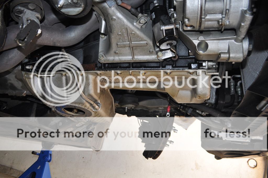

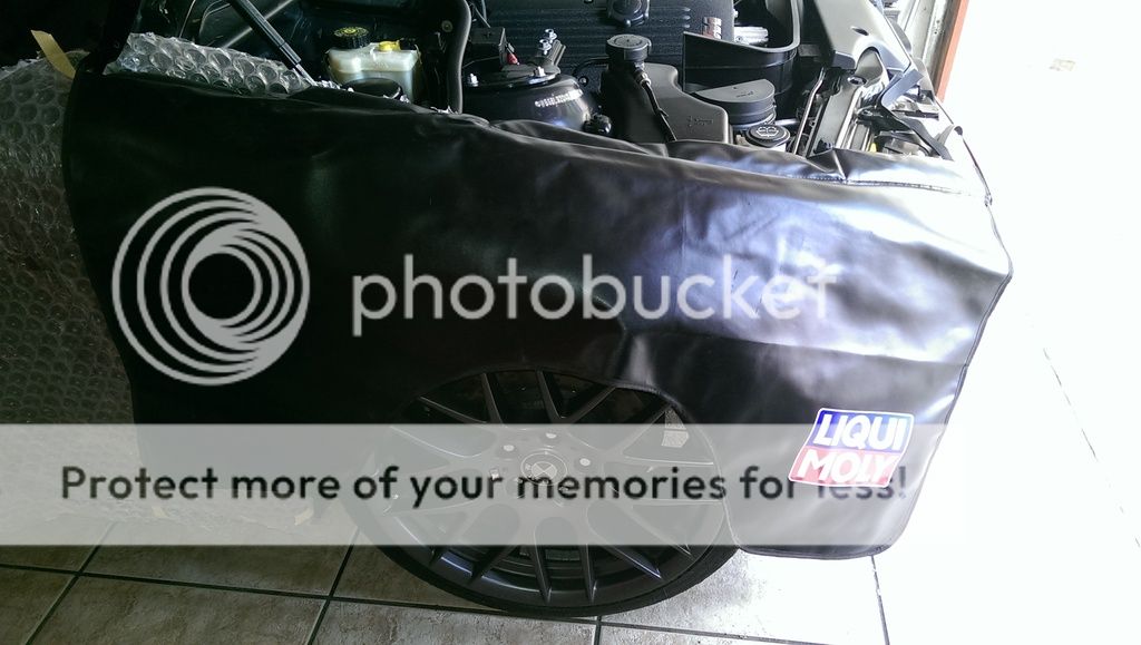

The car is particularly clean and I would put it on par with Moose's and Ashlin's car with Moose's old car whilst under his ownership as being the yardstick.

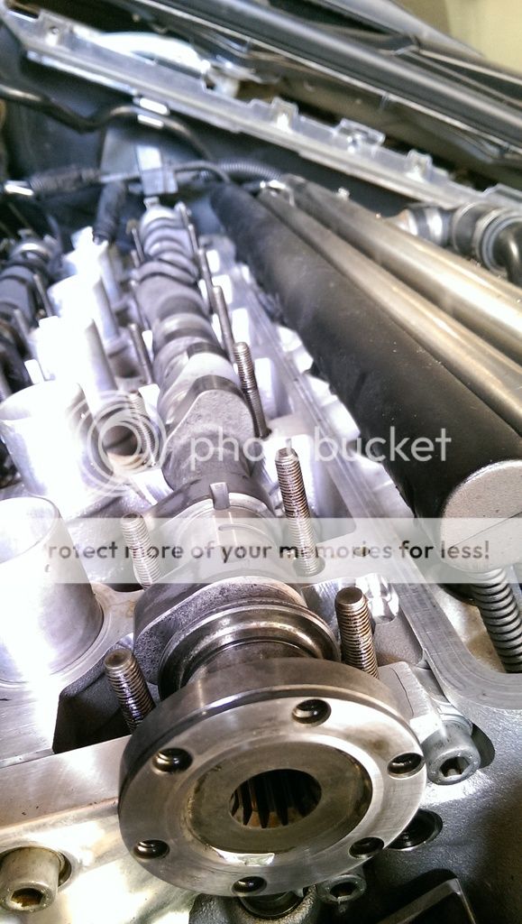

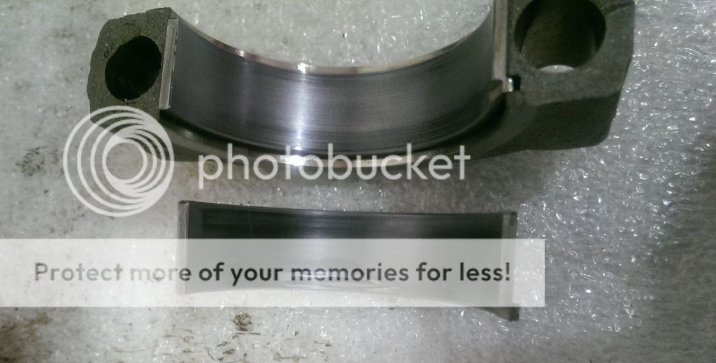

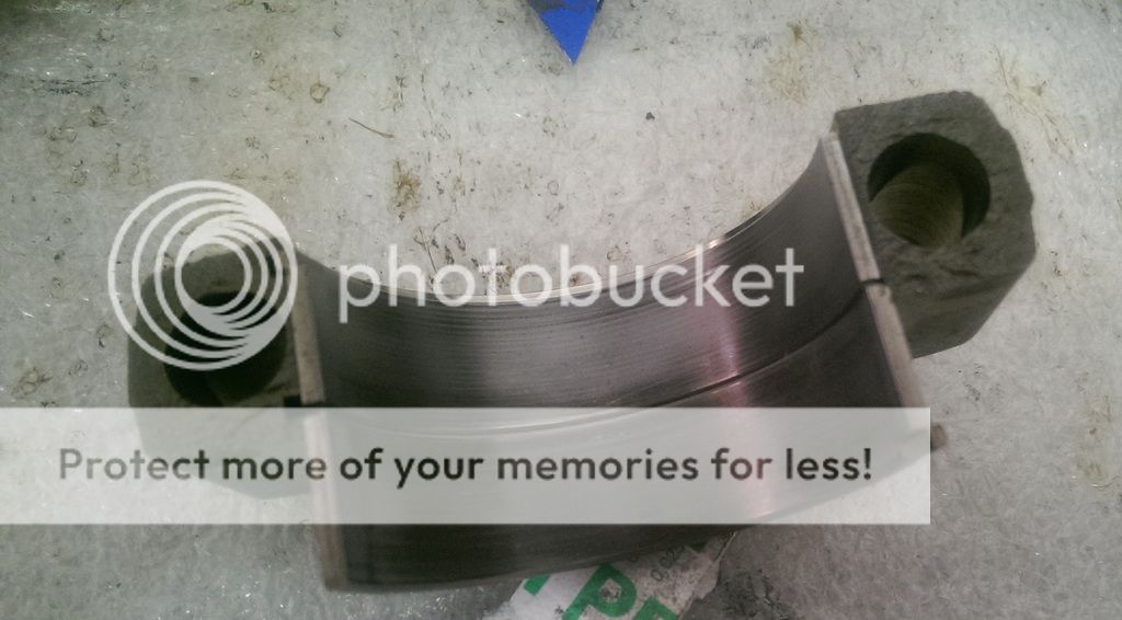

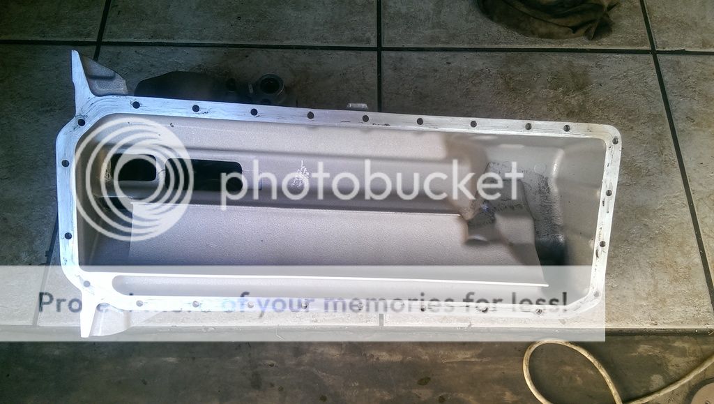

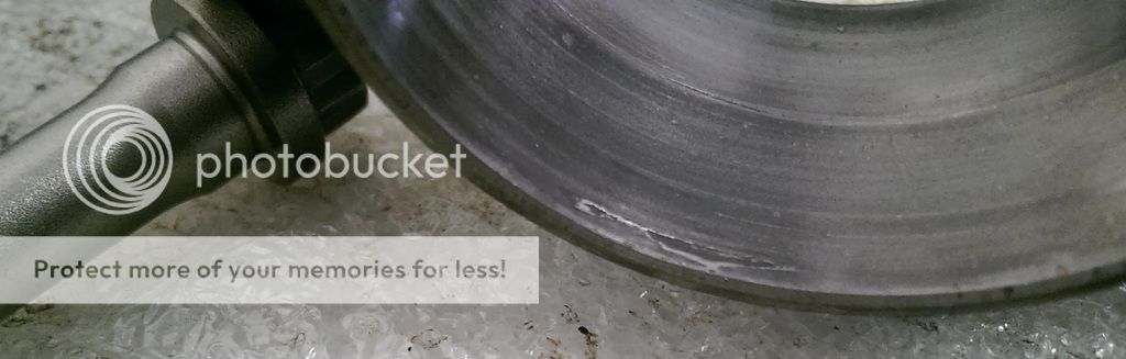

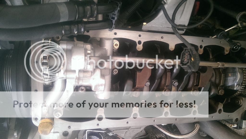

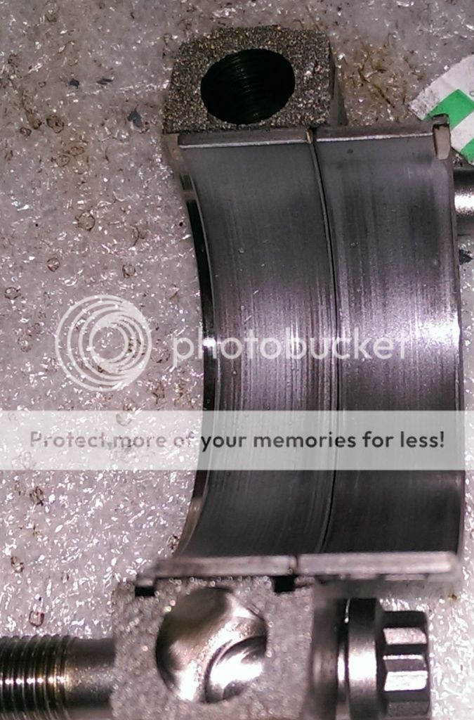

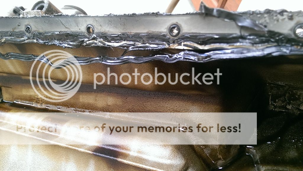

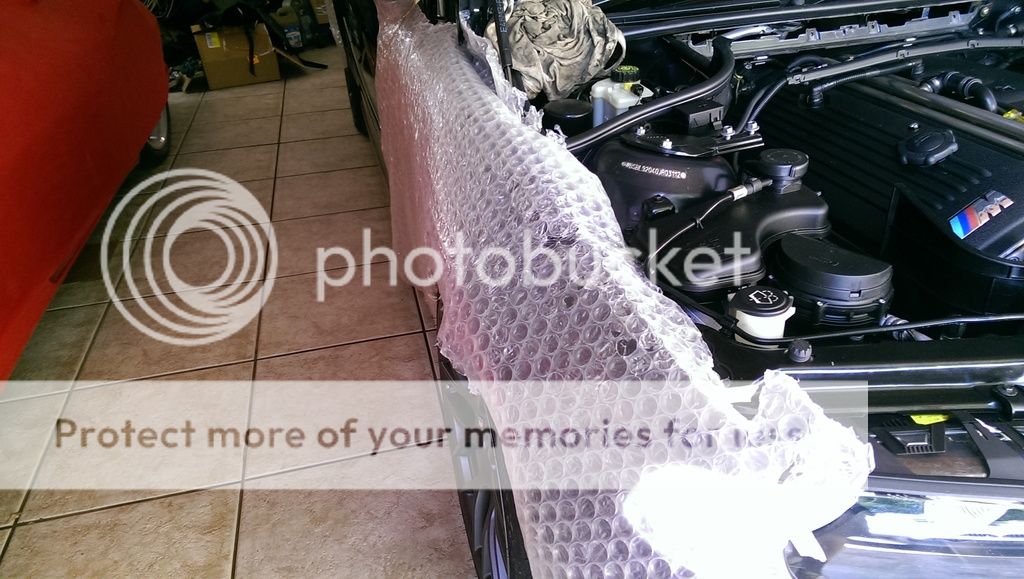

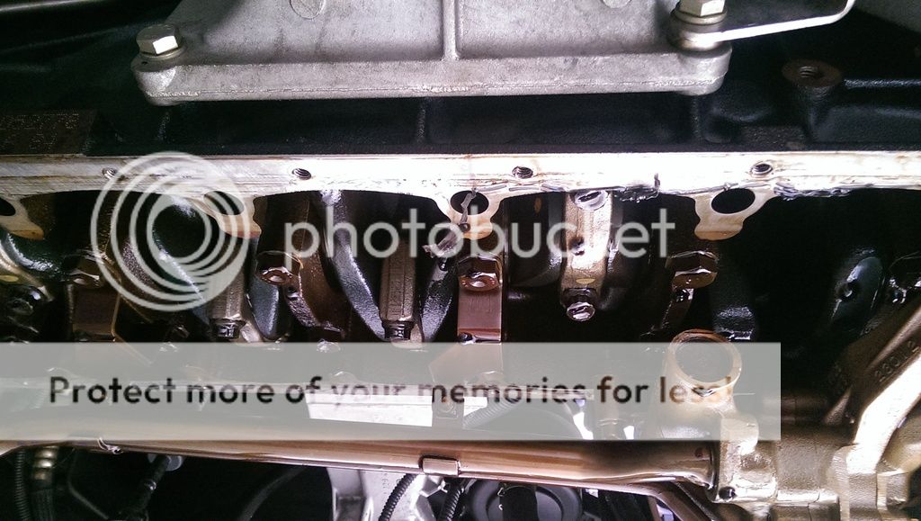

This is what I found when I stripped.
That is an OCD owner for sure.
How are those rims shod with Pirelli rubber.

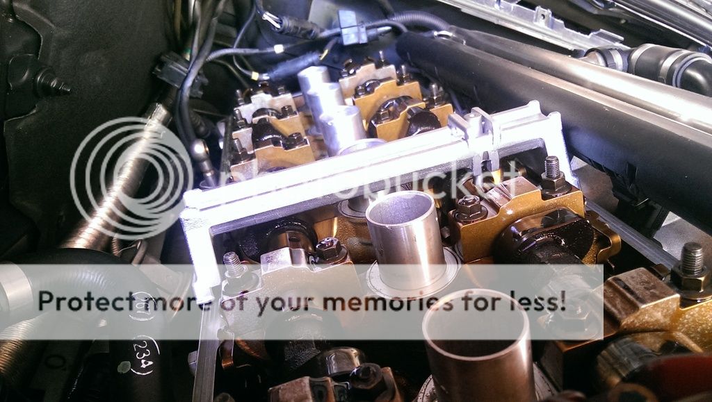

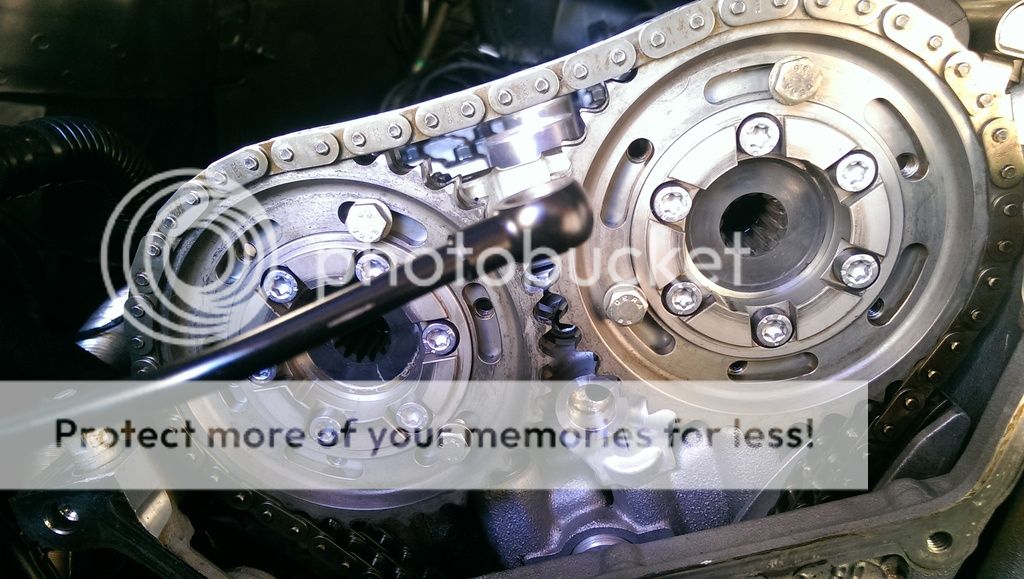

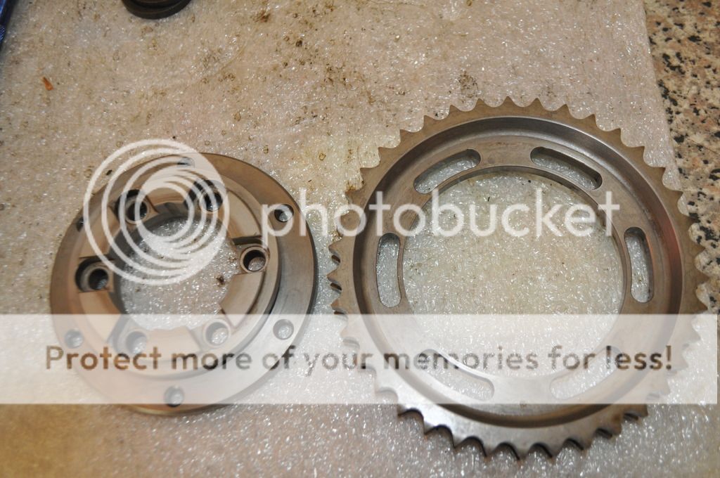

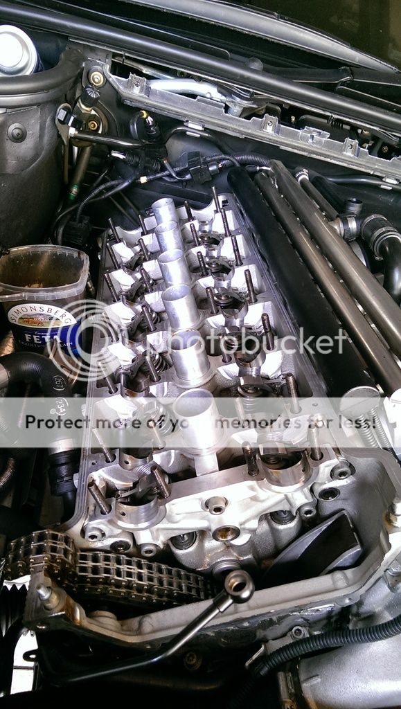

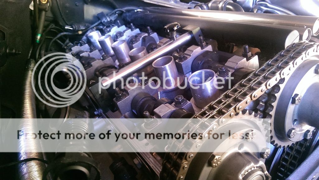

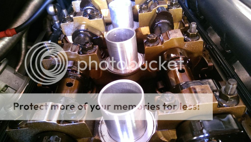

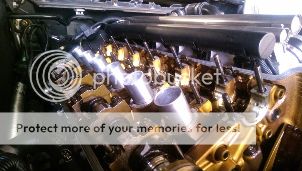

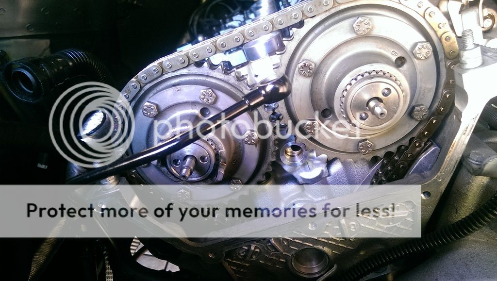

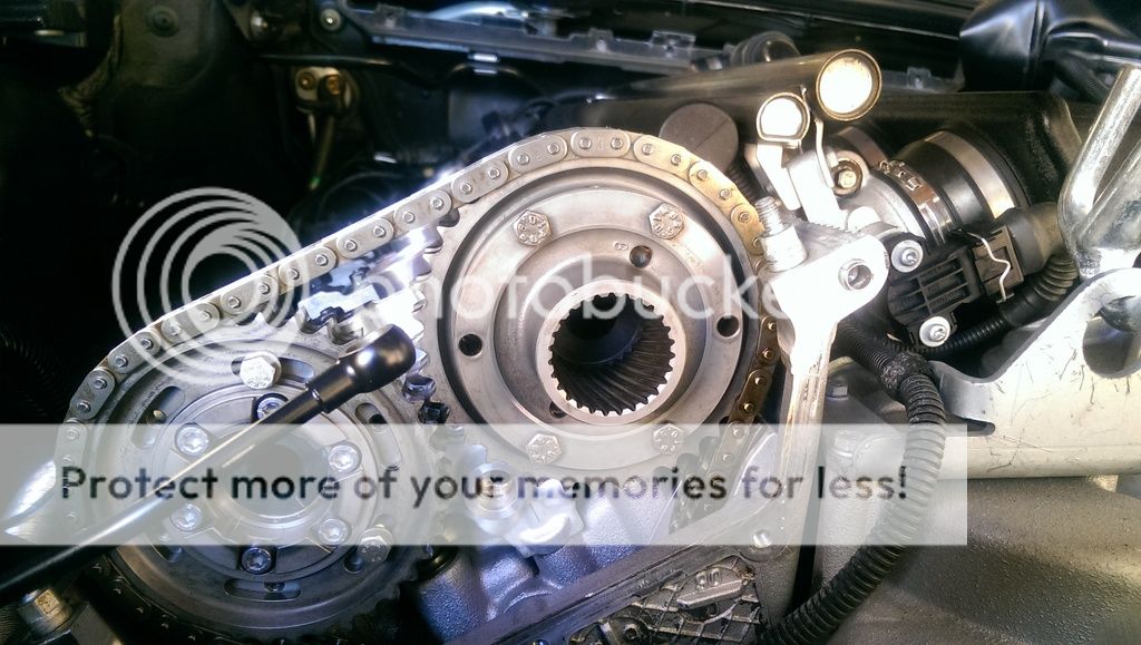

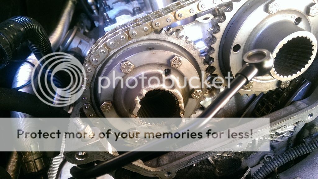

Cams were first retarded and then measured with the factory tool to establish position.
Both inlet and exhaust were out by a few degrees...as in 2 degrees or there about not 15.

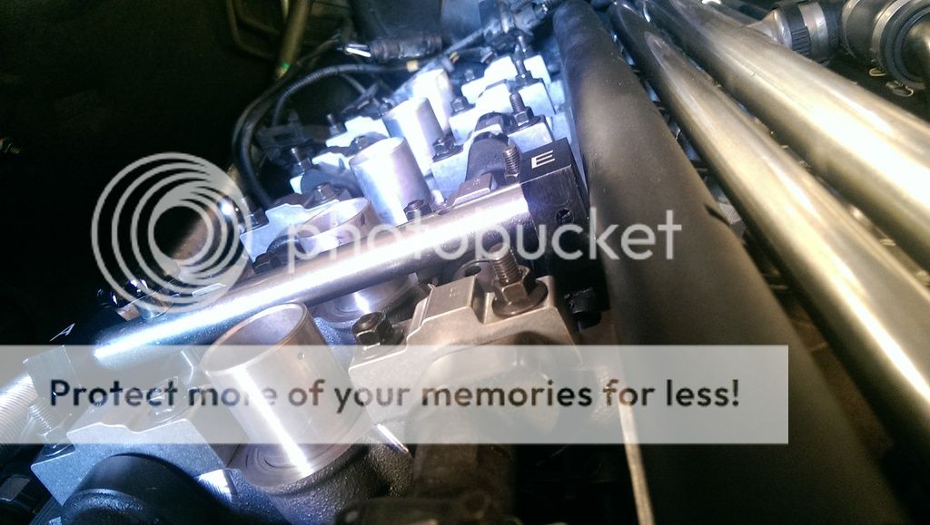

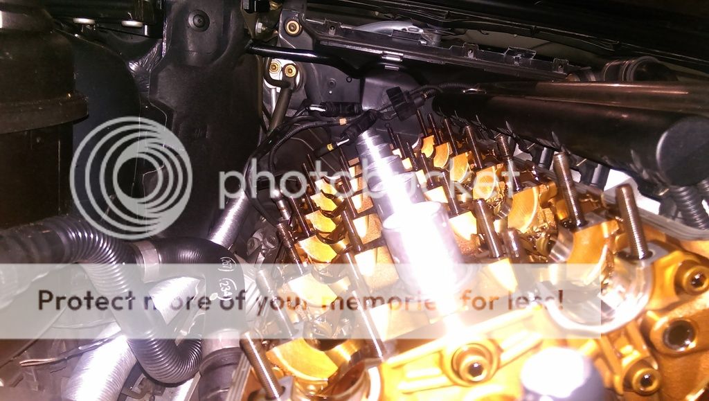

Once I established the cam locations I stripped them off so that I could clean the head.
