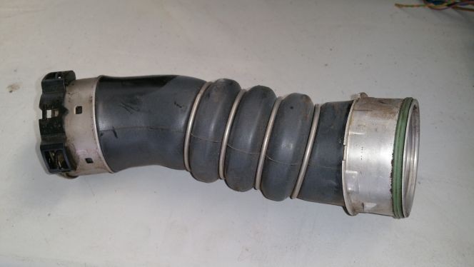

:thumbdo:BUT I noticed as I opened the hood, the “turbo pipe” I think it is underneath the airfilter cover, ribbed pipe has oil residue this I am sure is a problem? :blueCry:

The pipe i am referring that is covered in oil residue is below, and would it be a mission to replace the breather filter?

The oil on that pipe is normal sweating any diesel with over 80 000km has that build up. I actually hate the boost pipe setup on the Bmw's because of those stupid clips. Remove the intercooler, boost pipes and sensors and give them all a good clean.im not sure if you have the lci engine or not. If you have the lci engine i believe the oil breather was done away with. If you have the Pre Lci then the oil breather can be replaced, speak to Gert from OBD Worx, he supplies oem replacement for it:coolShake:
:biglol: I wish I was the DIY kind of guy, but maybe my mate can help out in this regard of cleaning the intercooler and boost pipe.
I have a lci N47 engine and am glad to hear its normal to have some residue on this pipe.
