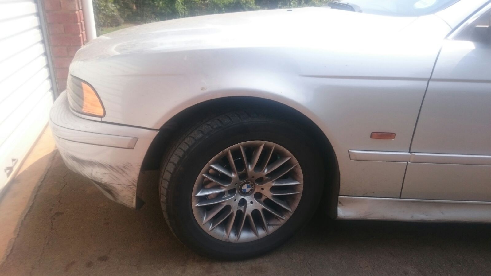

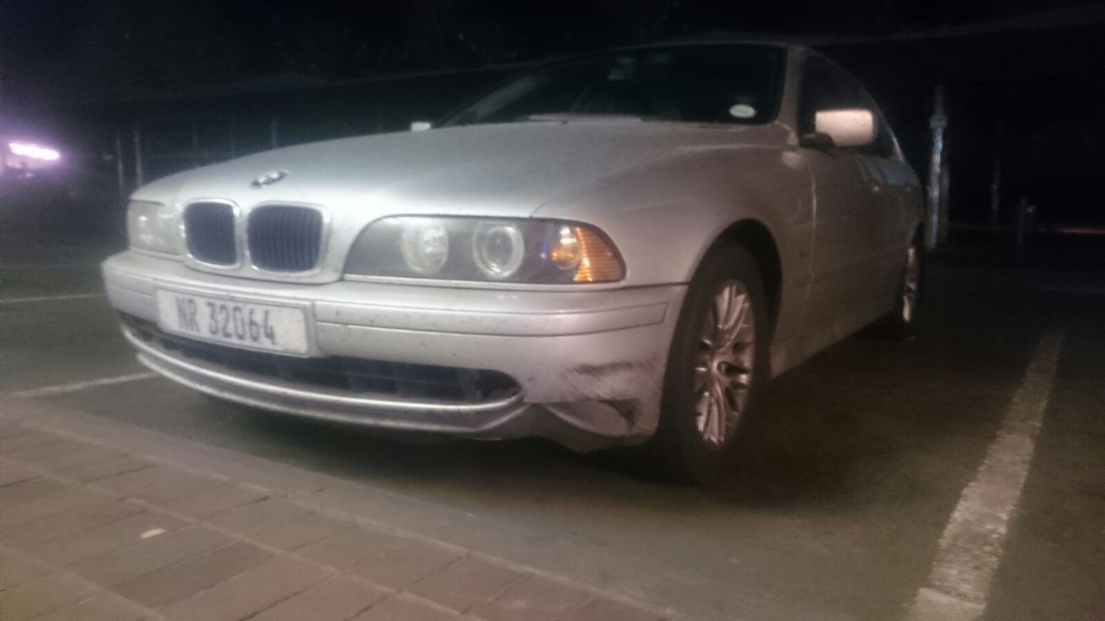

So I've just gotten back to Howick after clocking up 4300kms to Jeffreys Bay and back with the 5er... Had an absolutely fantastic trip and I really couldn't ask for a better vehicle to do long distance with... 1300kms in a day with no flaws and sublime comfort :inlove:

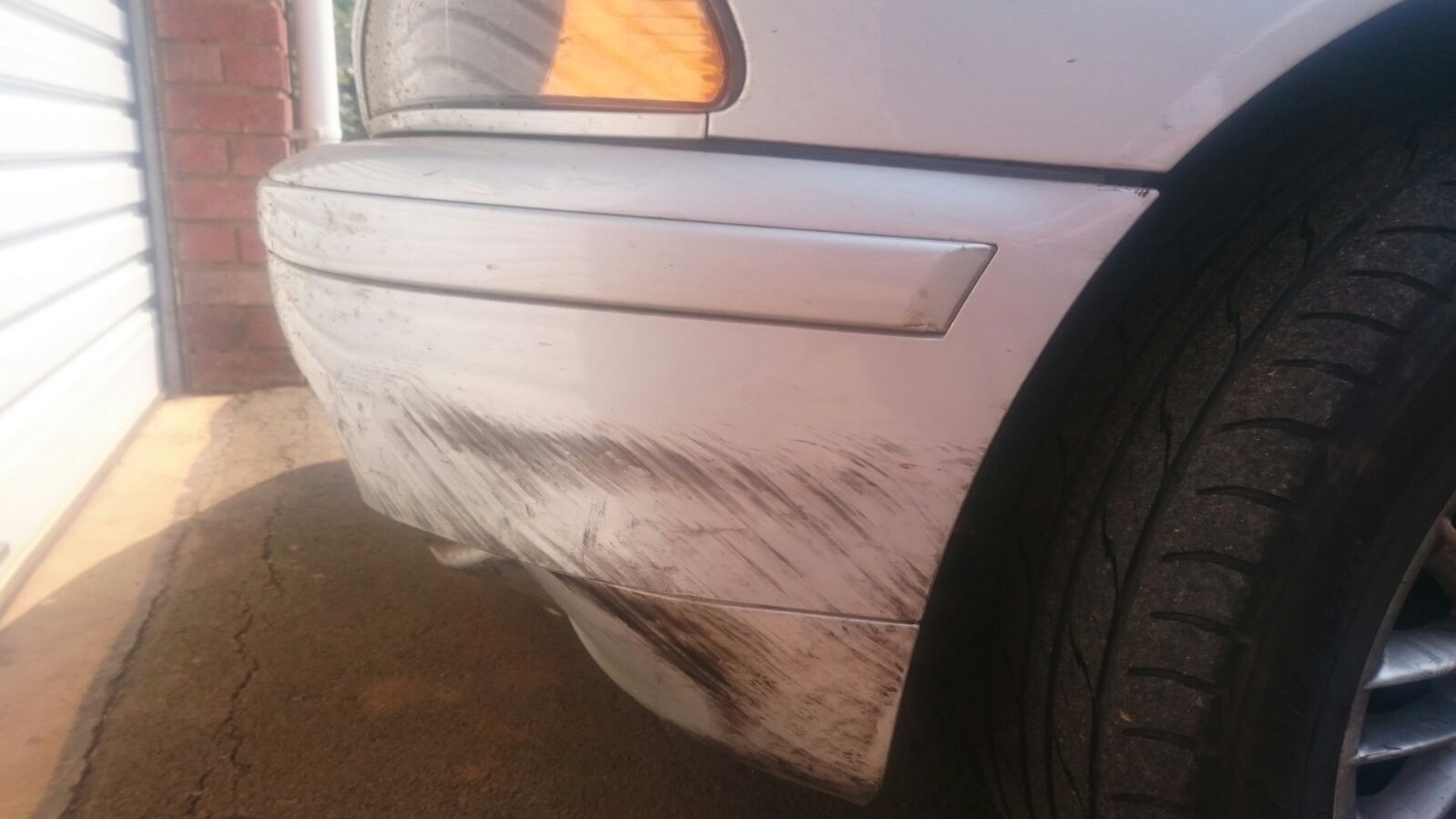

Sadly the trip was not without incident and on Monday night 100kms from home, just before the Estcourt UltraCity I met with a delaminated truck tyre tread which has done some damage :blueCry::blueCry::blueCry:
Thankfully the damage only seems to be cosmetic and the car drove perfectly fine and got me home safely. Meeting with an insurance assessor this afternoon so I guess we'll take things from there and hopefully I'm not without a car for toooo long :fencelook:

I get sad every time I see these pics :blueCry:
Glad you safe at least. These bloody transport companies need to be more weary of the conditions of the trucks they send their drivers out with. I see these tyre treads all over the place lately.
