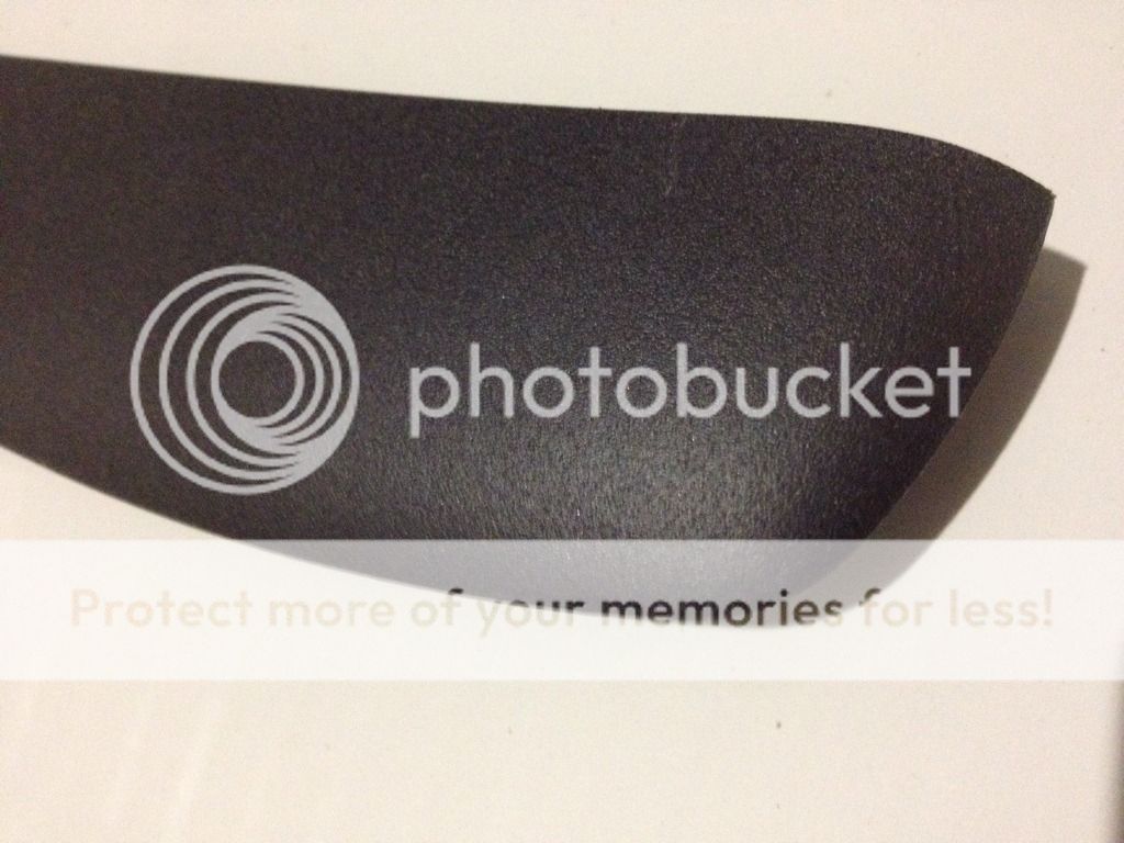

kabal
this is a close up of a test piece of plastic I did
4 coats black 30 minutes apart and 4 coats clear 30 minutes apart the next day.
the clear pretty much did nothing with regards to gloss.
using pre soaked 1500 git wet paper significantly improved the touch, and would most definately not skip this step
the vertical line at the top right is an intentional high pressure thumbnail scratch. this stuff is very durable :thumbs:
