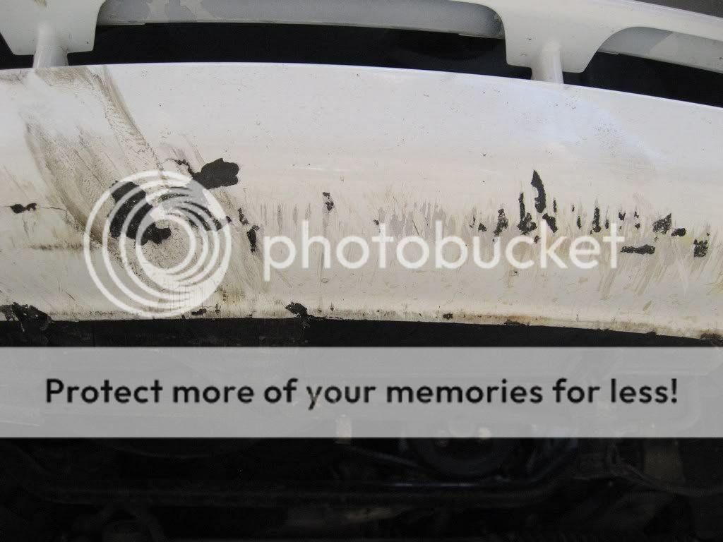

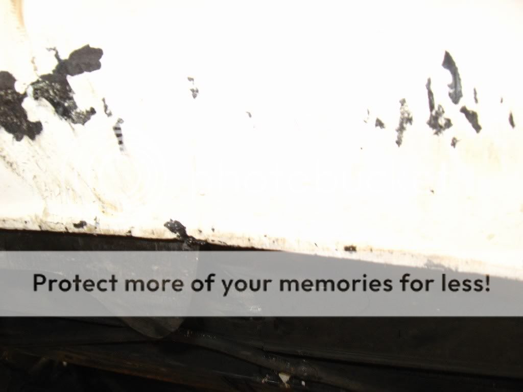

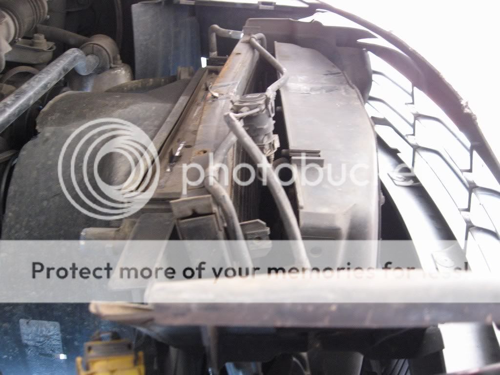

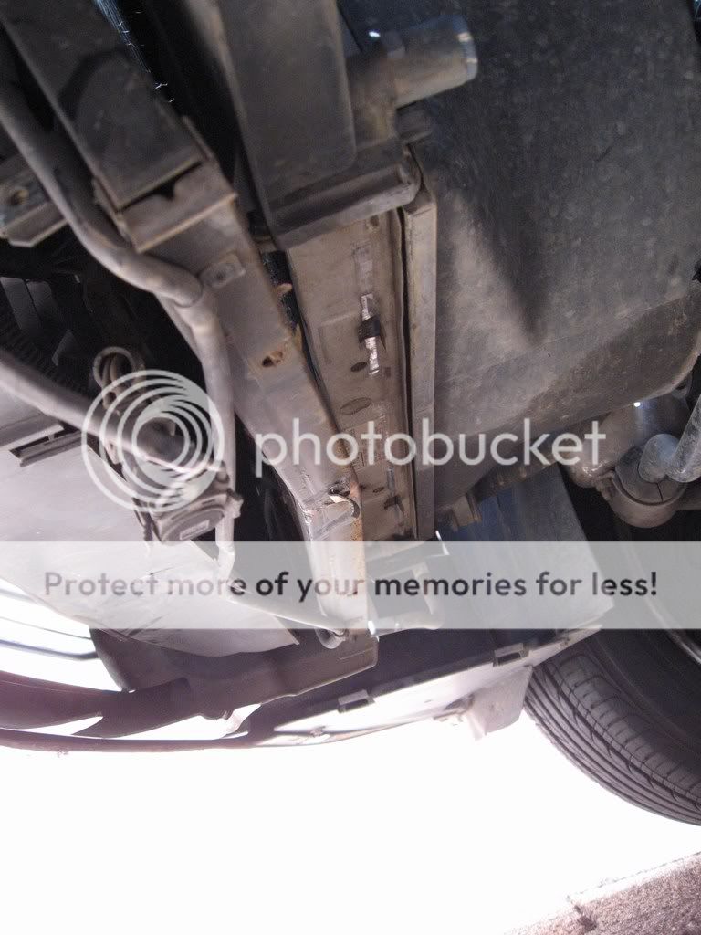

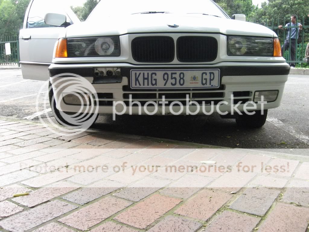

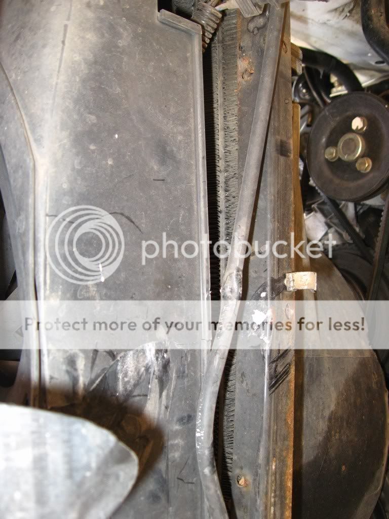

Guys I had a small crash today, avoided the other car but ended up on the center curb. Not too much damage. The bumper is scratched and cracked in a few places. The Radiator seems like it has moved slightly backwards. The front radiator (seems like a thin one in front of the main one) has been bent back until it touched the back one. There is a metal pipe that goes across the bottom of the radiator that is bent & squashed.

I was in the right lane turning right, He was in the lane on my left also turning right, just as we are almost turned right he decides he wants to be in the right lane and just comes across.. So I brake, swerve to the right and decide the best place to go is up the island instead of into the oncomming traffic.. Managed to stop just before the robot pole. Unfortunately there was a 5cm high pole or something sticking up out the ground on the island that did most of the damage.. :(

it doesn't look to bad
your radiator sees fine , but looks like the condensor is damaged.
the pipes are for the AConditioner - the Expansion Valve looks like it took a knock.
is the a/con still working -did any gas leak out?fan okay ?
if it's still okay - maybe strip the front out and bent it forward to check the radiator - chances are everything is till okay.
but i would suggest a pressure test on the radiator -even of there is no leaks-just to be safe

bro, thats very small damage, might be easier to just fix it yourself hey .. send the bumper off to get re-painted and fixed. replace the bent parts from scrapyard pieces. done.

From what I can see in the pics, it looks like your main radiator is still fine, its the aircon one that was pushed back.
If you take off the pumper and send it away to get fixed, I'll help you swap out the other bits.
Take a good nice look at the main radiatior if you can see any damage,
I assume the aircon radiator has got an electric fan mounted on front, how is that one ?
Did you bend the center support chassis strut ?
At the accident scene, did you see any coolant dripping/leaking onto the ground ?

The main radiator still looks fine to me, no leaks or anything, still drove the car for 20 minutes home and temp gauge did not move off center..
Did not try the aircon, as I did not know that front one was for that.. Will check later..
Will check the center support strut today as well. If i can find what it is :)

Just checked the car a bit today. Both fans are working, except the main fan touches the shroud when the radiator moves.. The aircon is also still working fine.. So I might be lucky and just need to get stuff secured again(replace clips etc)
