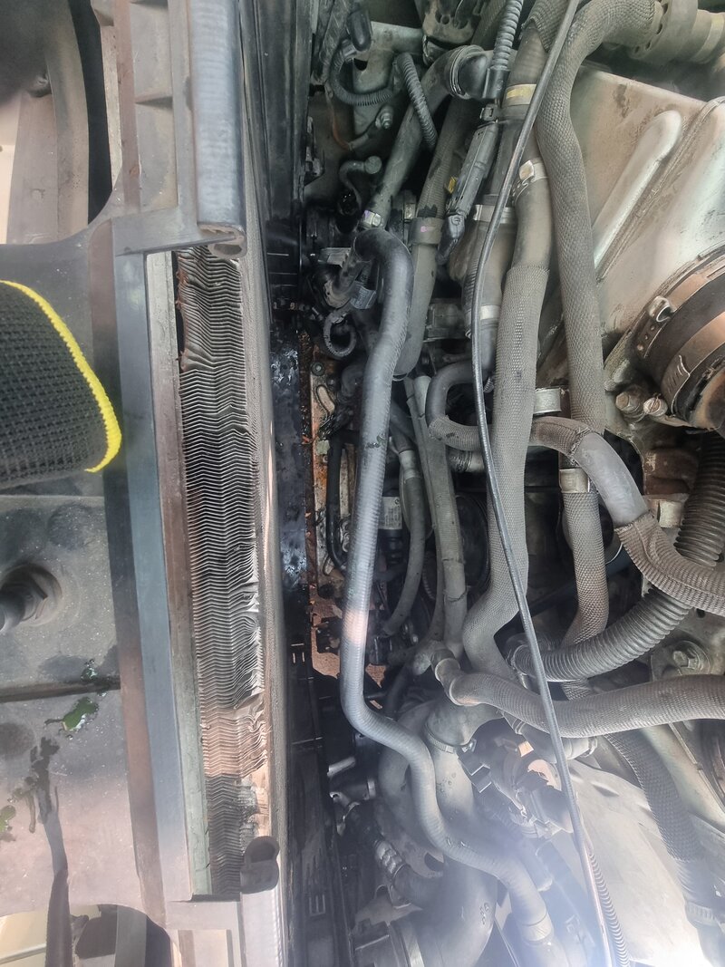

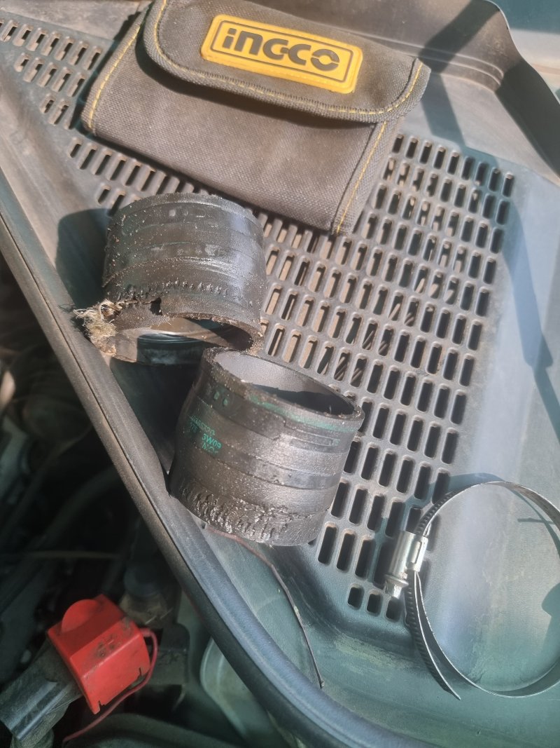

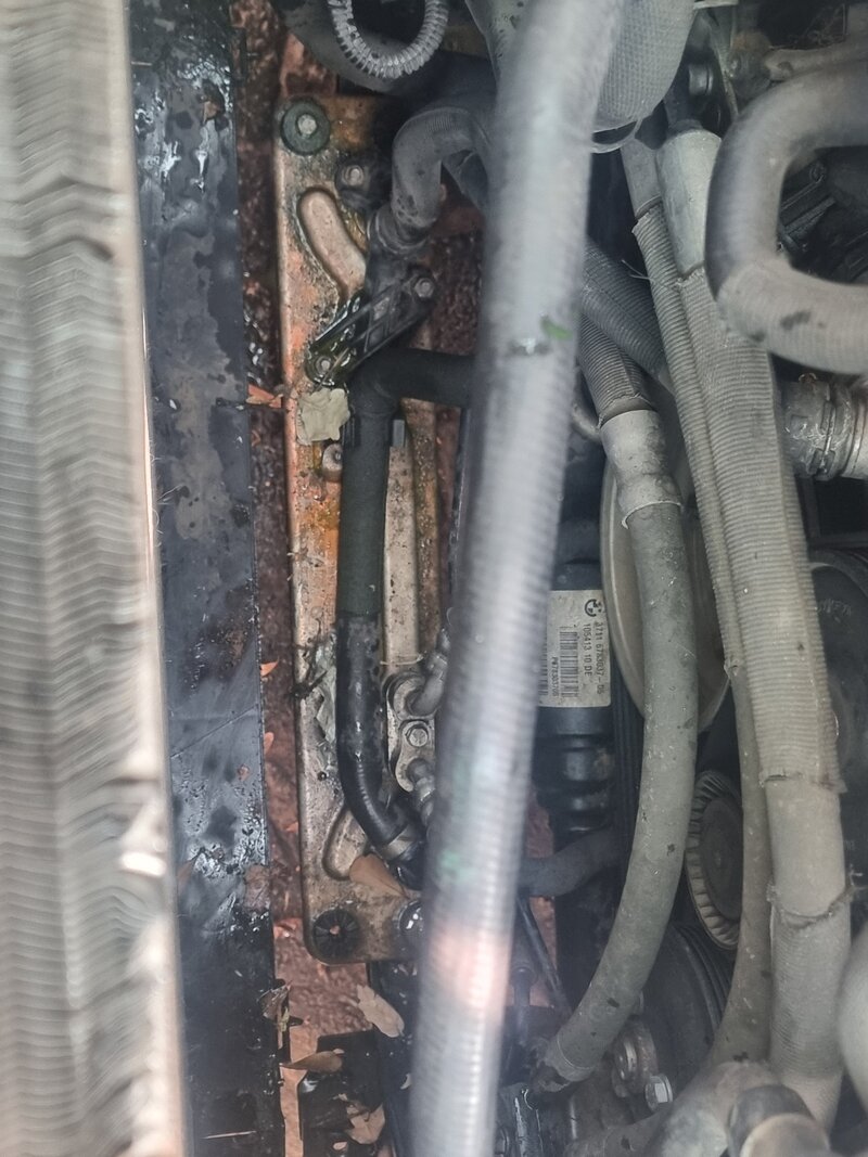

Mine had this alarm , of which i still have (Battery need to be replaced now). Do you have the correct ( think 105MAH ) battery, it can also give this alarm. I just need to check but i believe it is the first time the regulator was replaced, milage at 185XXX now. These alternators work hard because of their location, evidence of this was how the cowl looked like when i repaired the snails. Brushes were gone on mine. At agents i paid just below 3K, other auto electrical companies quoted me +/- 1.6K for a Valeo unit but could not source me one. GW only have the complete alternator.
