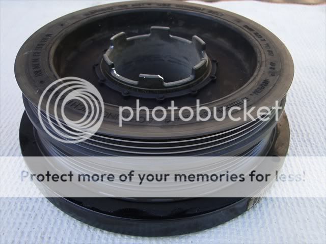

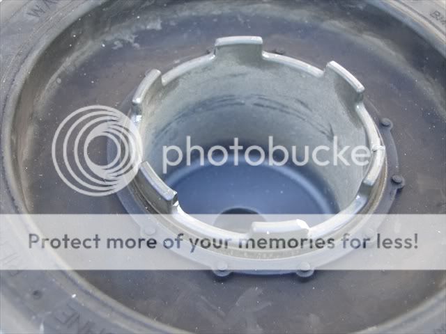

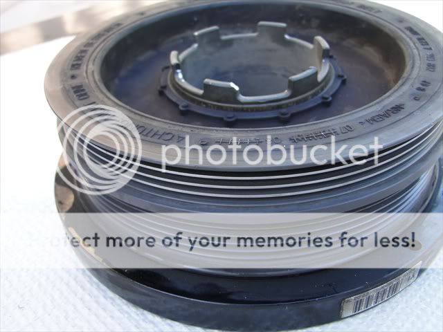

Ag i meant "pulley"...sorry for giving you a fright....:)....i replaced the pulley on my 120diesel a few months ago...pulley was loose and got chipped & cut into belt as well. Don't ask me where the pulley is in relation to the flywheel - i draw a blank....Here are some pics:

That is the vibration dampner pulley on the crank. (It sits on the front of the engine, the flywheel is at the back :) ) The powersteering and aircon run from this pulley. Also a common item to break on the E46's.

i would put bets on it being the pulley.. as hellas said its a very common fault on the diesels for some unknown reason, and i have personally seen a few fail.. :dunno:
netercol
from what ive seen the rubber part lets go, sometimes causing the pulley to wobble and touch on the back housing, and in extreme cases even alowing the inside part that bolts onto the crank to rotate independant from the outside!
hopefully its not that though.. this part is crazy expensive from the dealers, e46 one was 5k, dont even want to think what the newer ones cost

The rubber part in Twinz's pics looks very good. I just wonder whether those chips can really cause all the trouble. I'm not doubting you here Charles, I am just under the impression that those 'teeth' are used to fasten/turn the pulley into position as it is a bolt down the center of the pulley that actually holds it in place. The teeth stick out the front and are not connected to anything.

But i would not have the faintest idea. BMW replaced it and gave me the broken pulley and the car ran like new again.:thumbsup: The car was very noisy and squeally/squeaky before the fix.
