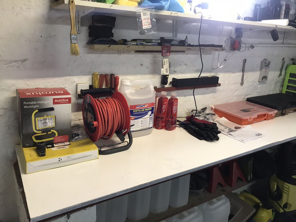

Here is the engine cleaner I used. I also used the blue one which is water based. The red one in this pic is solvent based.
