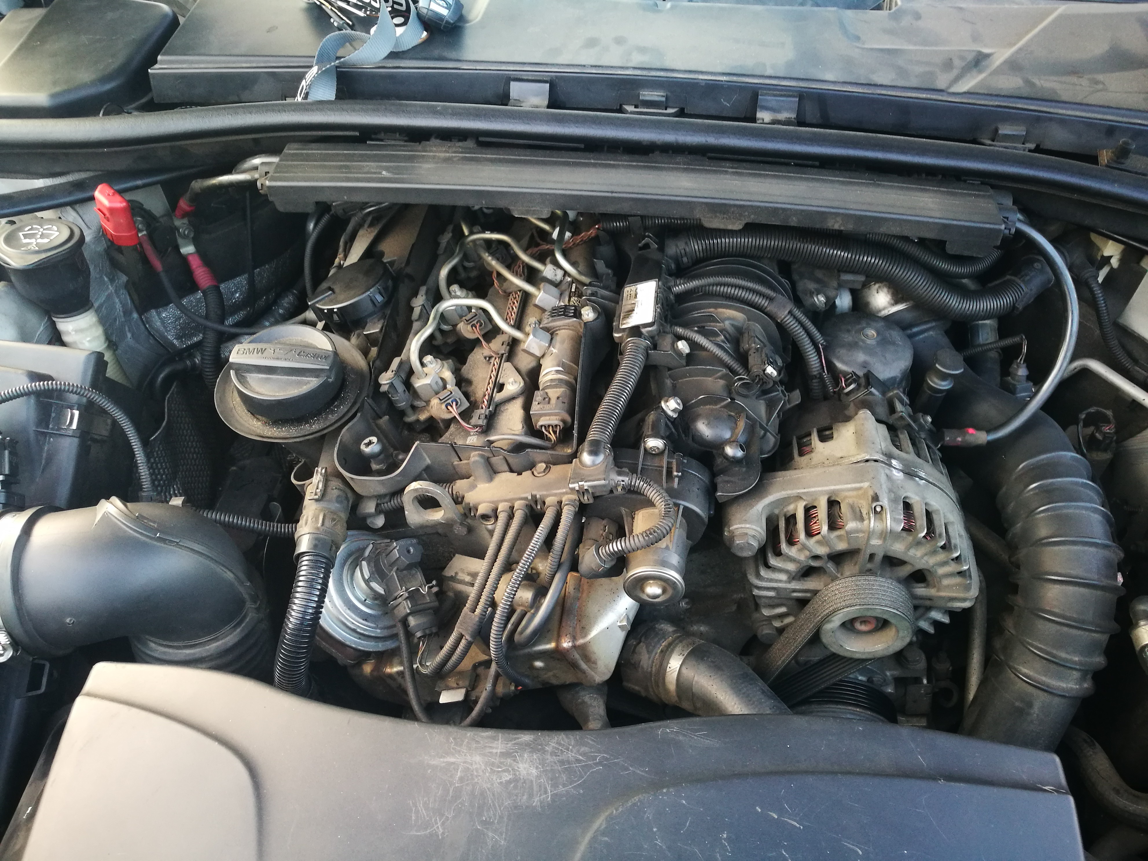

**UPDATE**
Hi guys,
Just an update on this, so the vacuum lines have been changed and the boost pipes checked and inspected for leaks. The issue is still there, the Mech says that they are getting an error on the diagnostics indicating that there is too much air passing the MAF, however they are still investigating.
So the hunt continues...
**NEW UPDATE**
Just got off the line with the guys, they have advised me that everything mechanical checks out and suspect the software is an issue. They have arranged for this to be addressed on Monday.

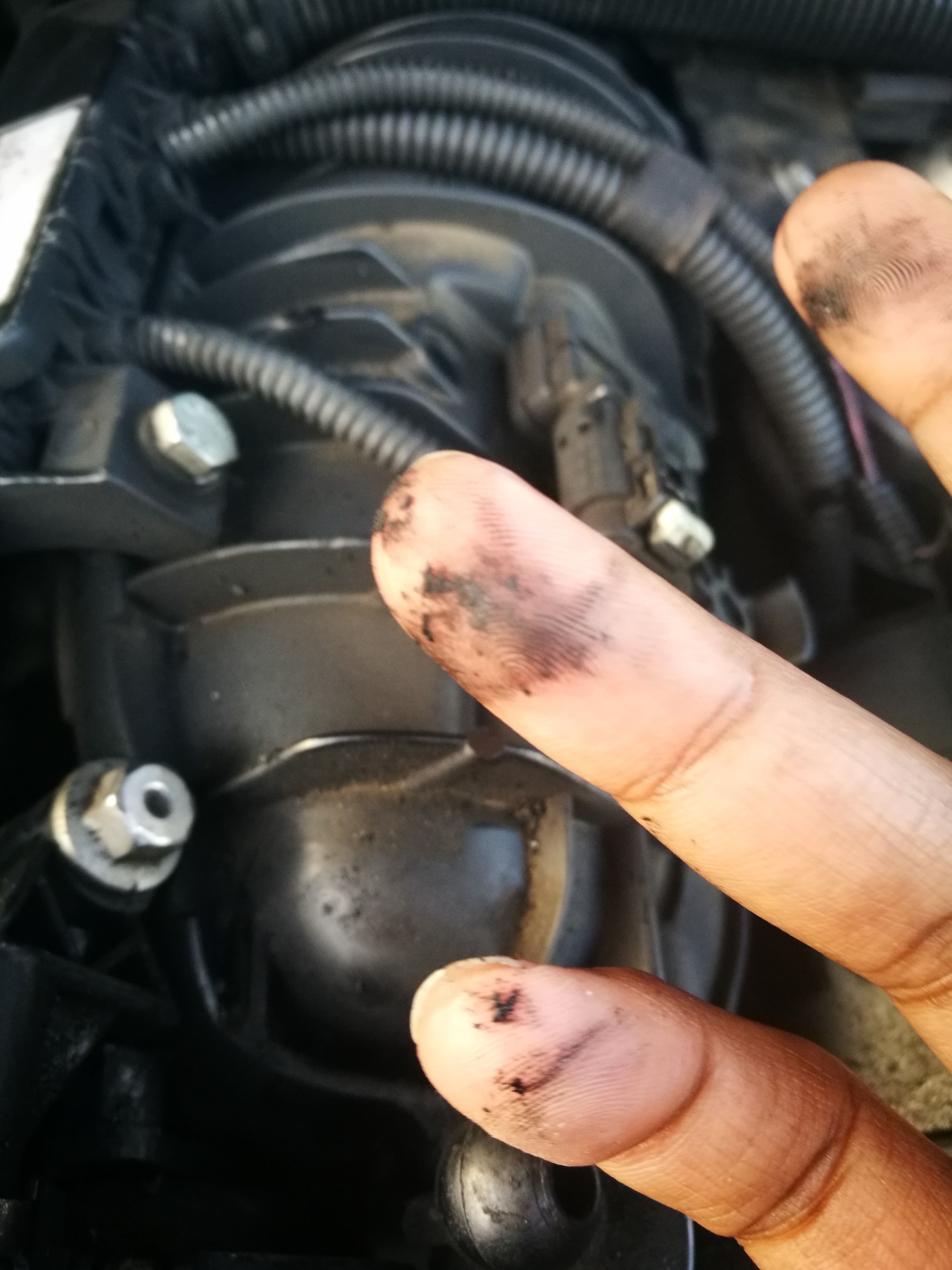

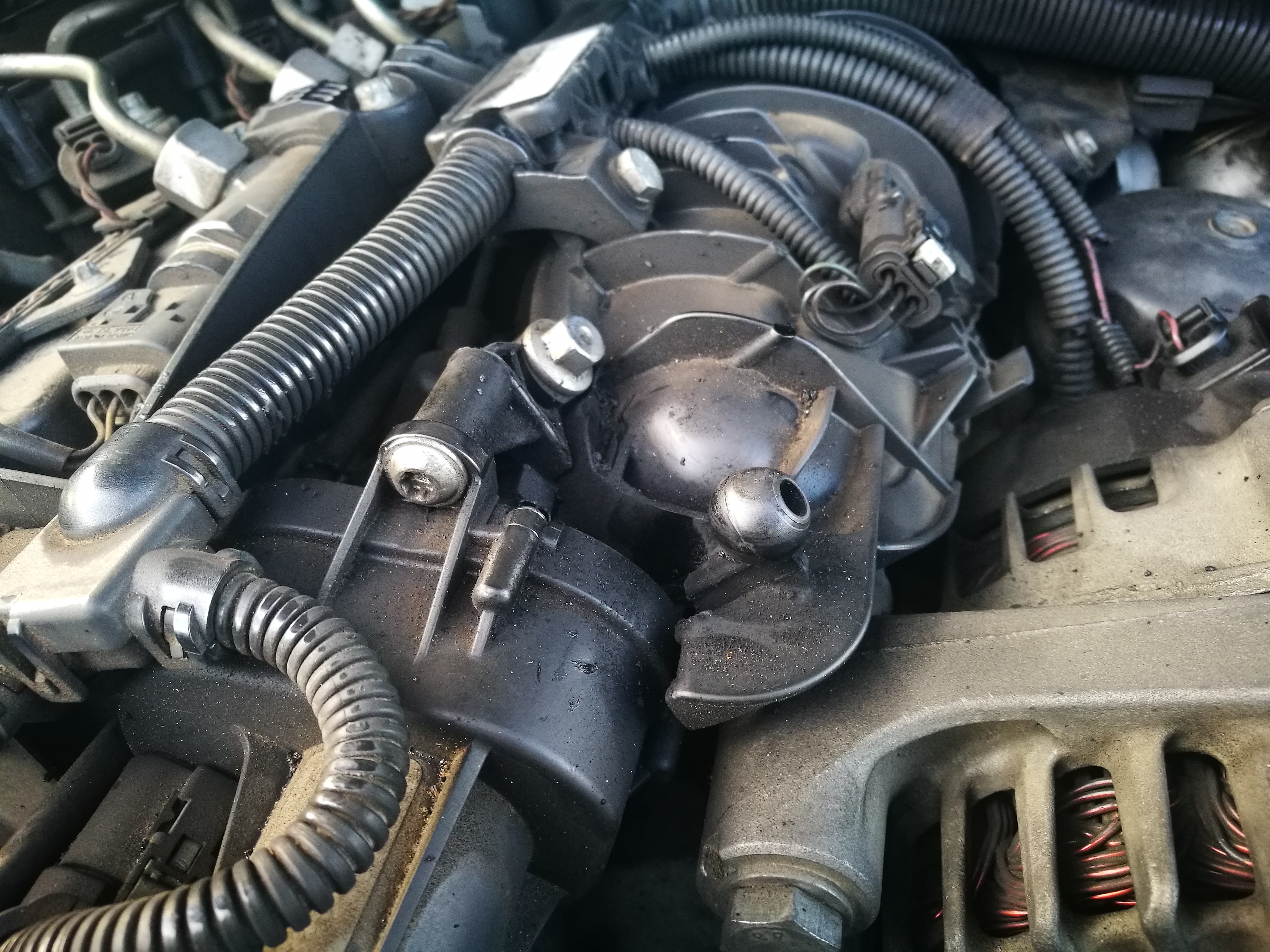

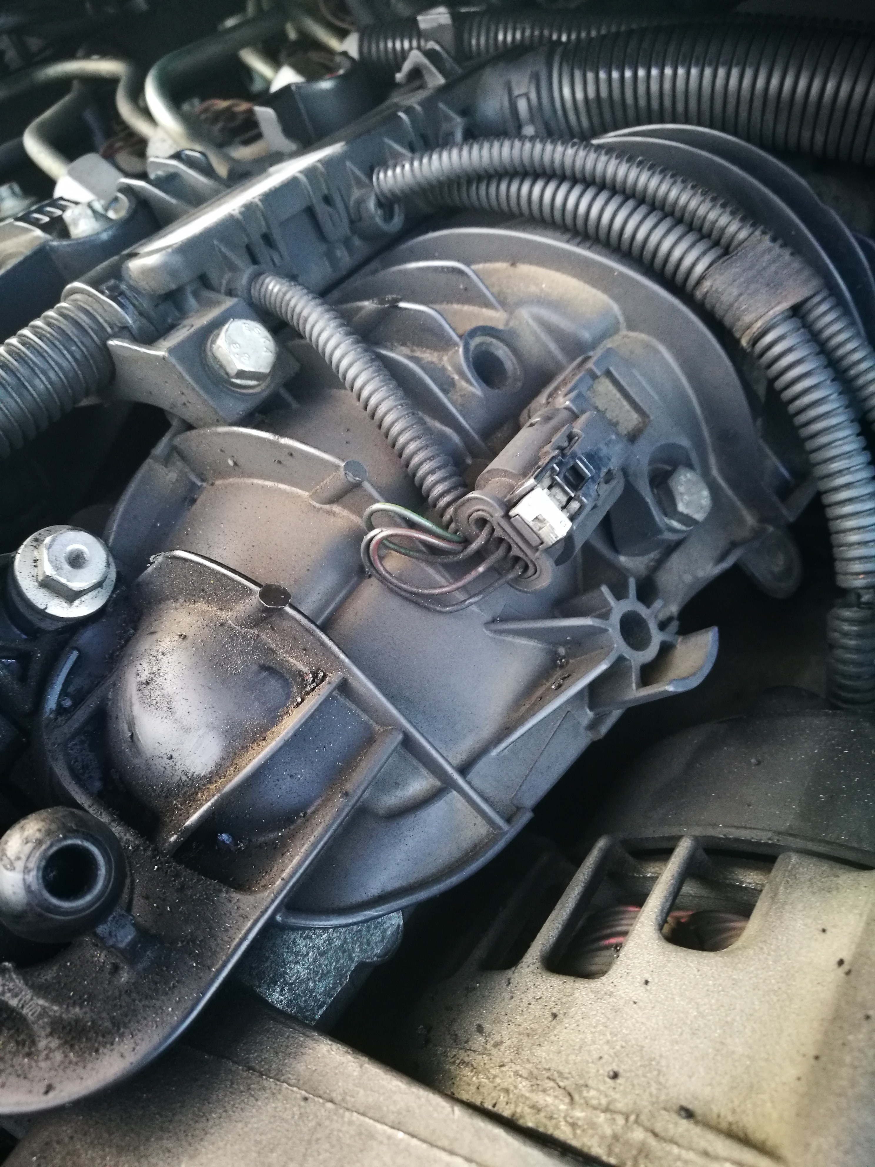

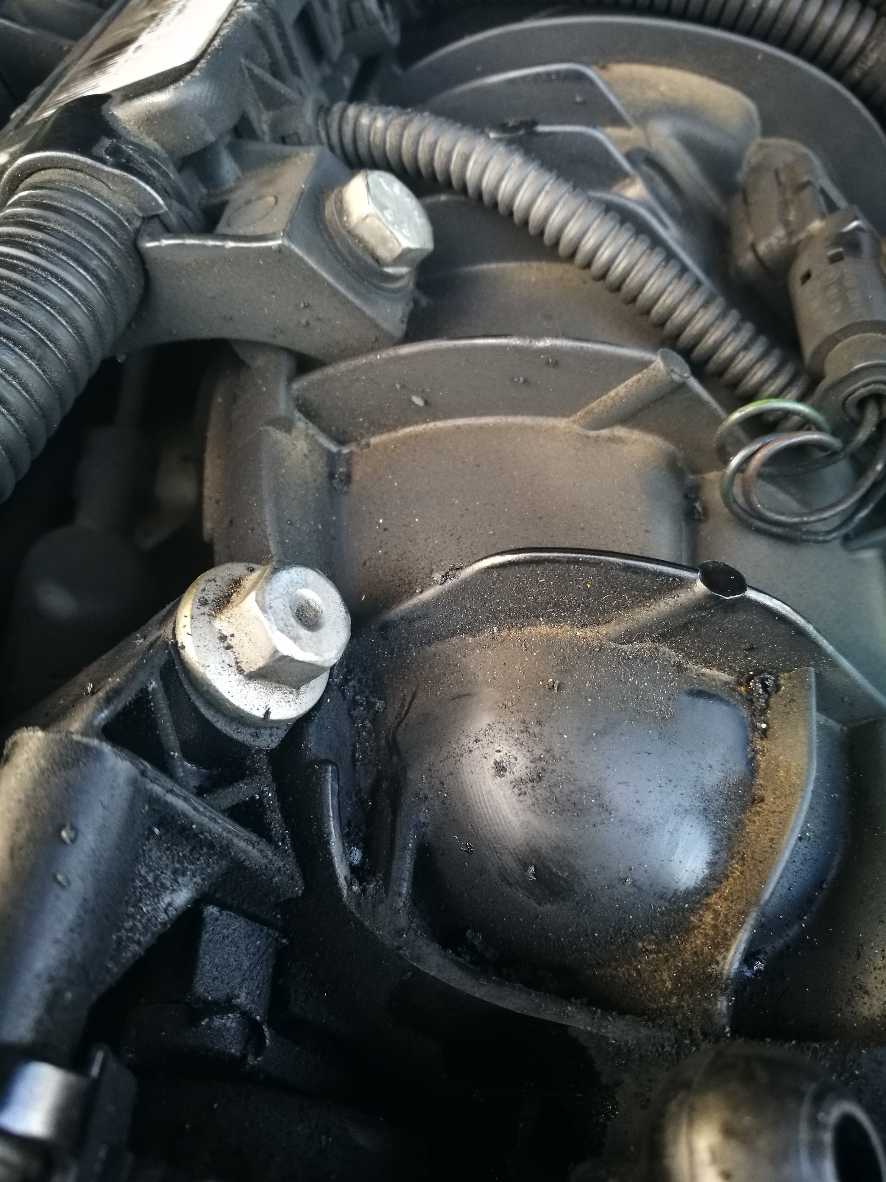

Good Morning Guys,
Compliments of the season to all of you and your families.
We are making some progress with this issue, davelo mentioned that he has an issue on the intake and it turns out I am experiencing the same issue. So I am in for a new intake and hopefully will be back to normal.

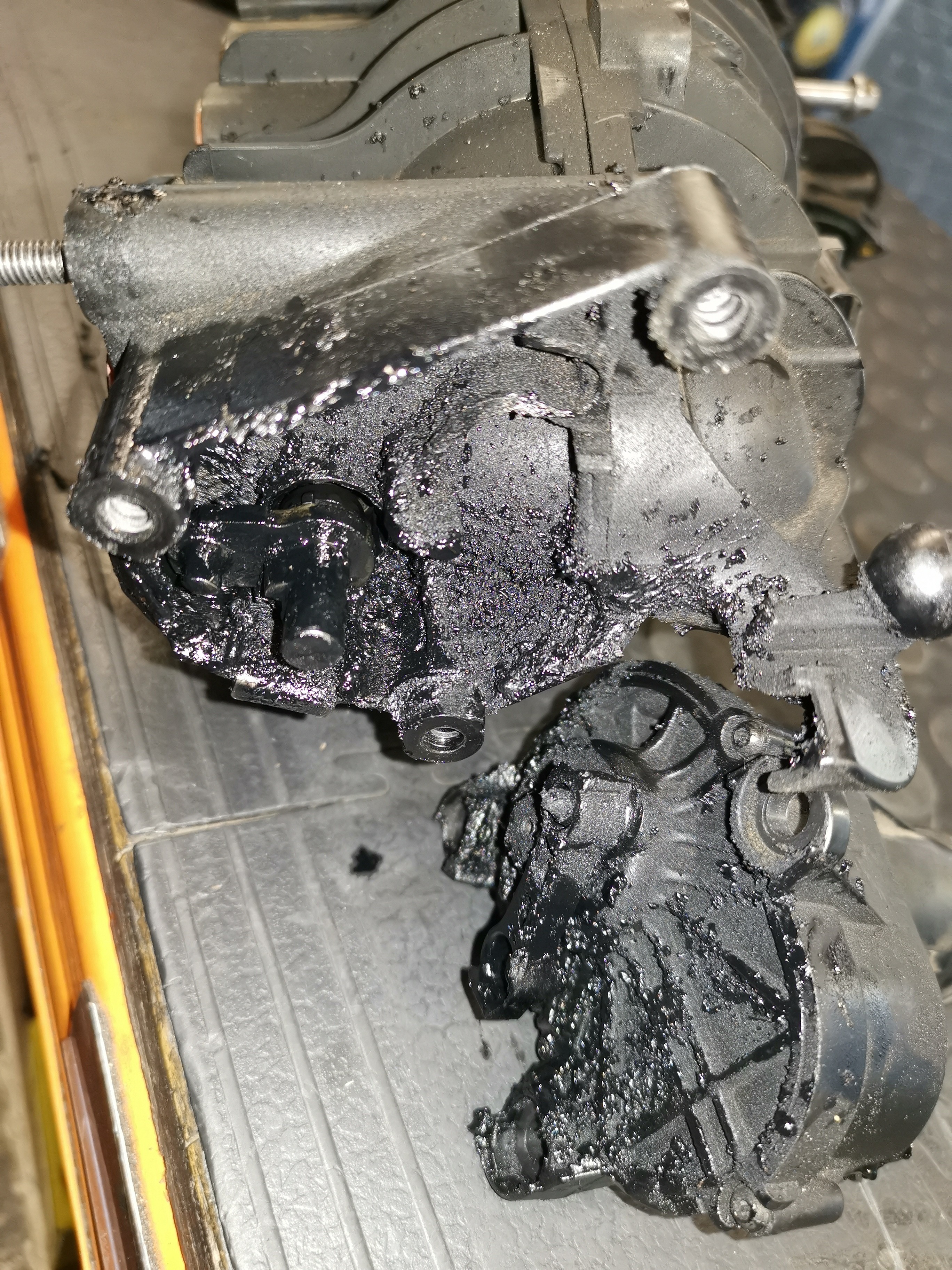

naren512
Good Morning guys,
Just a final update, the issue has been resolved. A complete new intake has been installed (R12 500) and the car is back to normal.
