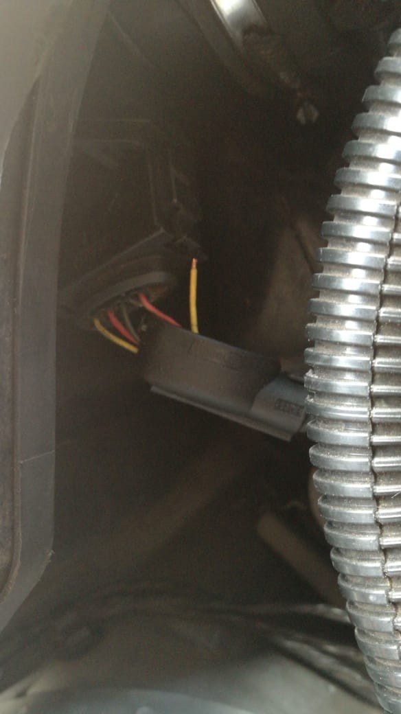

Petrie
Hi all, have found the issue, and it resolved the Miss i have had.
Connection connecting to the Airflow sensor.
