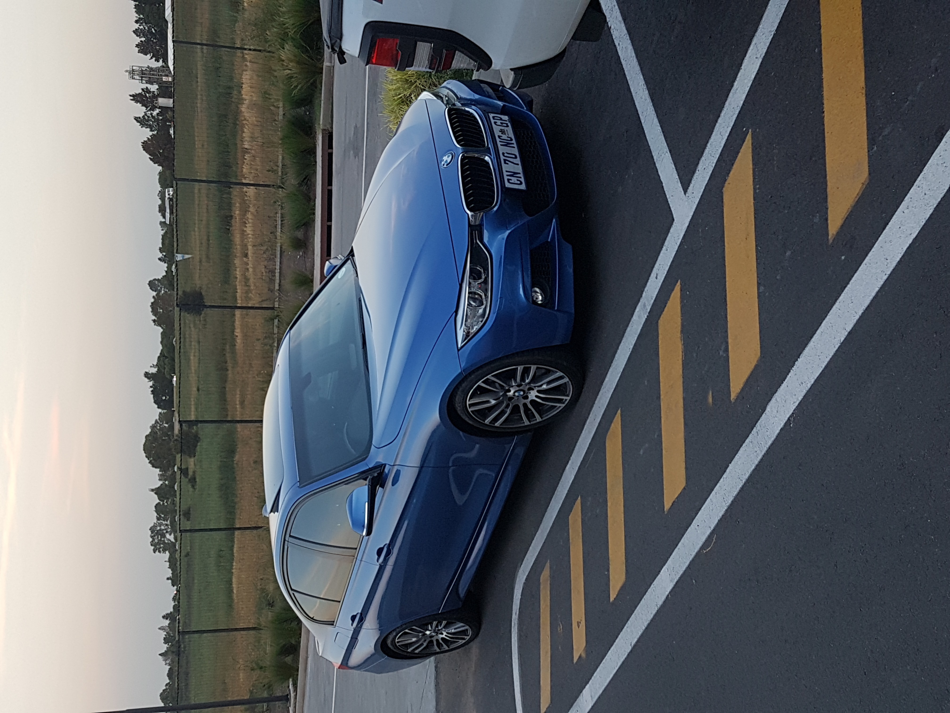

cutmanC40 said:
I hope i got that right.
I have a few questions, what options are there to upgrade the standard sound system, is it possible to change the speakers to better specced one's or do you have to install an amp then is third party software / chipping worthwhile? Does this affect the cars reliability and cause damage long-term? My car seems to have little niggley rattles in the doors and another F30 owner told me his is the same, anyone else with this problem and if so how is it fixable. Is it safe to use the Eco mode in traffic or is that more for highway cruising or is it generally a bad idea? Thanks in advance.
