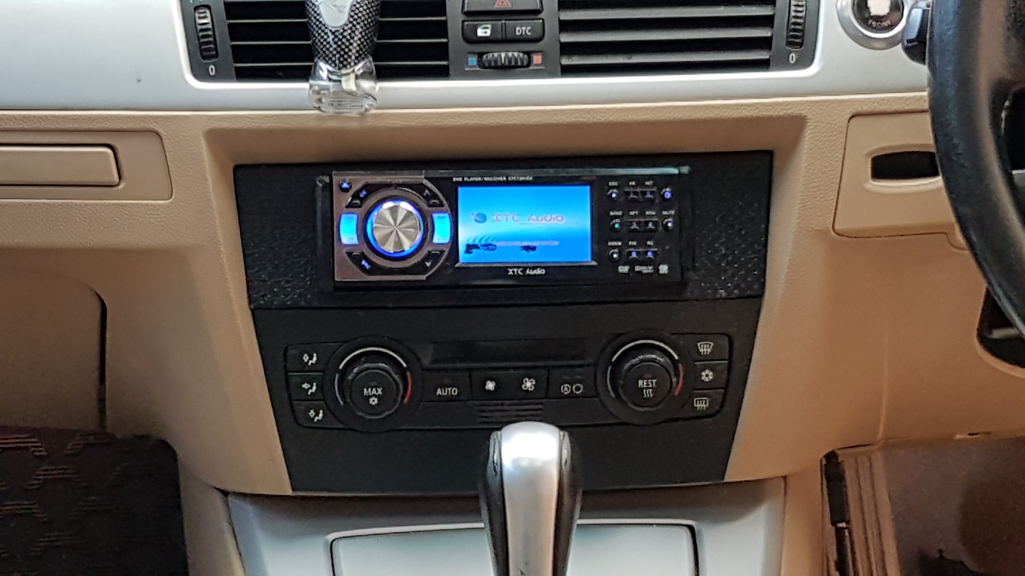

I see there is an issue with your sound also, do you have sound in the car? 2nd error from the top.
