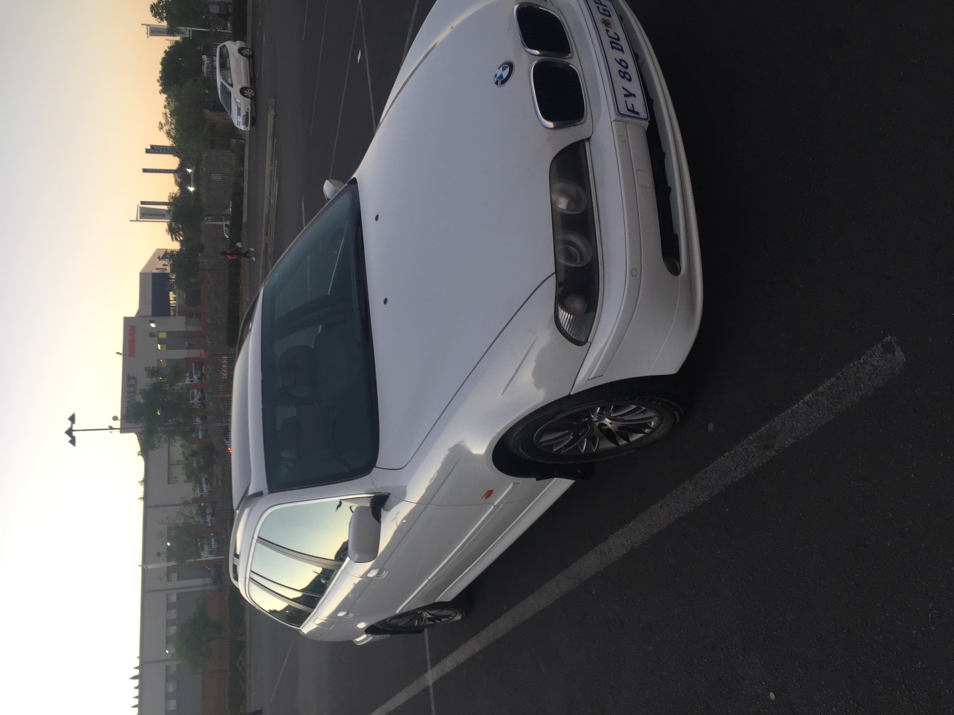

I'm a new BMW owner and i love the brand , i have a problem , when i went on holiday my vehicle had a problem with the charging system and the alternator was repaired after a about 20km driving the ABS light , Traction Light and Automatic transmission lights came on , the vehicle is no longer changing gears as normal and on take off it sounds like its taking off on a high gear , can anyone assist on this ,

Beautifull !!:praise:

Welcome. Car looks good bud
