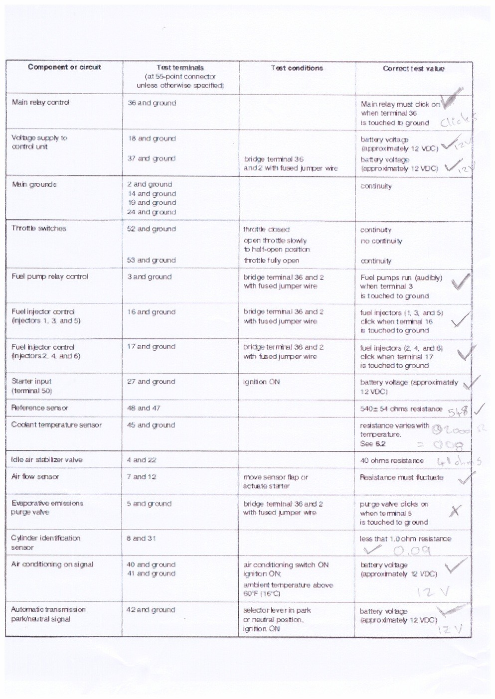

I had managed to start it , found that the Alternator regulator wasn't charging , replaced the voltage regulator , tried starting it and it started showing that it was now indeed charging , closed everything up , and then it wouldn't start , opened everything up again , checked the ECu relay , replaced it , and it started , Now closed everything up from under the drivers side , and it wouldn't start again.
I tested the wiring loom to the ECU and these are the results below . (THE ecu was disconnected ) I just probed those pins .
I don't now how to test Continuity ..... I have a normal ohmmeter , how do I test it? Where do I point the needle? If I put a probe on 2 14 19 24 . where do I put the other probe?
Also im not getting any reading by touching pins 5 and ground , non at all , what is Evaporative emissions purge valve?
My car has a motronic 1.3 ECU so , it is possible to read codes from it though I dont have the correct cables
Someone help ..
