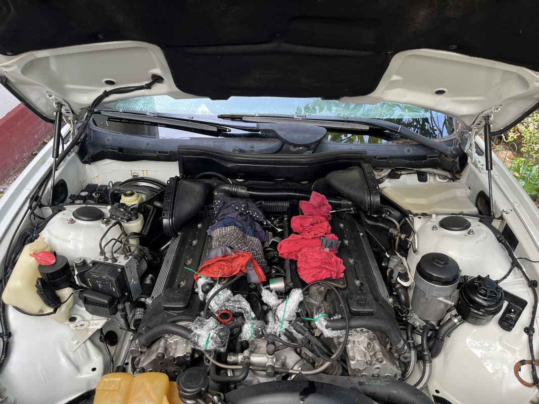

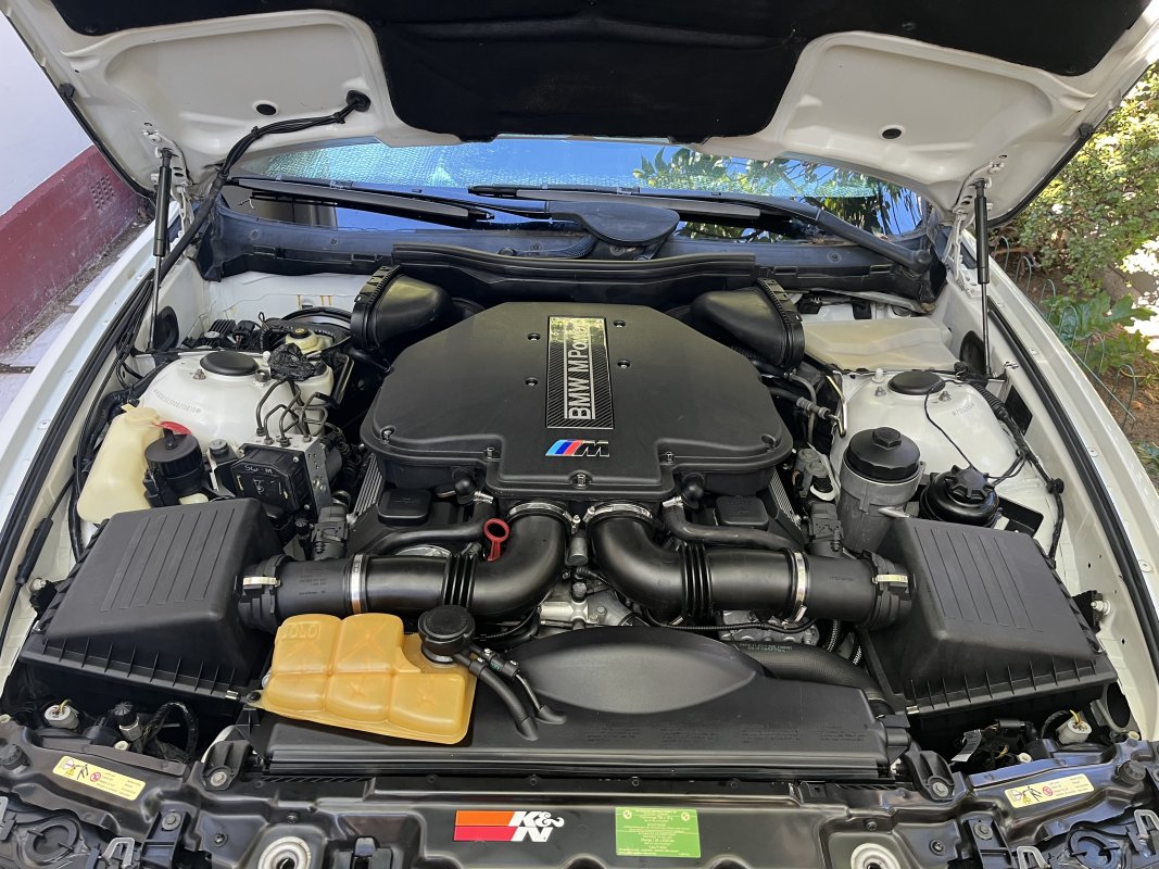

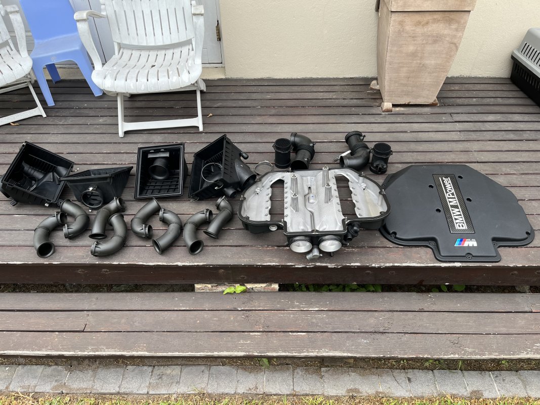

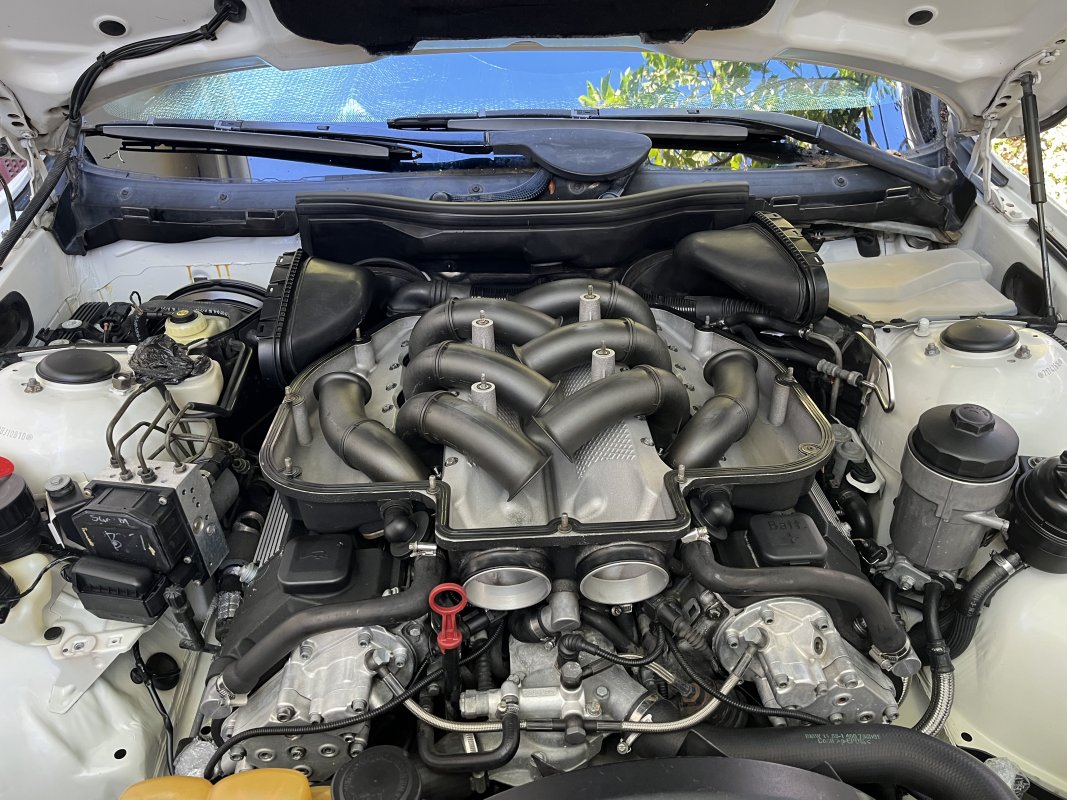

This was all done, while I was busy doing the service on the car and putting it back together.
The car started and ran fine.

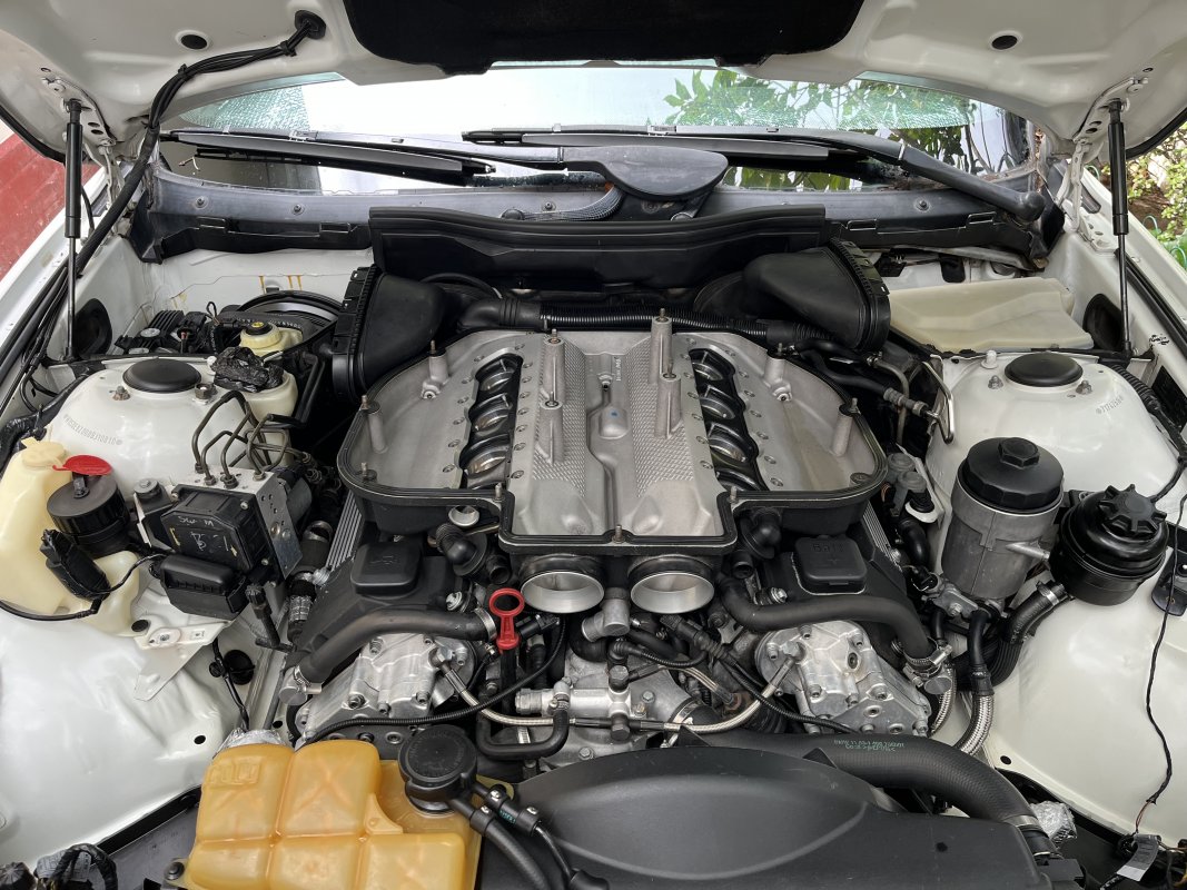

I finished up all the cleaning, putting back together and servicing, started her up....
Rough idle, and dying......
Double checked everything, everything seems fine.

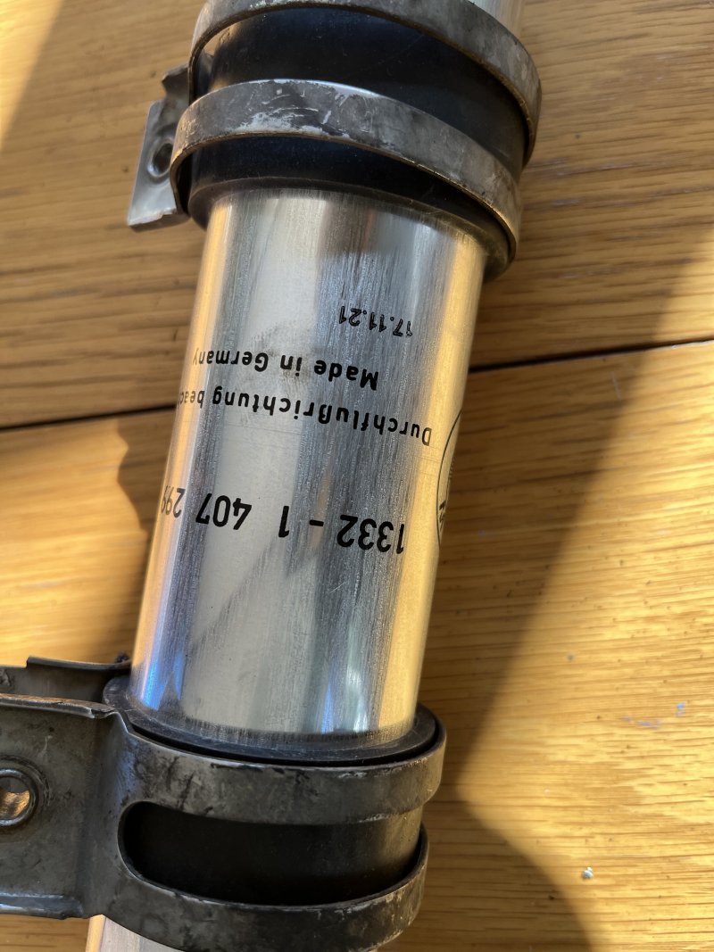

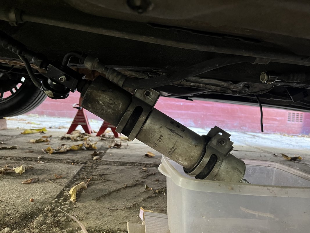

The one thing we did notice is that the o2/oxygen sensors in the aftermarket exhaust are not connected and the wires have been cut
So I'm going to get that rewired, and replaced.
When I scan the car using INPA, the only engine fault that comes up is the Exhaust Gas Temperature Sensor (EGT sensor) is not working.
NOW,
the even stranger thing is, the car ran well before, it idled well before, drove well. But the oxygen sensors were not connected.
Now its not running or idling well, but those are the only issues I can see, and as far as I'm aware, the engine needs these oxygen sensors to adjust fueling correctly.
During the cleaning and servicing, I noticed the car has 2 Unichips installed in the ECU compartment, meaning the car was "tuned
" at some point.
My question is, can the car be made to run properly, though tuning, without oxygen sensors in the exhaust, like a closed loop system or something like that???
Any advice would be appreciated.
