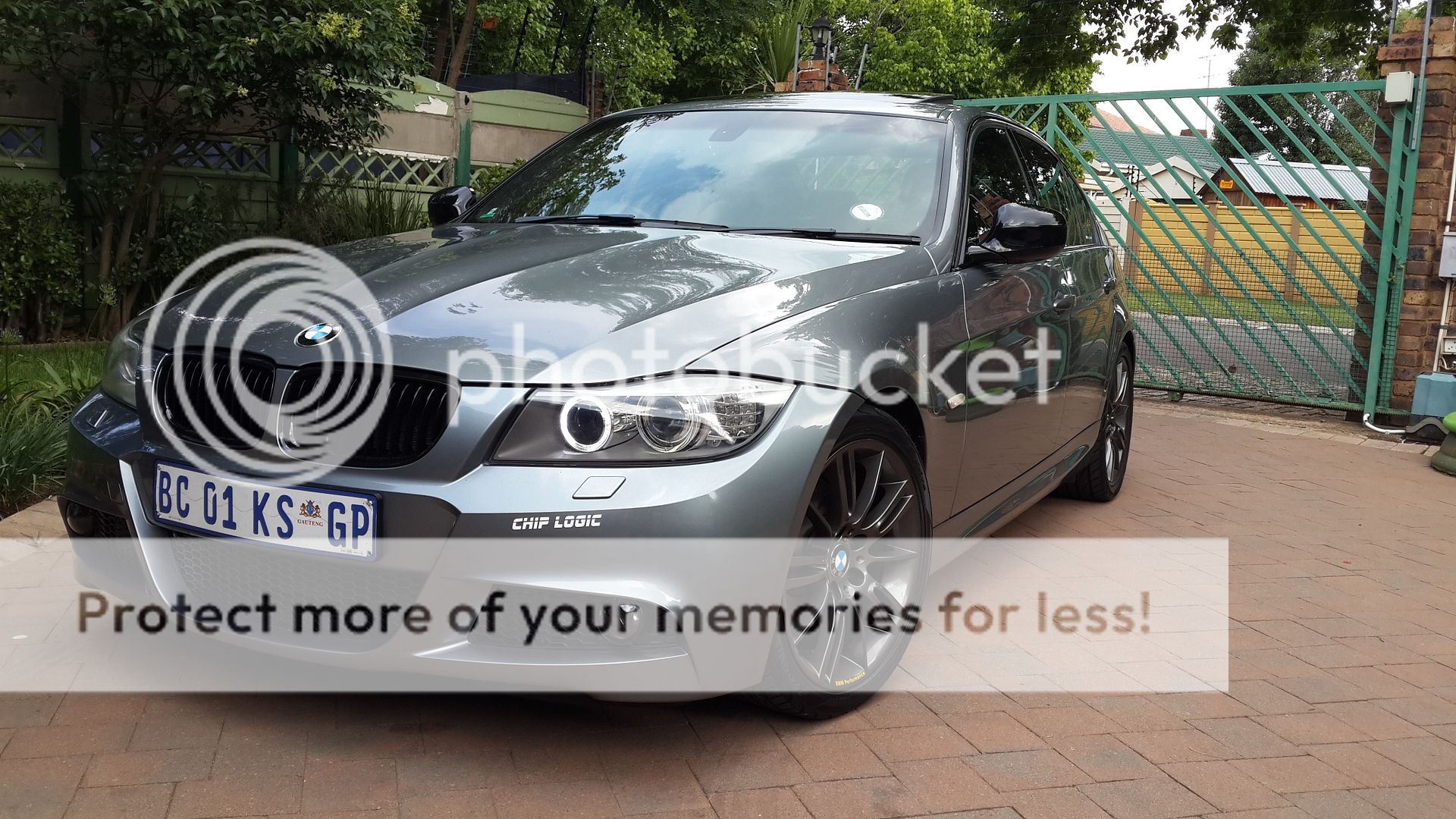

Gbyleveldt said:While I had the whole front of the car stripped to get the headlights out, I figured I'll upgrade to some LED Angel eyes as well. See thread here for the whole process of the headlight restoration process:
http://www.bmwfanatics.co.za/showthread.php?tid=62402
This is the result of all that effort.
I think I'm about done with the front of the car, although I might fit some splitters if I can find plastic ones I can get sprayed gloss black. For the back, I still want to add a spoiler (can't make up my mind between the slim one or Performance one), get the bottom part of the bumper painted gloss black and have a new tailpiece fitted.
Anyway, I'm starting to see the light at the end of this project, although I have a feeling I'll never be done :rollsmile:
