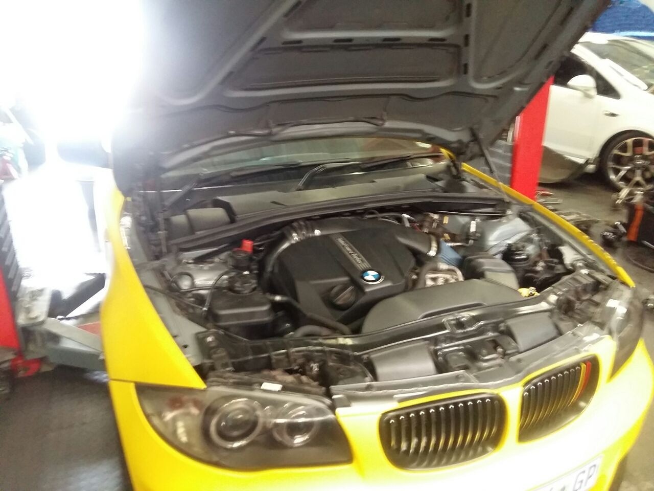

Here is a pic of the cooler and engine bay

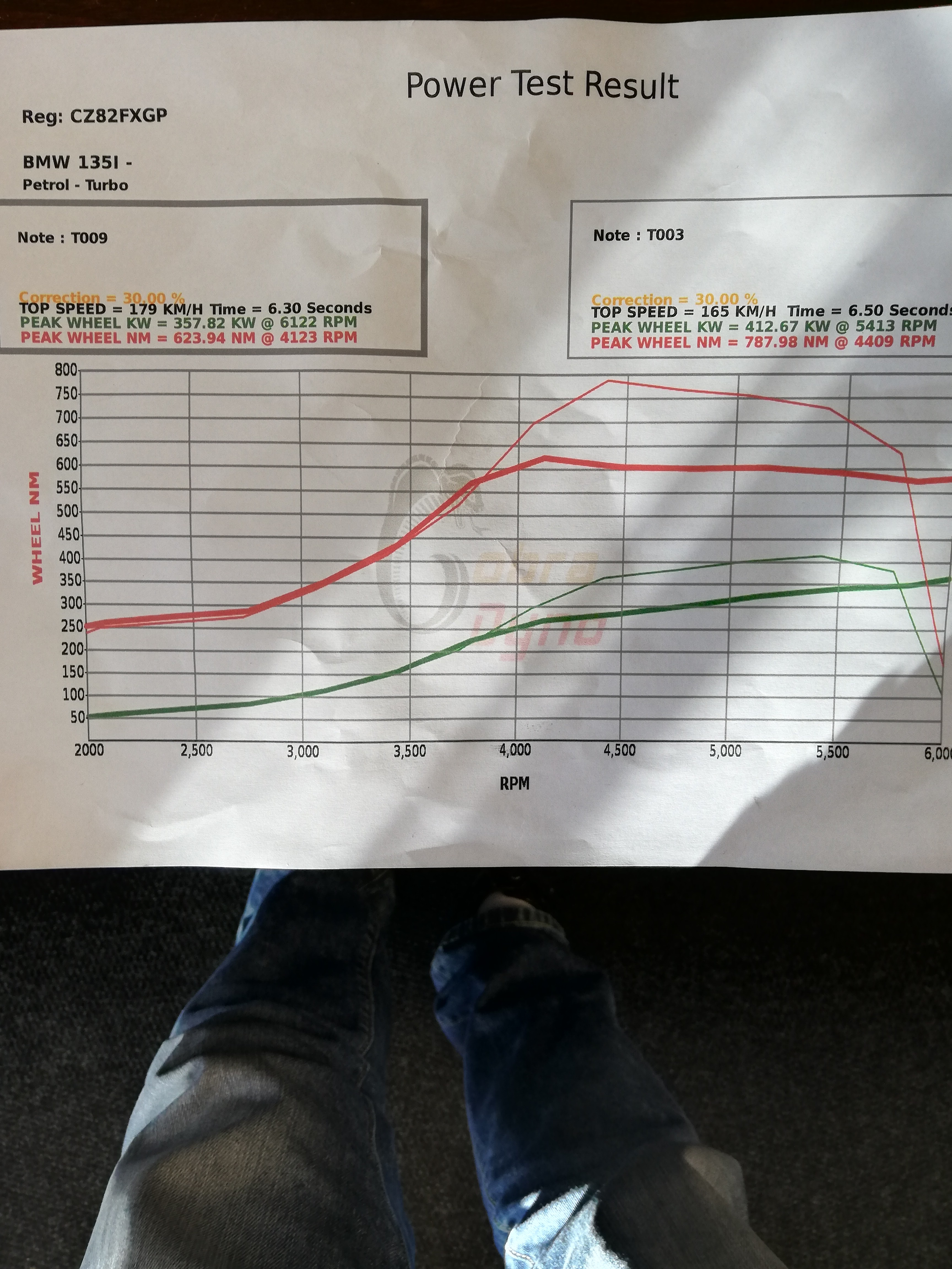

Hi Guys. Car was completed and I entered the BMWFanatics Raceday last saterday. I managed a 11.9 at 17 psi. Very happy with results. I also went to dyno today. At HM auto in Sebenza. I ran 17 psi which made 478hp (357wkw) and one run at 24 psi made 554whp (413wkw). I hit the DCT dmfw ghost missfires at 5500rpm so car could not Rev out to 6500rpm so there's still about 20 to 30 kw left to be made. I am glad with the FIGURES. THIS WAS WITHOUT Nos.

The 413wkw was on the second power run as first missfired and didn't finish the run all the way. I'm not Gana use the Nos for Power. Just for spool.
