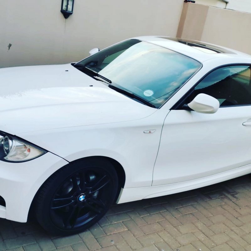

My first BMW E82 135i

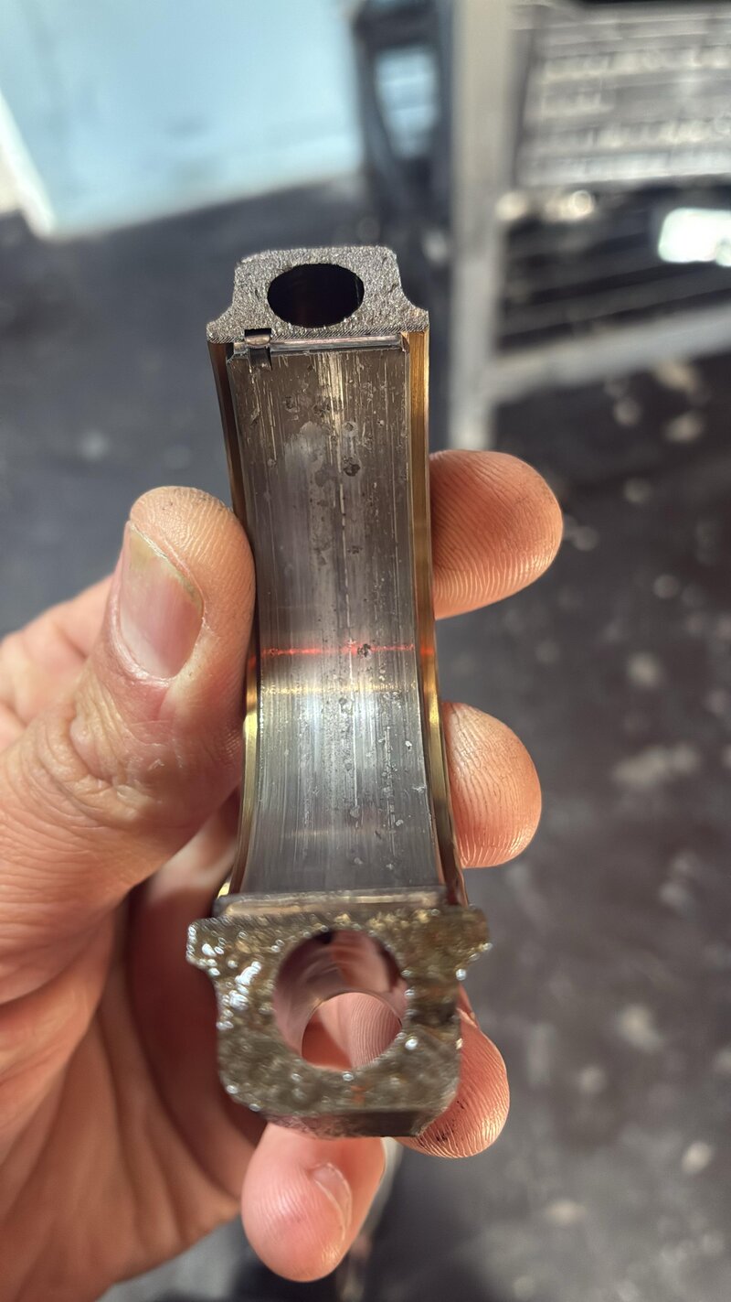

Decided to check rod bearings while we had the subframe off to do the turbo. I think it's safe to say these need replacing. They have lasted 3 years and did about 2 seasons of racing.
Toying with the idea of going 10w60 to try help oil temps. And also not sure on if it's better to change oil after every event vs using Motul 300v and doing 4-6 races on that oil.

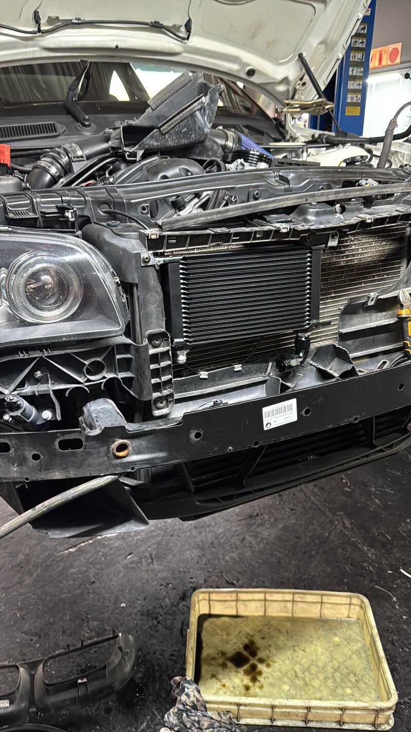

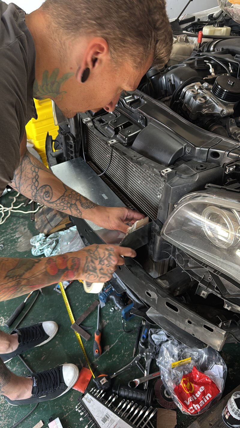

So a few things were needed for Kyalami.

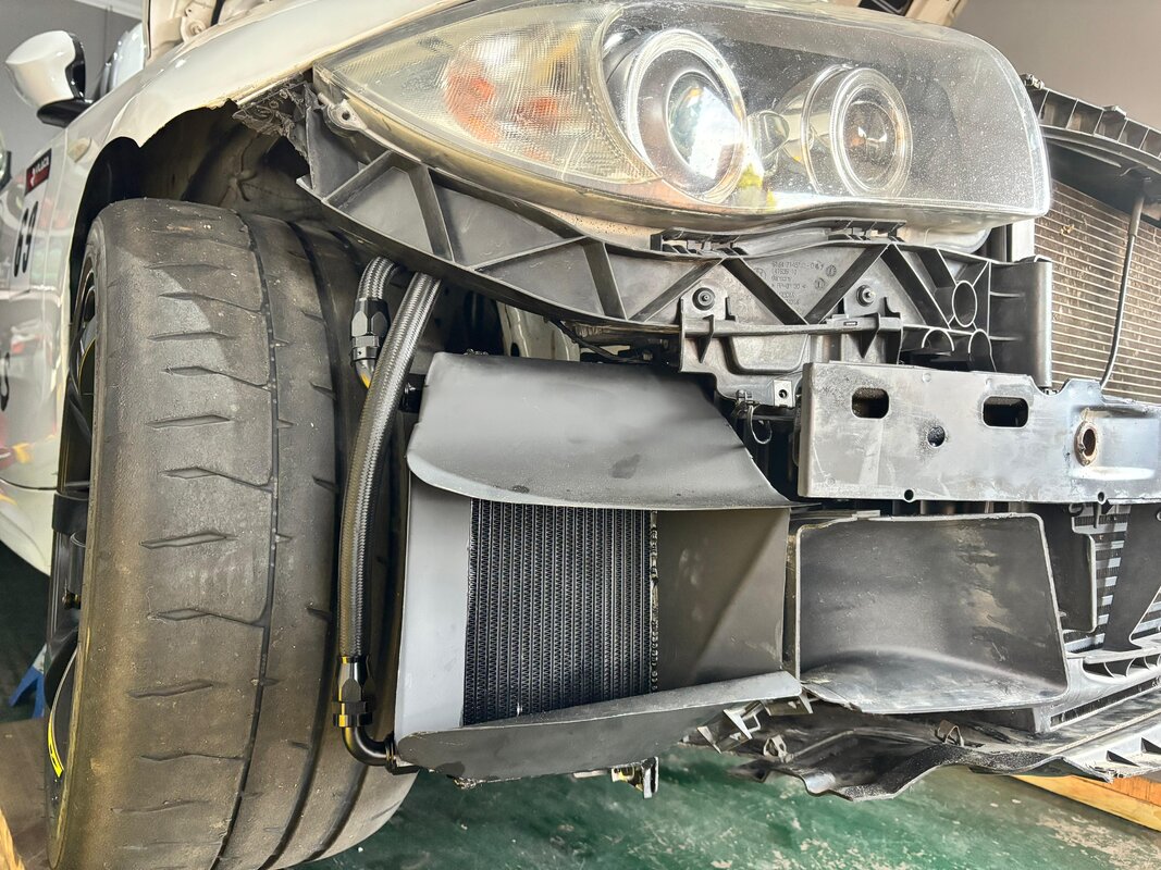

Added a oil cooler to the mix to help with temps.

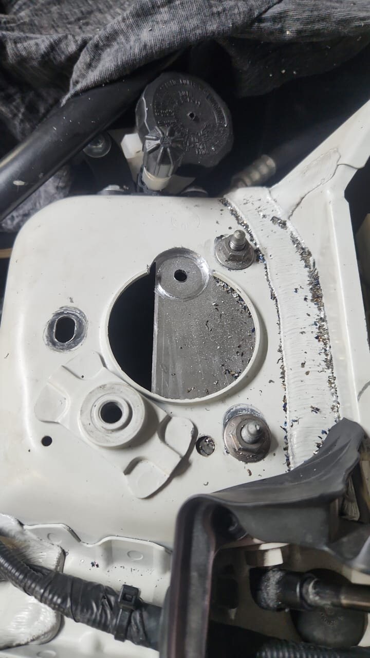

Notched the shock towers to be able to dial in more camber.

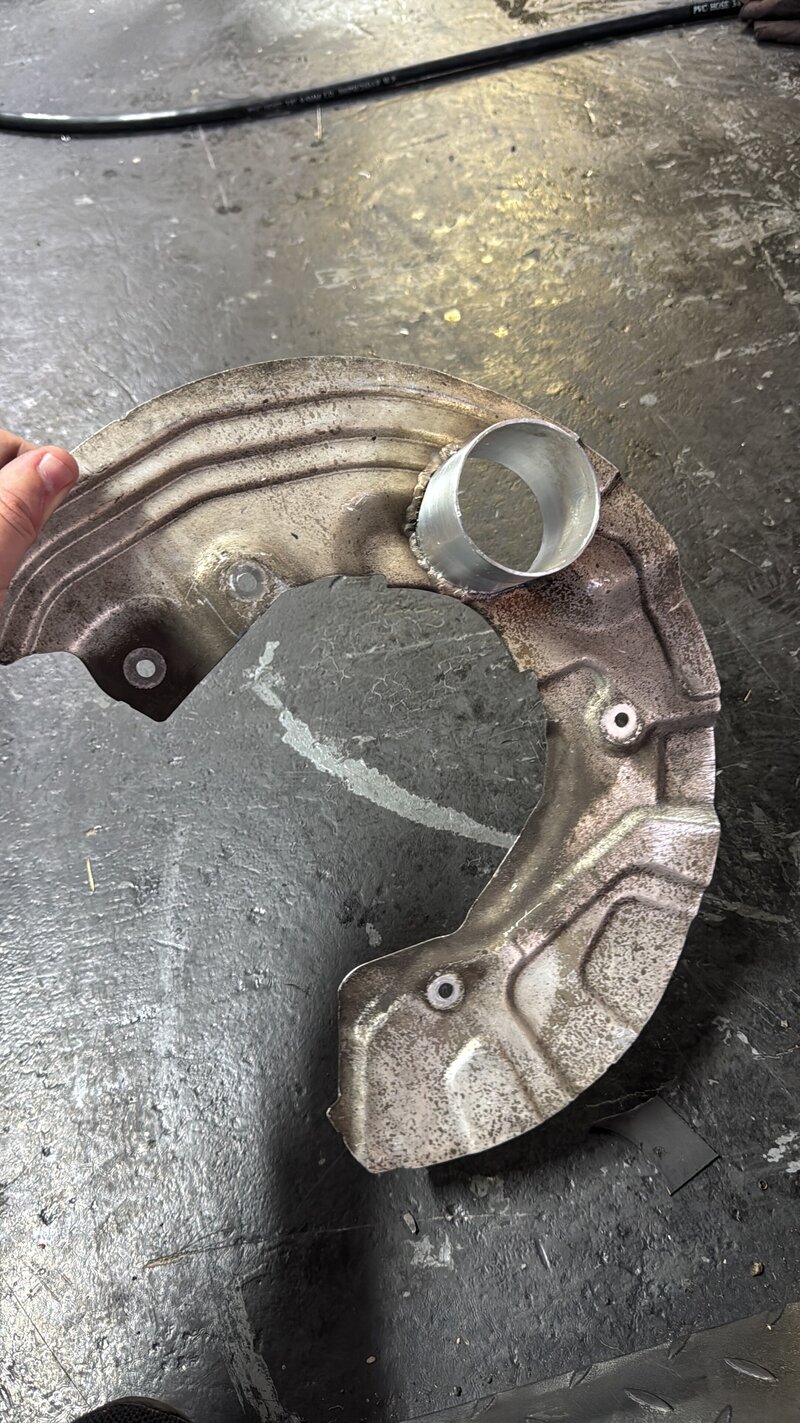

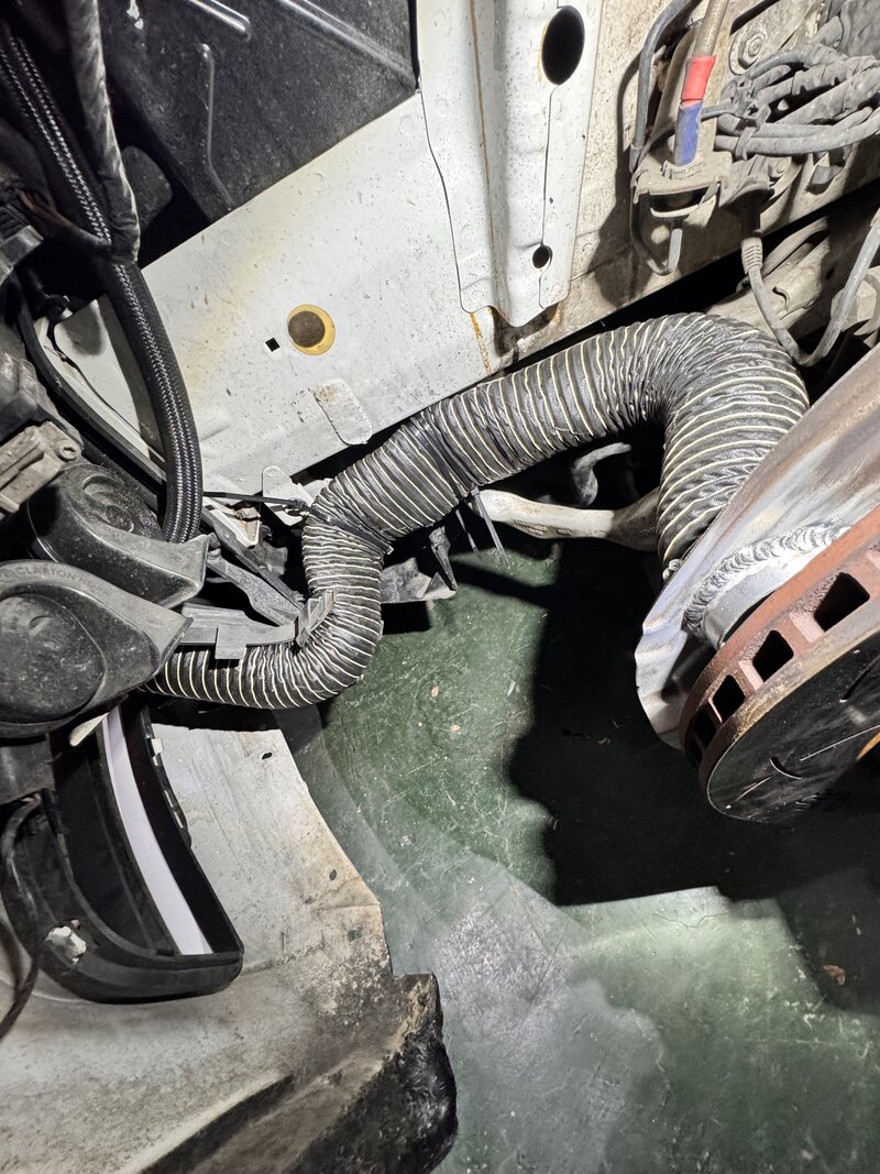

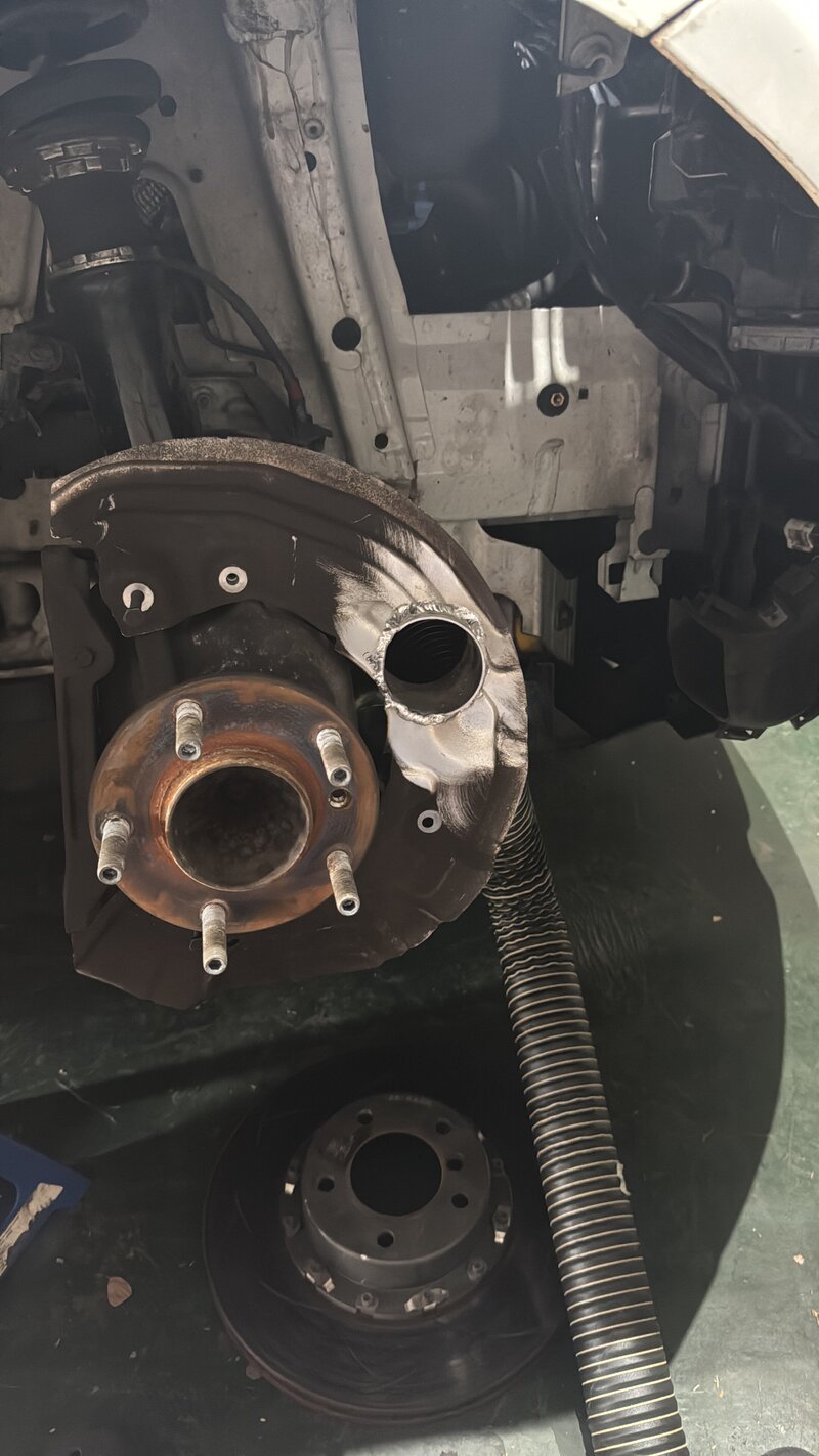

Did some DIY brake ducting to try help with the brake fluid going off and causing squishy pedal feel.
Waiting on the matching Endless rear pads still, Hopefully before Friday.
Went more aggressive on the tune in the hope to get a bit more speed. Unfortunately this turbo doesn't seem to work well with the pwg actuator it's like it can't bleed enough fast enough for the car to be happy.
Planning on just getting a bigger single turbo going to hopefully solve my power problems.

Ran into some unexpected issues with moving the oil cooler up top.... The water temps got too high and the car went into a protective mode which cuts all boost for a bit. Great for a reliable daily, Less Idea when you're chasing a lap time.
So after fiddling with the file ( Not my best Choice tbh) the car was actually even worse. On Saturday I managed my PB of 2:05.6 and my closest competitor was doing 2:06 at the time.
We tried a few things that didn't work and it kept going into limp mode, After a few changes we got it to work right but bow the car felt lazy and a bit weaker than the day before.
The main issue I was fighting now was heat management, I could do 1 lap before the oil and water temps got too high and the car would enter the protective mode again.

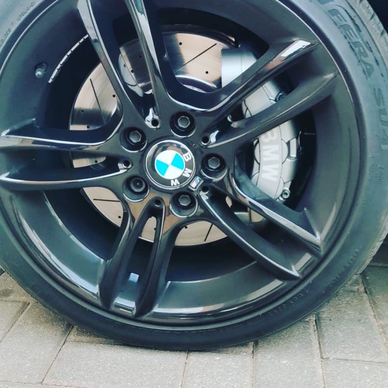

So I added some additional upgrades since Kyalami.
Rebuilt my brakes, Added some ductwork for to improve cooling.

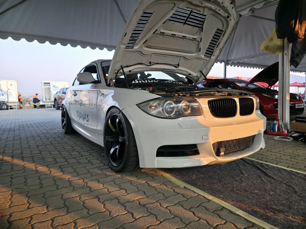

Have you done empirical measurements of the bonnet vents with wool tufts? They can actually increase under bonnet temps when they are in the wrong location

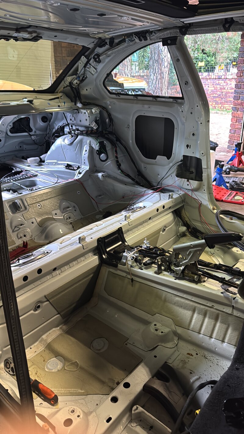

Vinnige Fanie

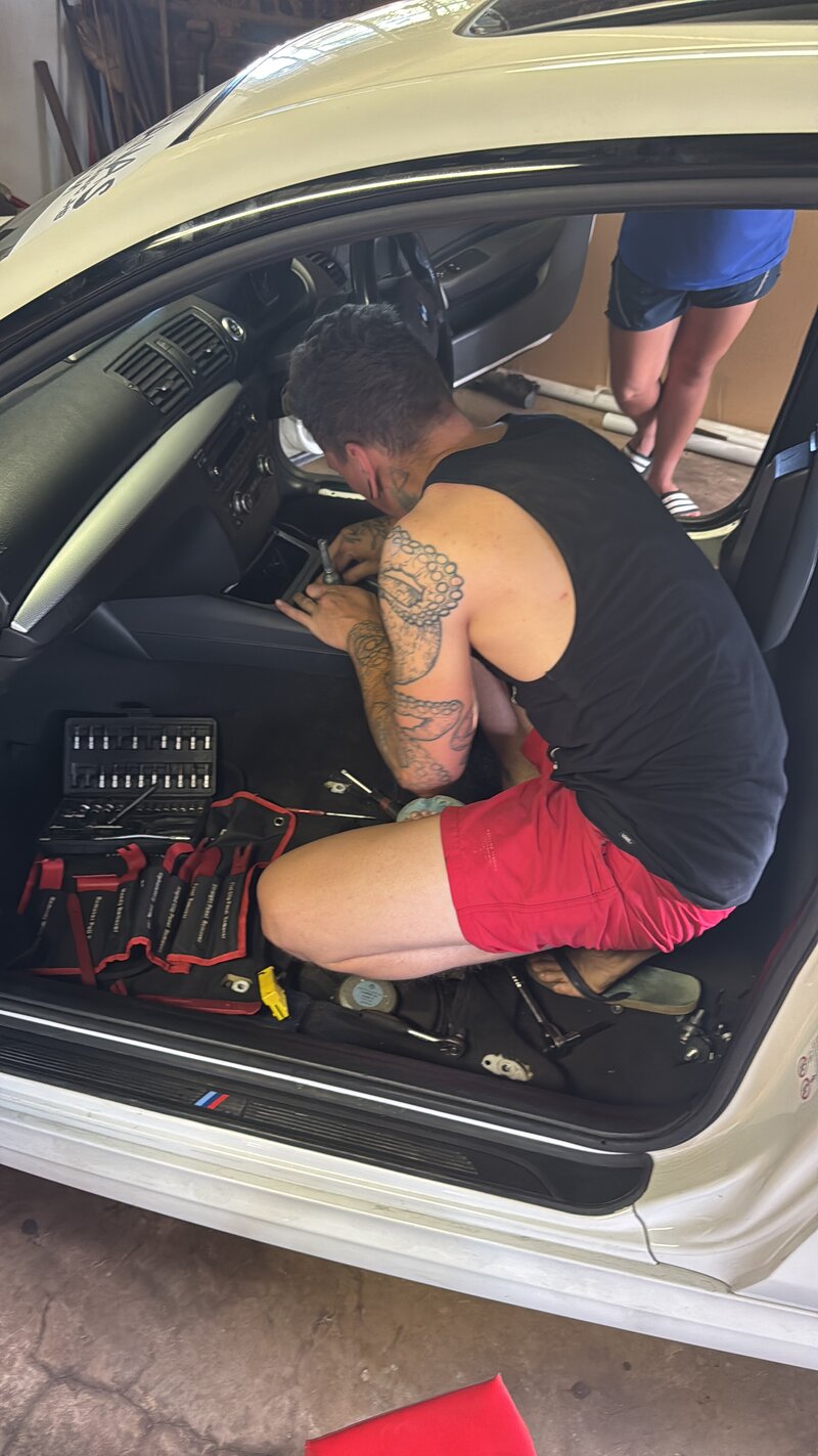

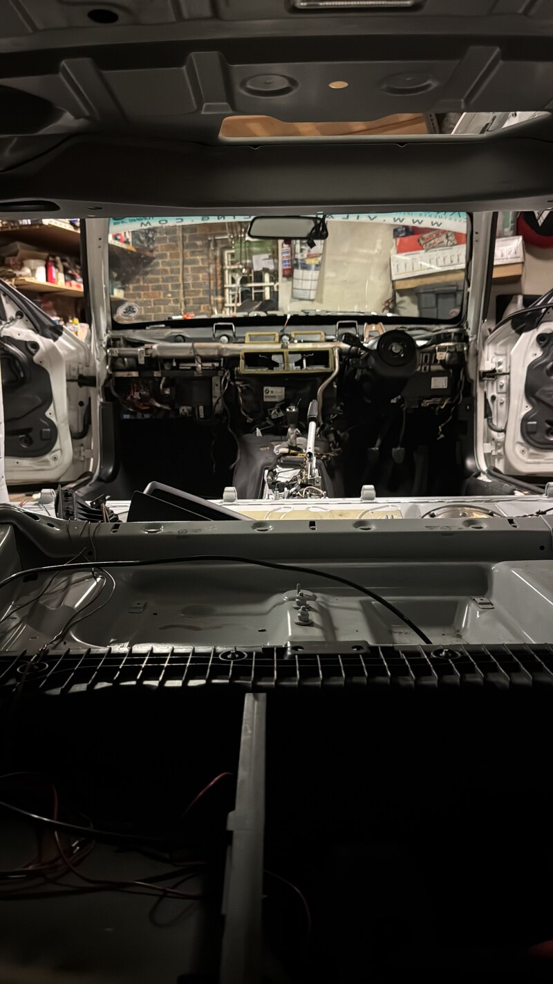

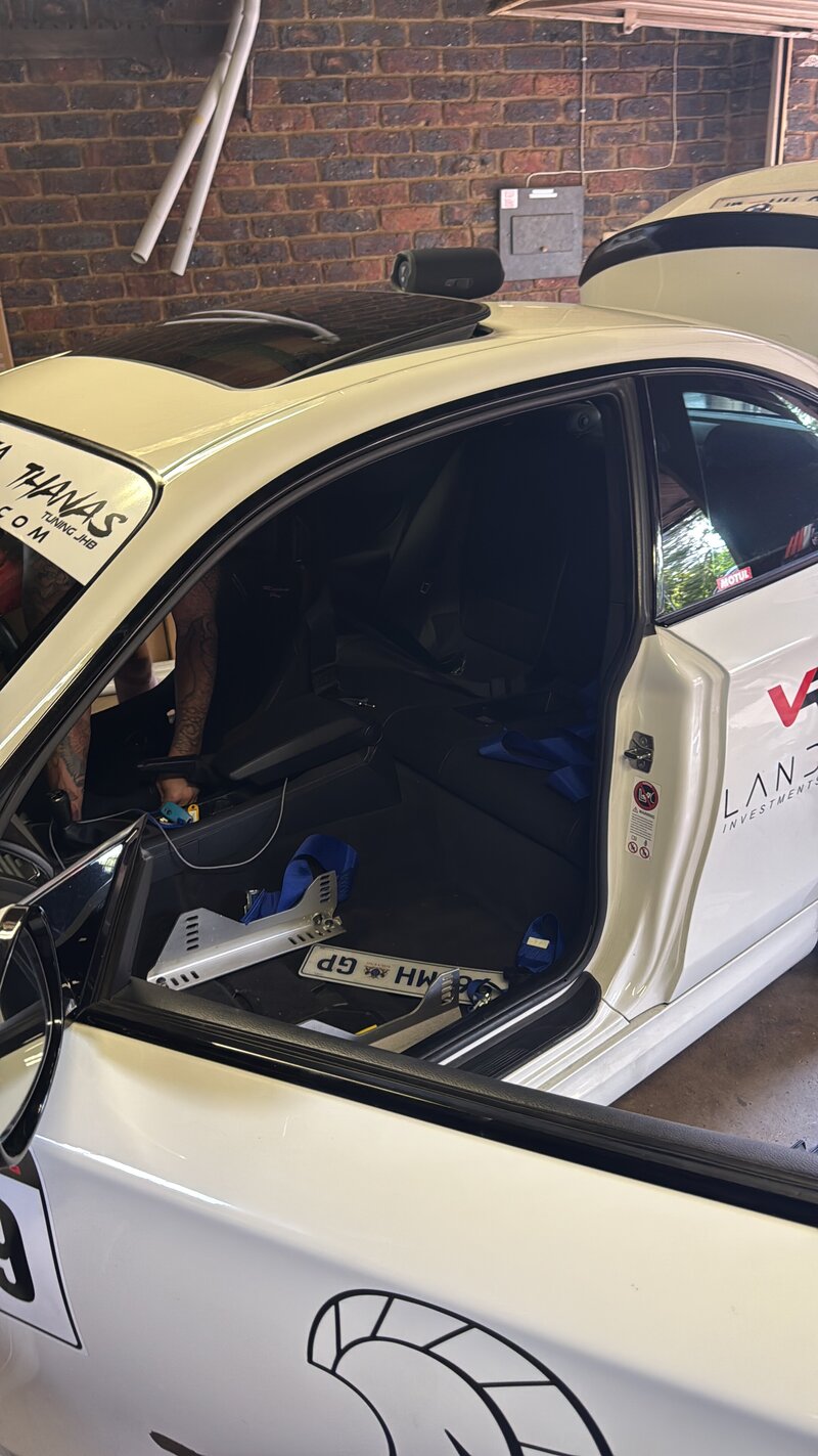

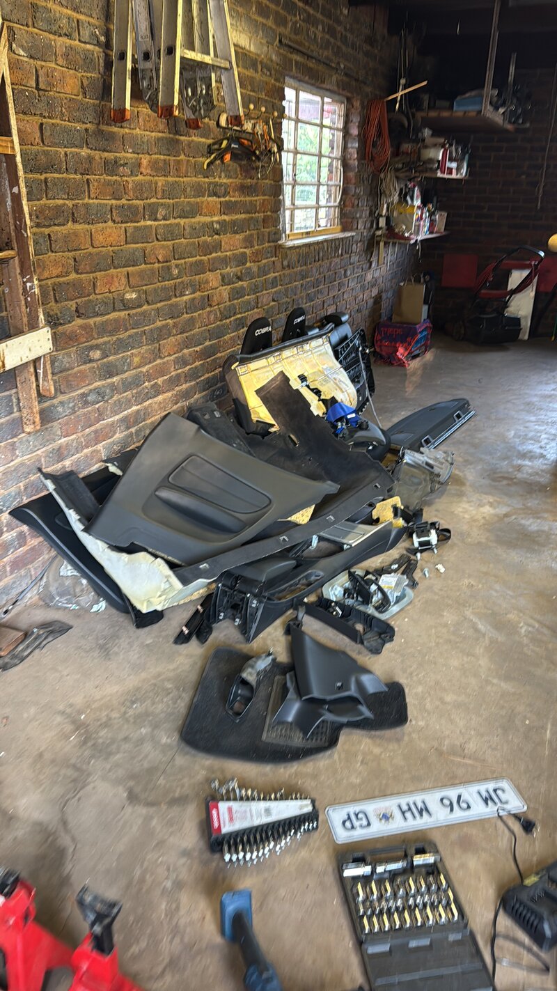

So this car has started to move on to the next step of going faster.
Full cage and stripping as much weight as possible.

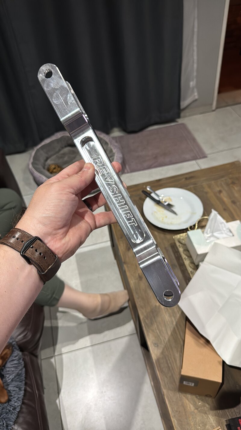

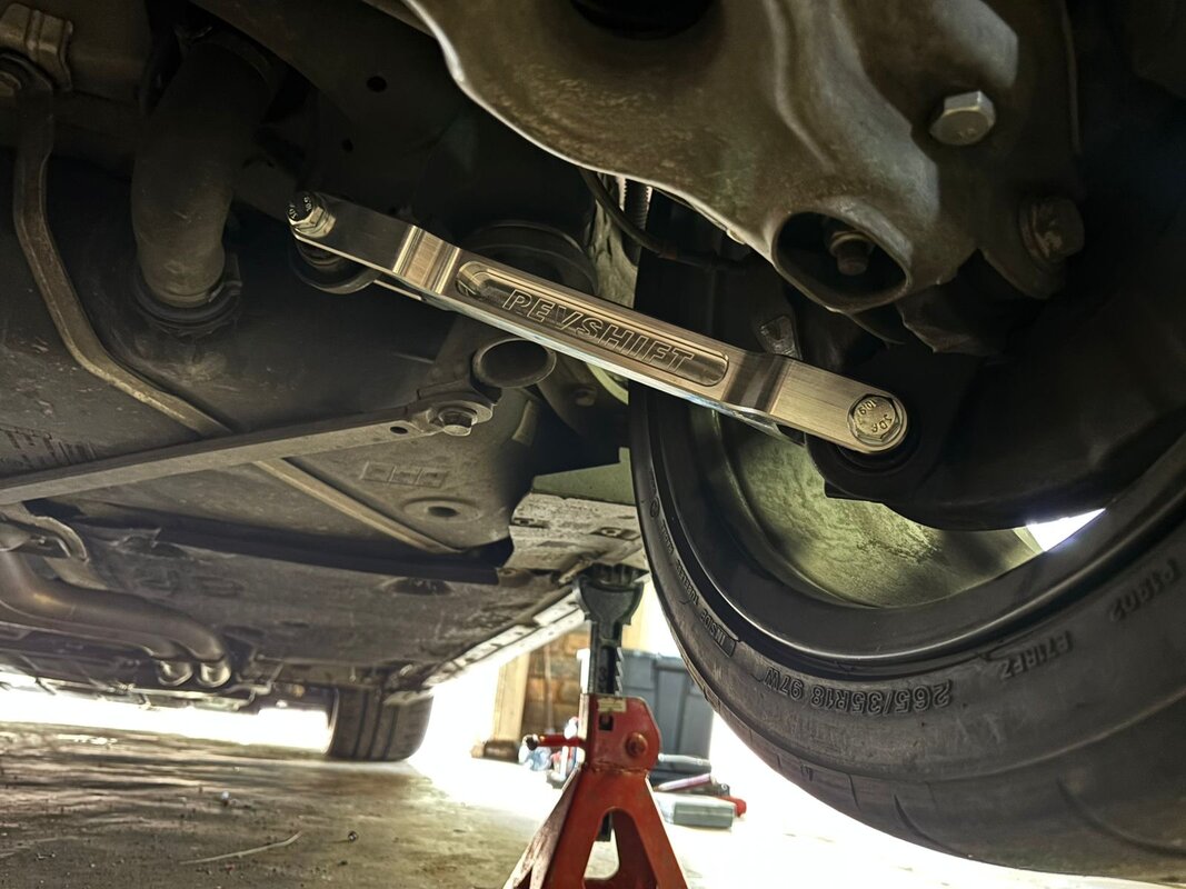

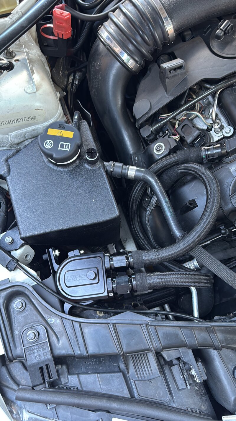

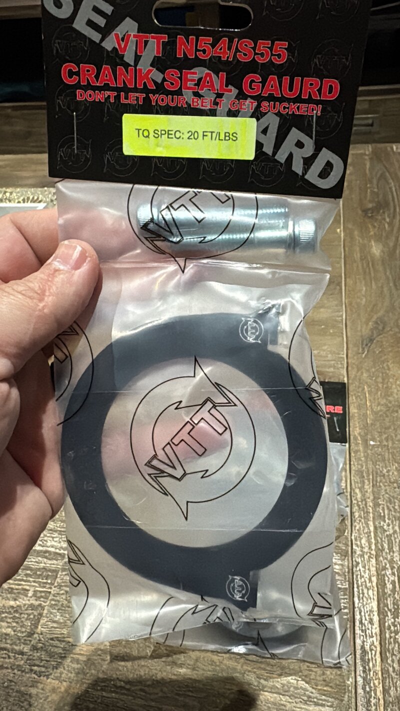

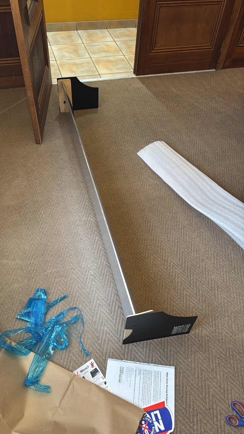

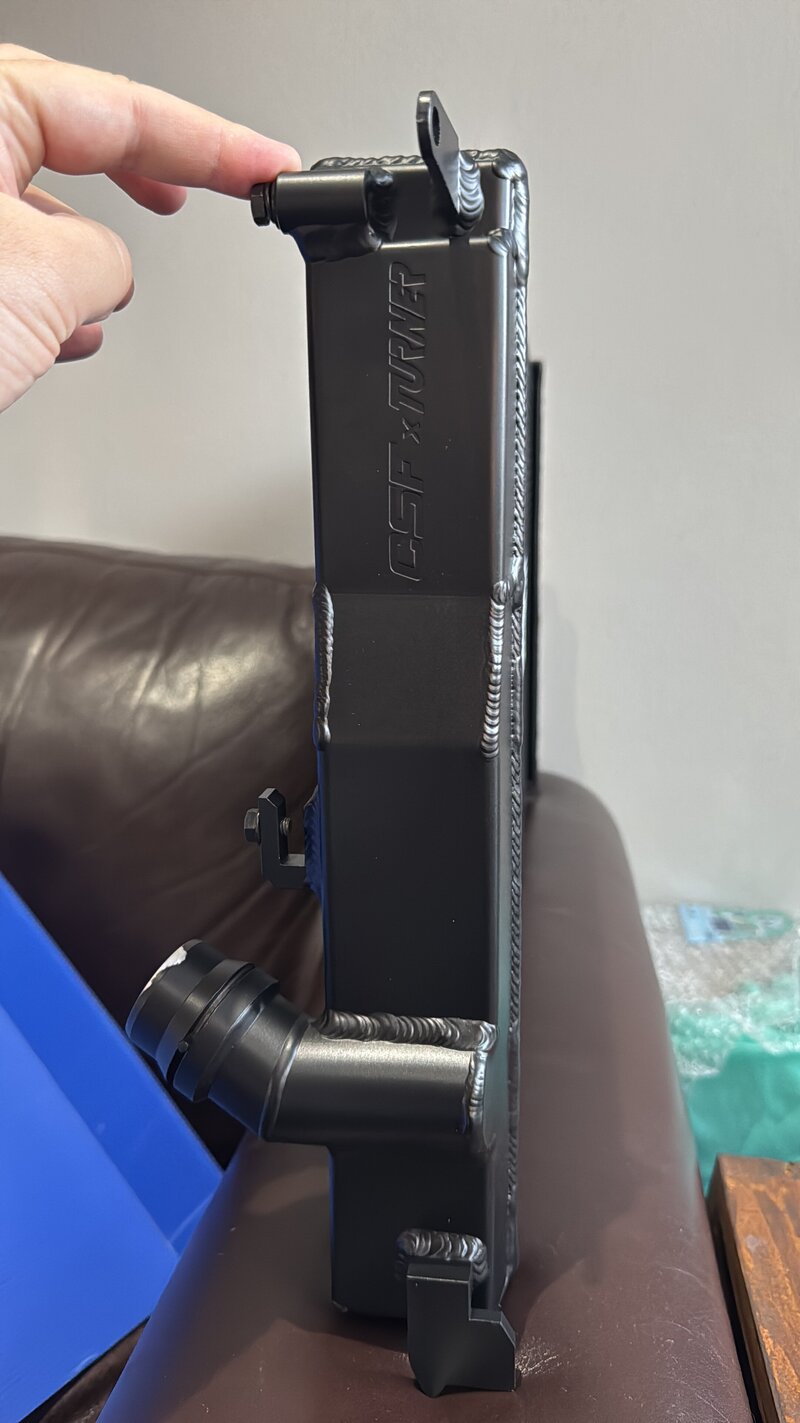

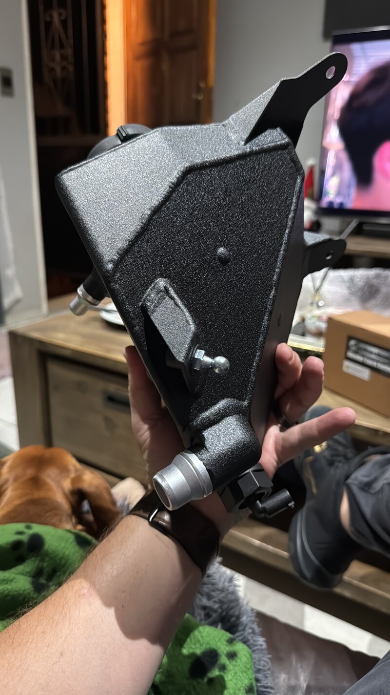

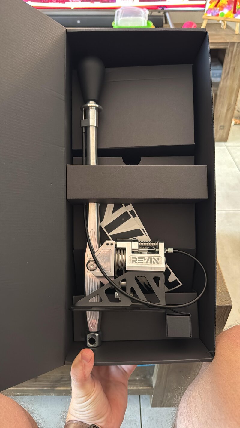

Vinnige Fanie

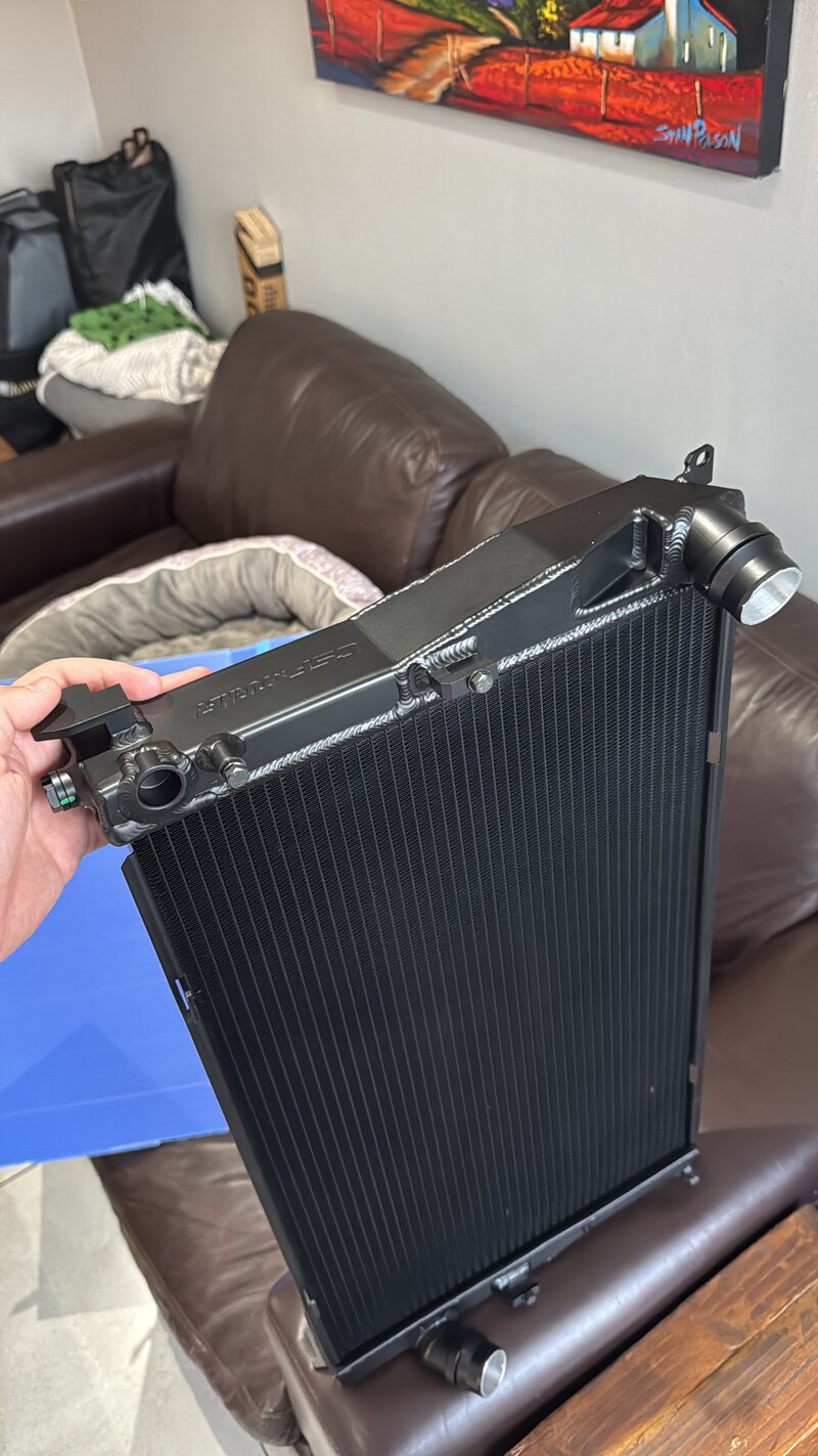

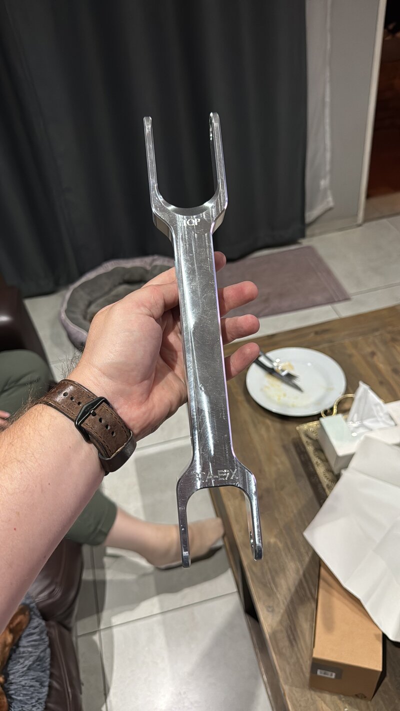

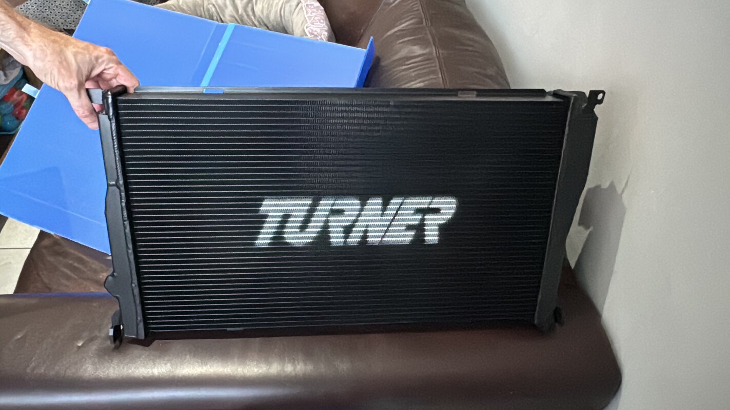

So Christmas came early this year.
Csf Turner Radiator

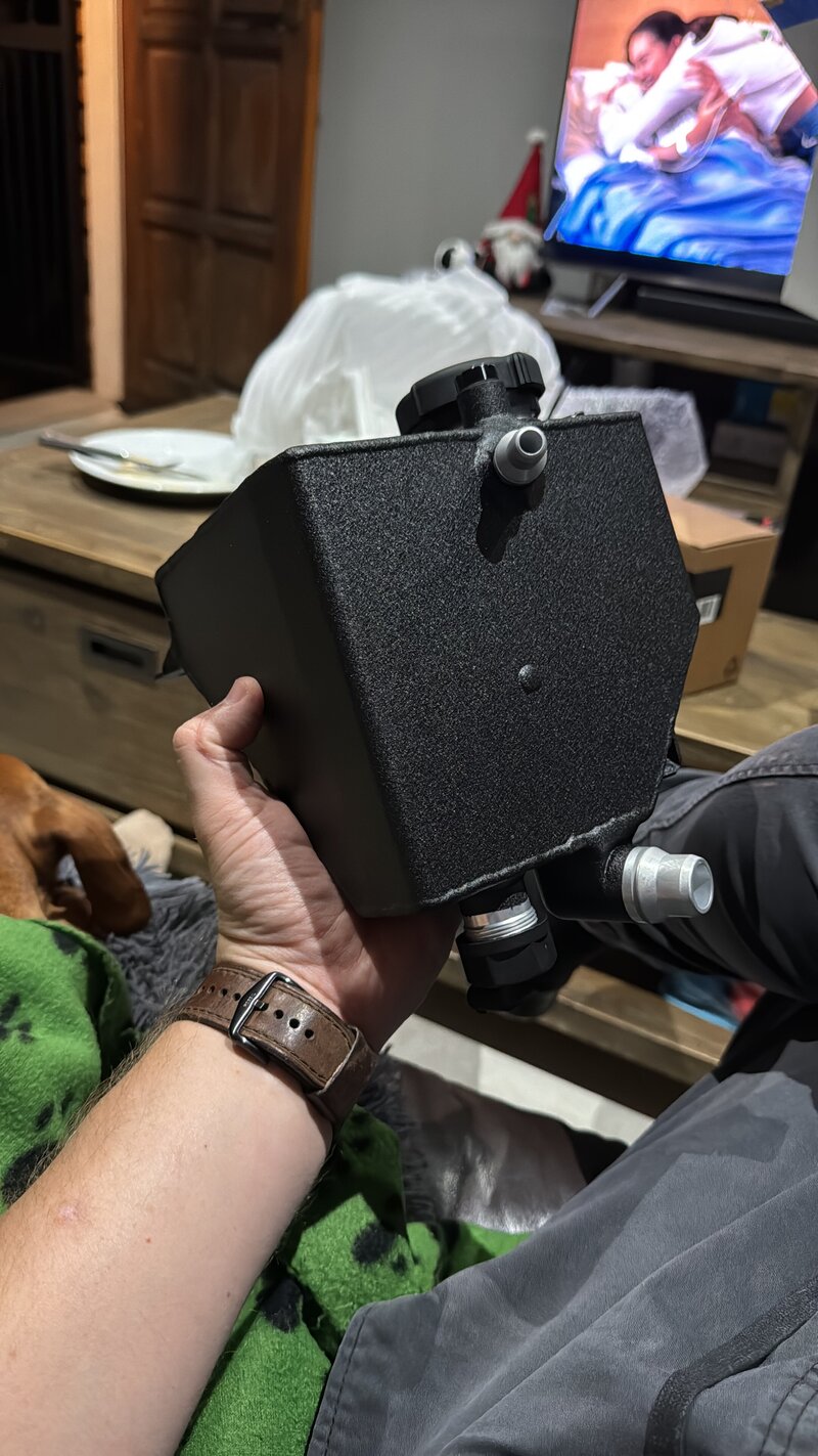

Turner motorsports expansion tank
Revin shifter
Nine lives racing big wang
Trailing arms

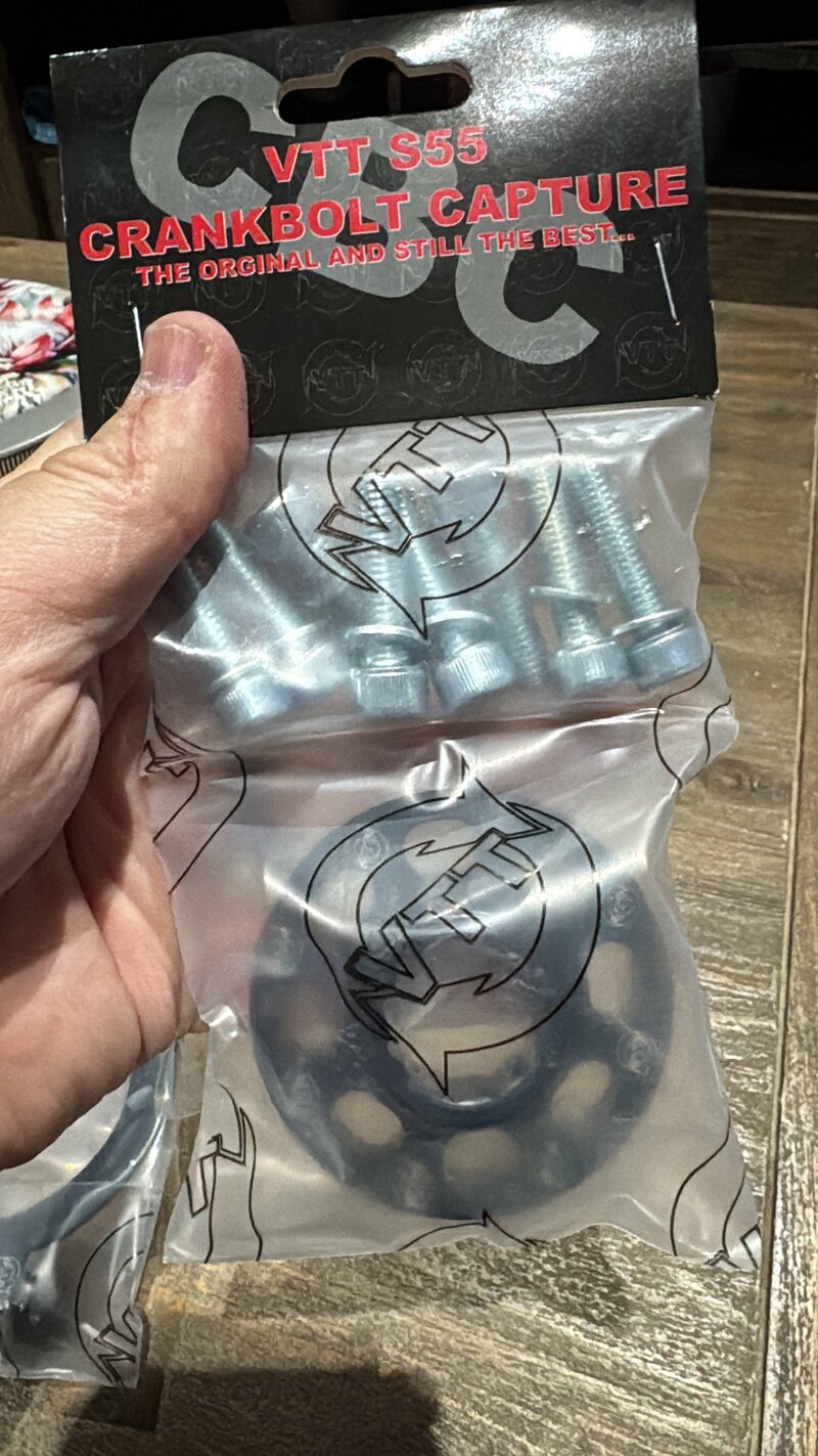

VTT crank capture and seal guard
Turner oil catch can
Turner single mass flywheel
Turner solid engine and gearbox mounts
Still waiting on lexan glass and Big turbo

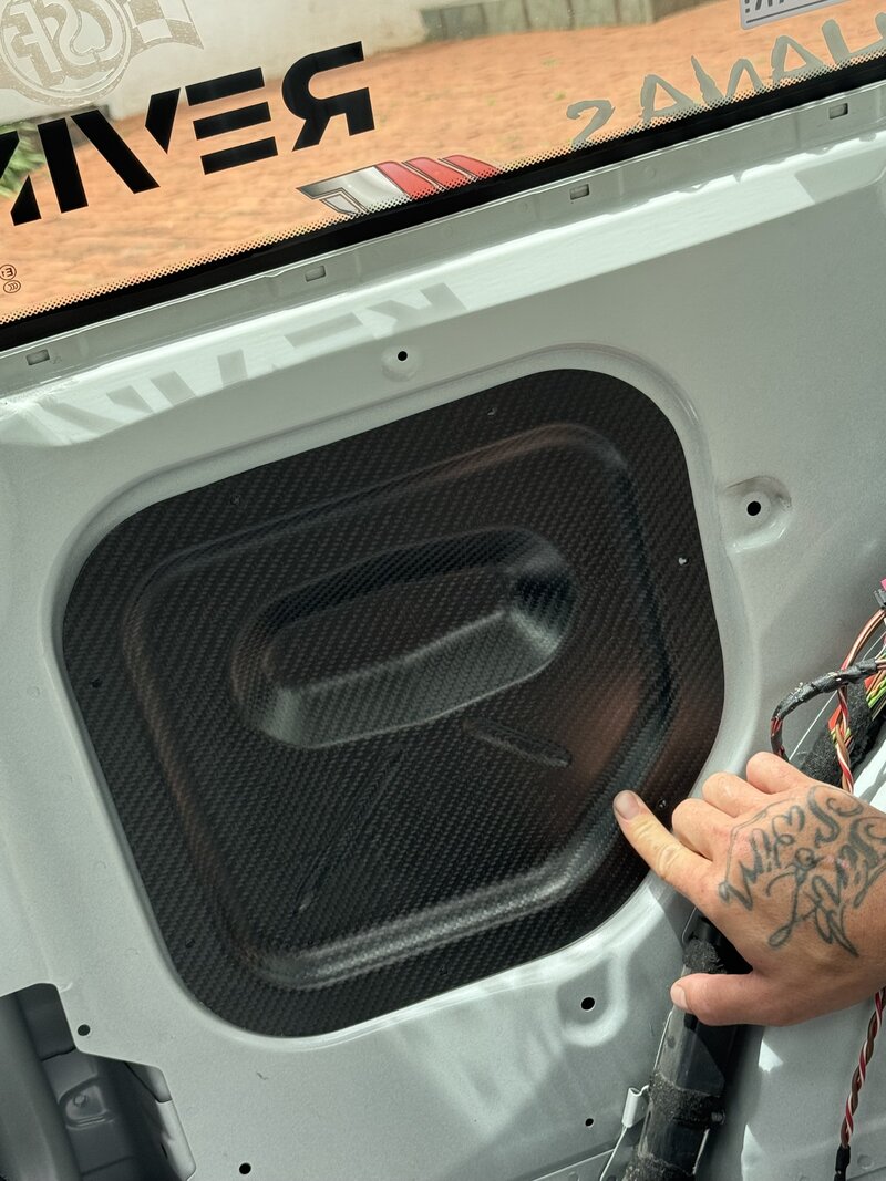

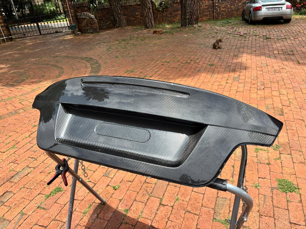

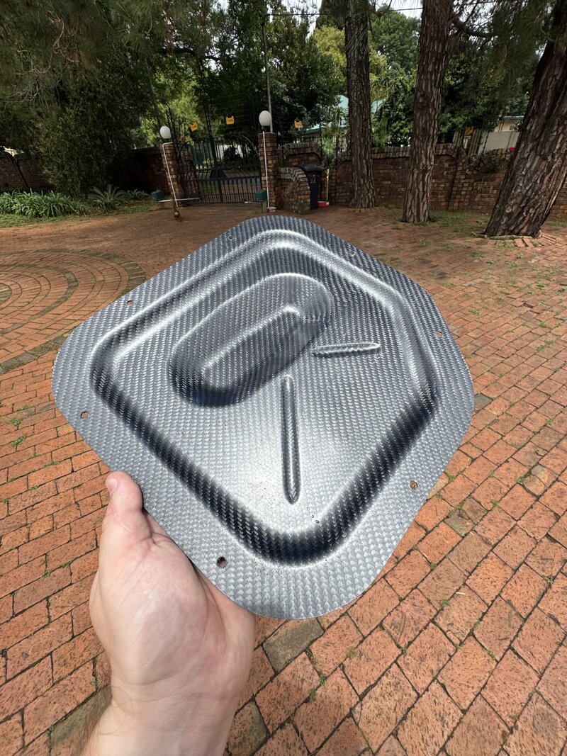

Vinnige Fanie
So fitted most of the parts and also started trying to make my own Carbon Fibre parts to see if I can eventually do custom body panels.
Also this shifter is amazingly tactile and direct. Very chuffed so far.

NBN
Nice work bud.....
Outta curiosity, are you skinning cf parts or vacuum forming and using an auto clave?

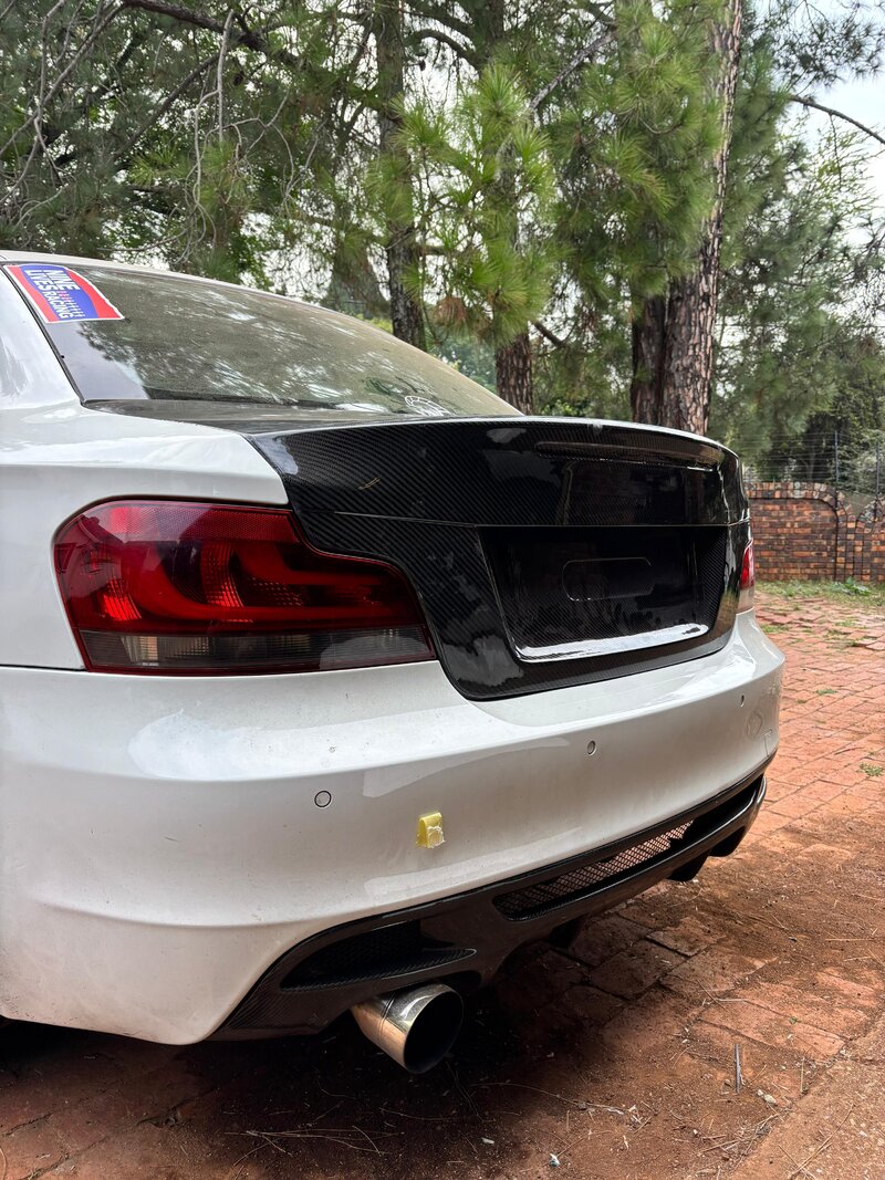

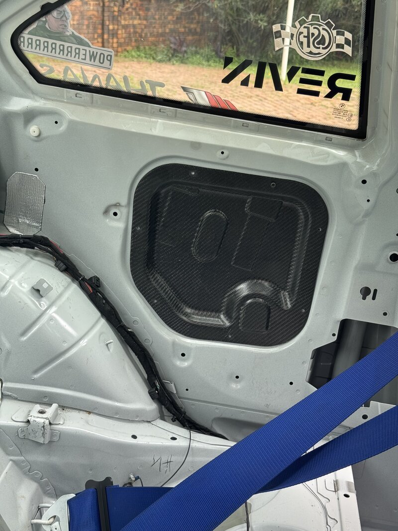

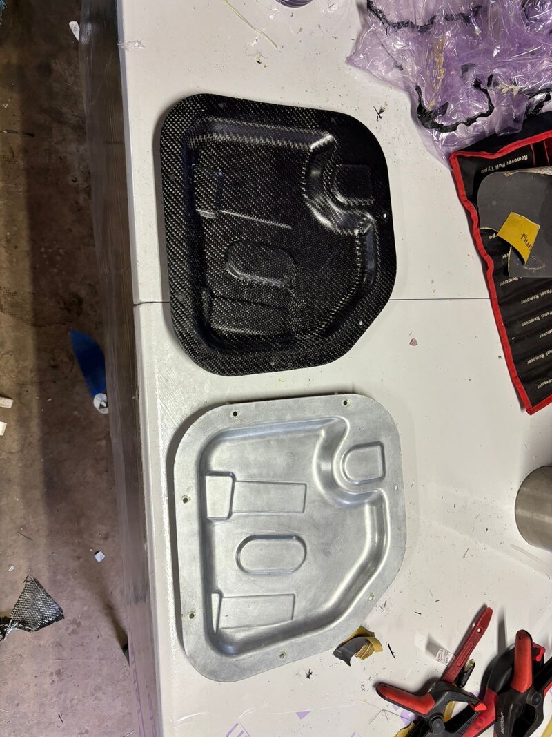

Vinnige Fanie
So after a couple of weeks of work I ended up with this...
Stock one weighs 14.9kgs
Carbon 3.7kgs
