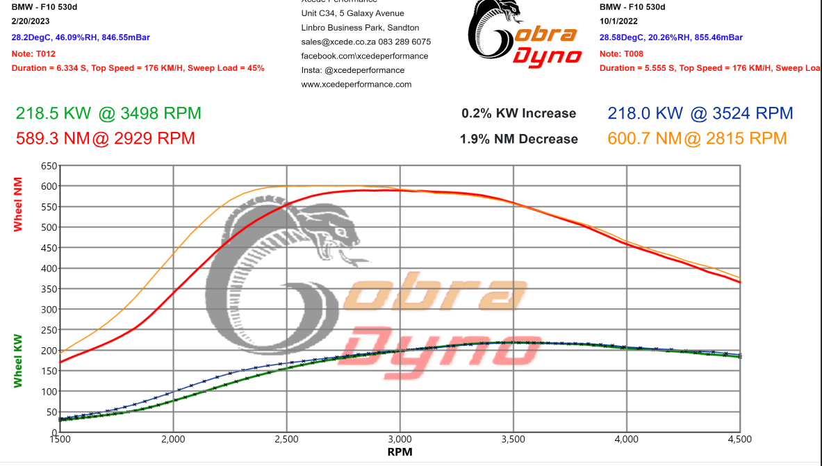

After the turbo core replacement, I noticed a more noticeable lag in acceleration. Quick lane changes now necessitated downshifting, whereas before they did not. To confirm this change, I took the car to Xcede for another dyno test, which indeed showed a decrease in torque at lower rev ranges, as indicated in the image below. Furthermore, I observed an increase in fuel consumption with a similar driving style, resulting in a figure of 11l/100km, compared to the previous 10l/100km.
Now, in June, I'm facing the same turbo whine issue as before, but this time it took approximately two months to reoccur, whereas previously it took about two weeks. I'm unsure about the root cause of the problem and I am seeking a second opinion. Could it be related to the boost? Or is there something else that could be causing trouble with my turbo? I reached out to Fastec, but they require only the turbo itself, while Stallion Turbos mentioned they have no issue with the turbo remaining in the car.

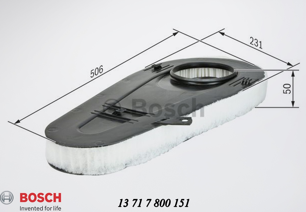

Looking ahead, my car is due for a service soon, and I am currently searching for an aftermarket air filter that surpasses the stock one. I have been considering options like BMC or K&N filters, but I am struggling to find the right fitment. (A picture of the stock filter is attached.) If anyone could offer assistance or direct me to a reliable source, I would greatly appreciate it.
