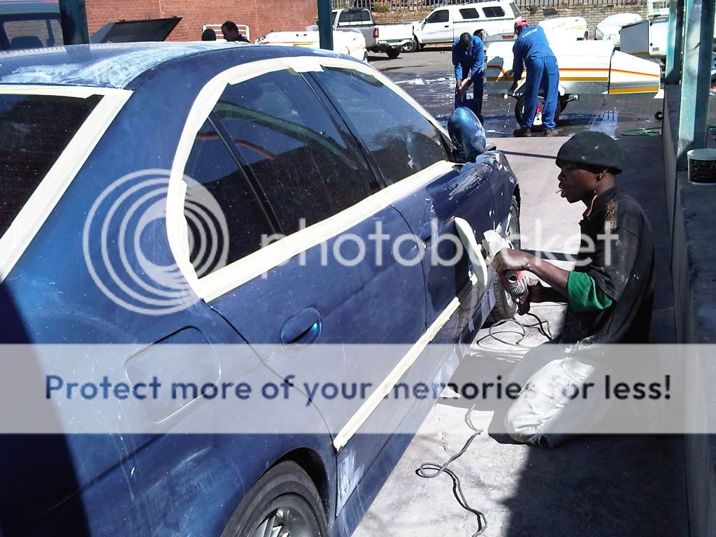

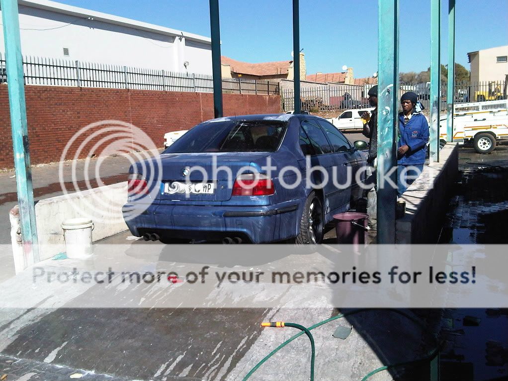

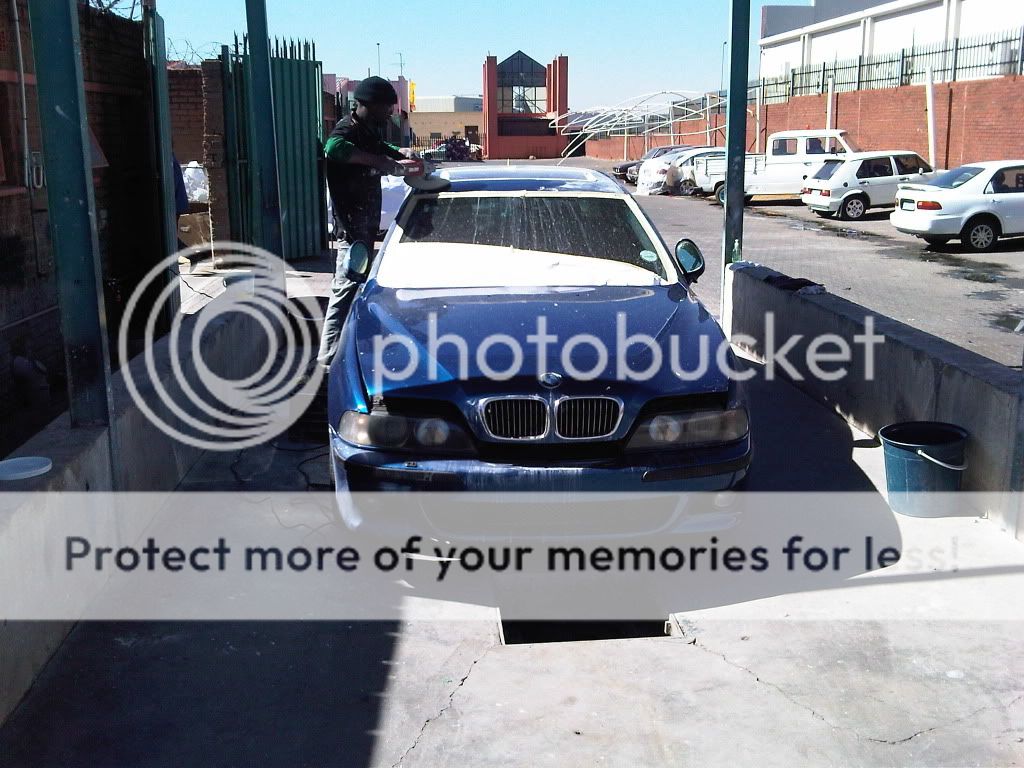

Ok so some updates. My polisher did not have any work to do, so I gave him some :biglol:
Wet sand the M completly te get the paint smooth, remember car had a respray, and the previous owner never had the time to finish up the final coat.
Washed
More to come later
