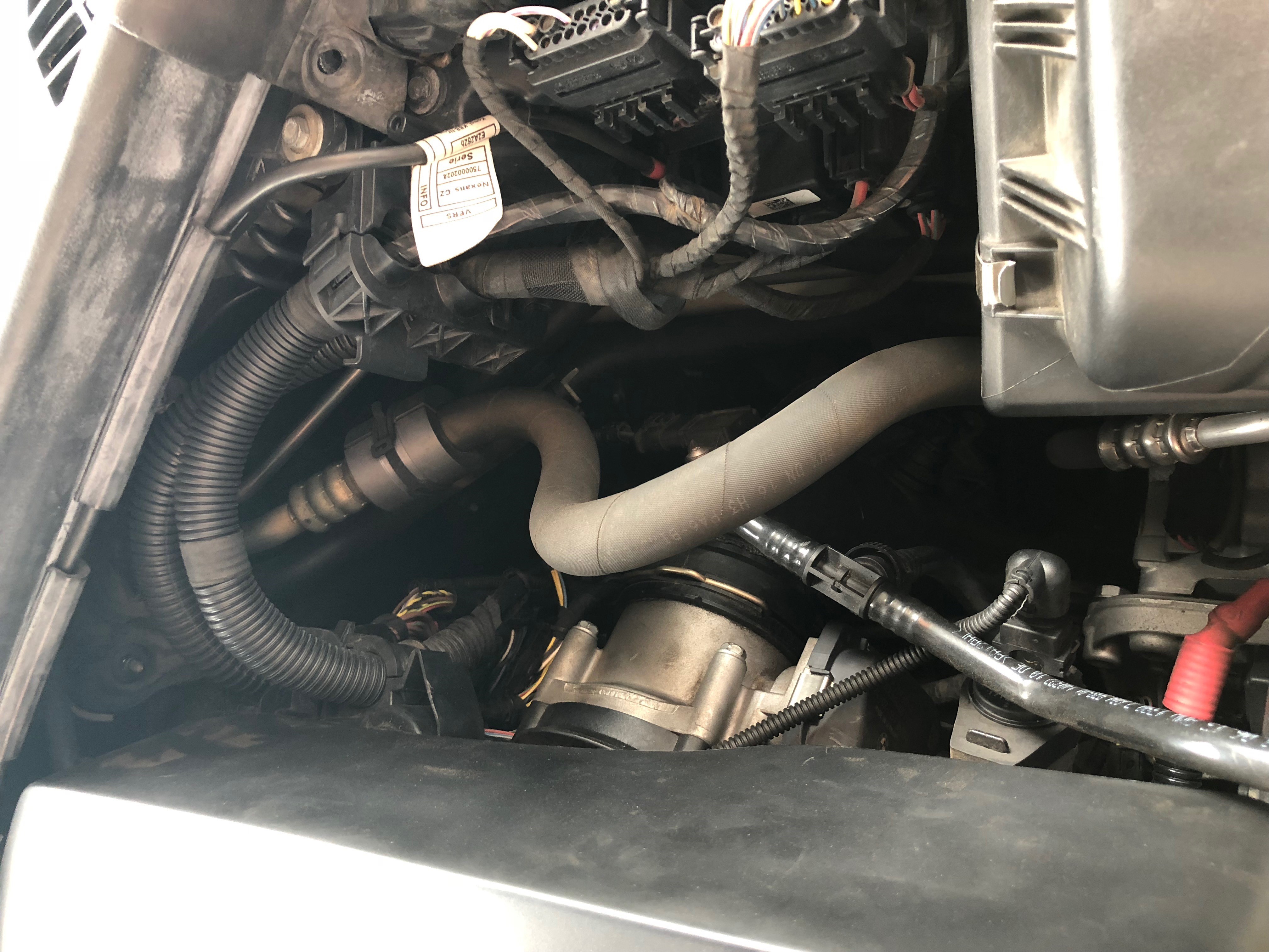

Chrism135i
my car does not see to have the added weight which is there to prevent vibrations. will take it to the dealer tomorrow hopefully they are aware of this

Chrism135i said:
You're just going to end up prolonging the process with this as they will attempt to resolve the issue by 'trying this fix'. You've already (probably) sent it in numerous times based on the list of things that were already replaced.
You have MP, which is expiring soon. Drop the car off and get it checked out for the bearing knock and they will advise accordingly.

70007
I had same vibration issue on my 2014 F30 335i. The weight on pipe sorted it out. Its a well known issue on the 335i on international forums
Chrism135i
just an update. the aircon pipe weight thing was fitted and all vibrations have been fixed. cant believe such a small thing can cause such a massive issue lol
