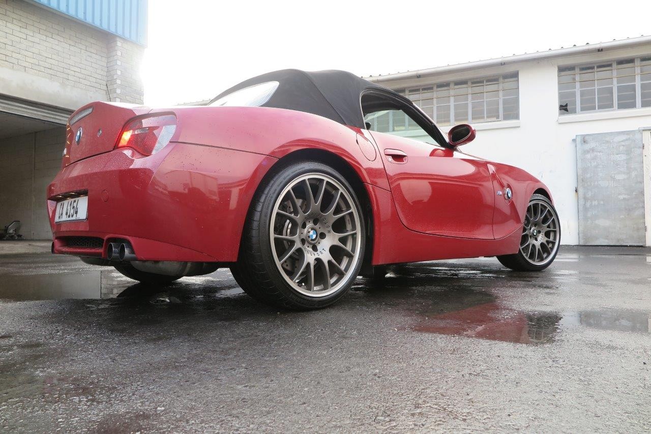

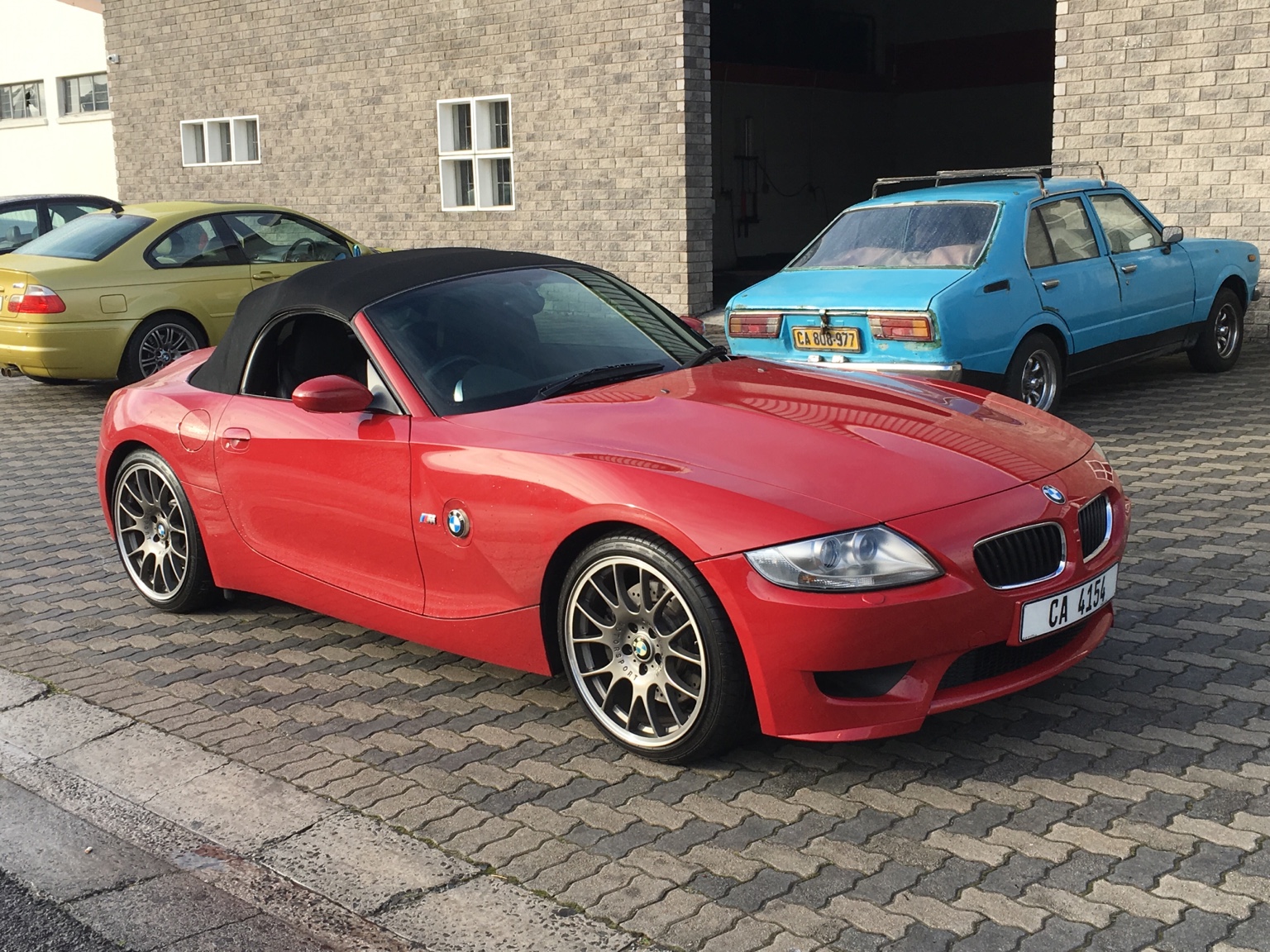

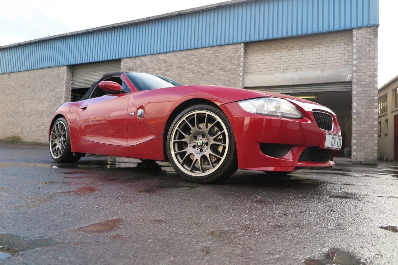

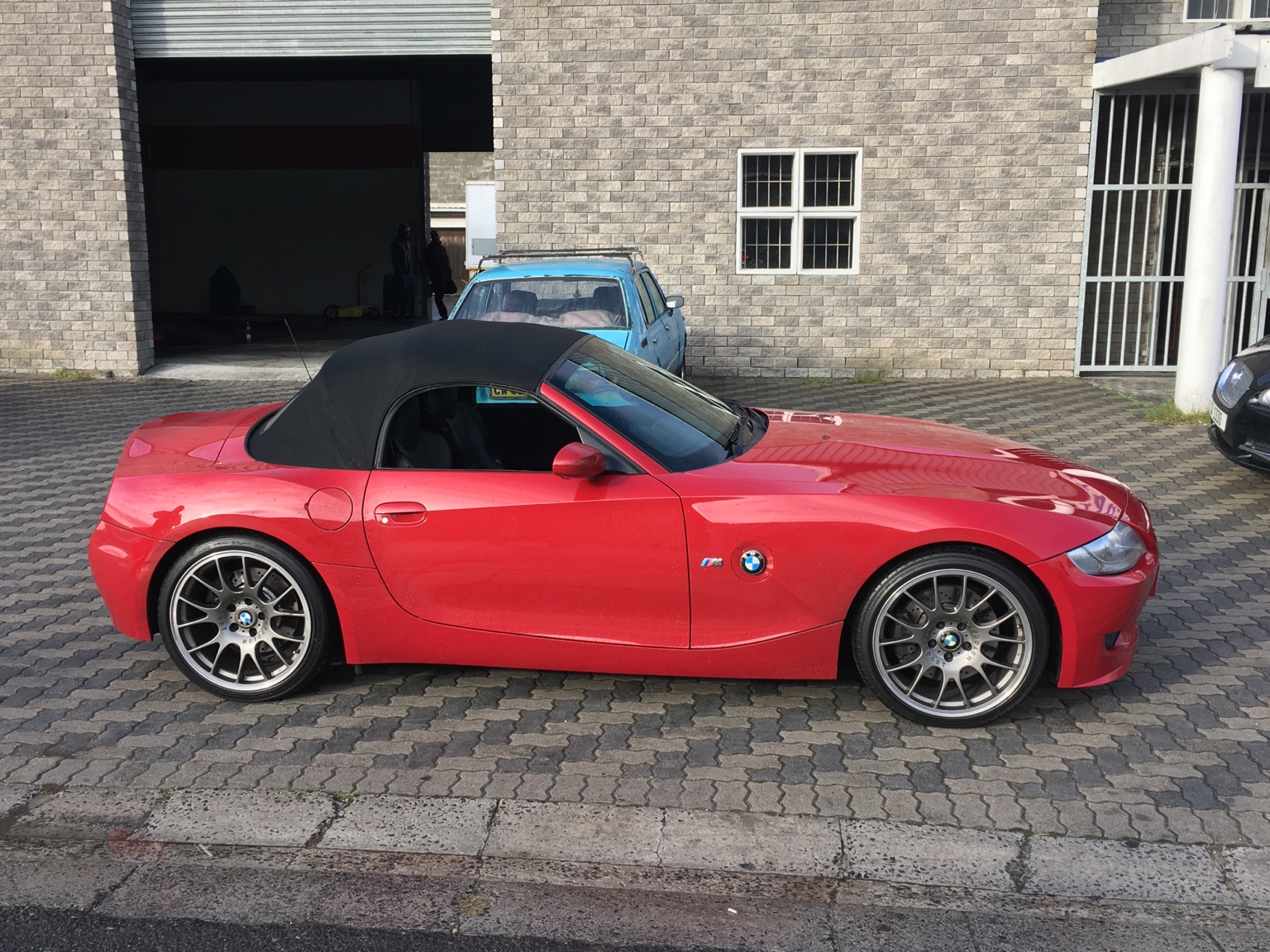

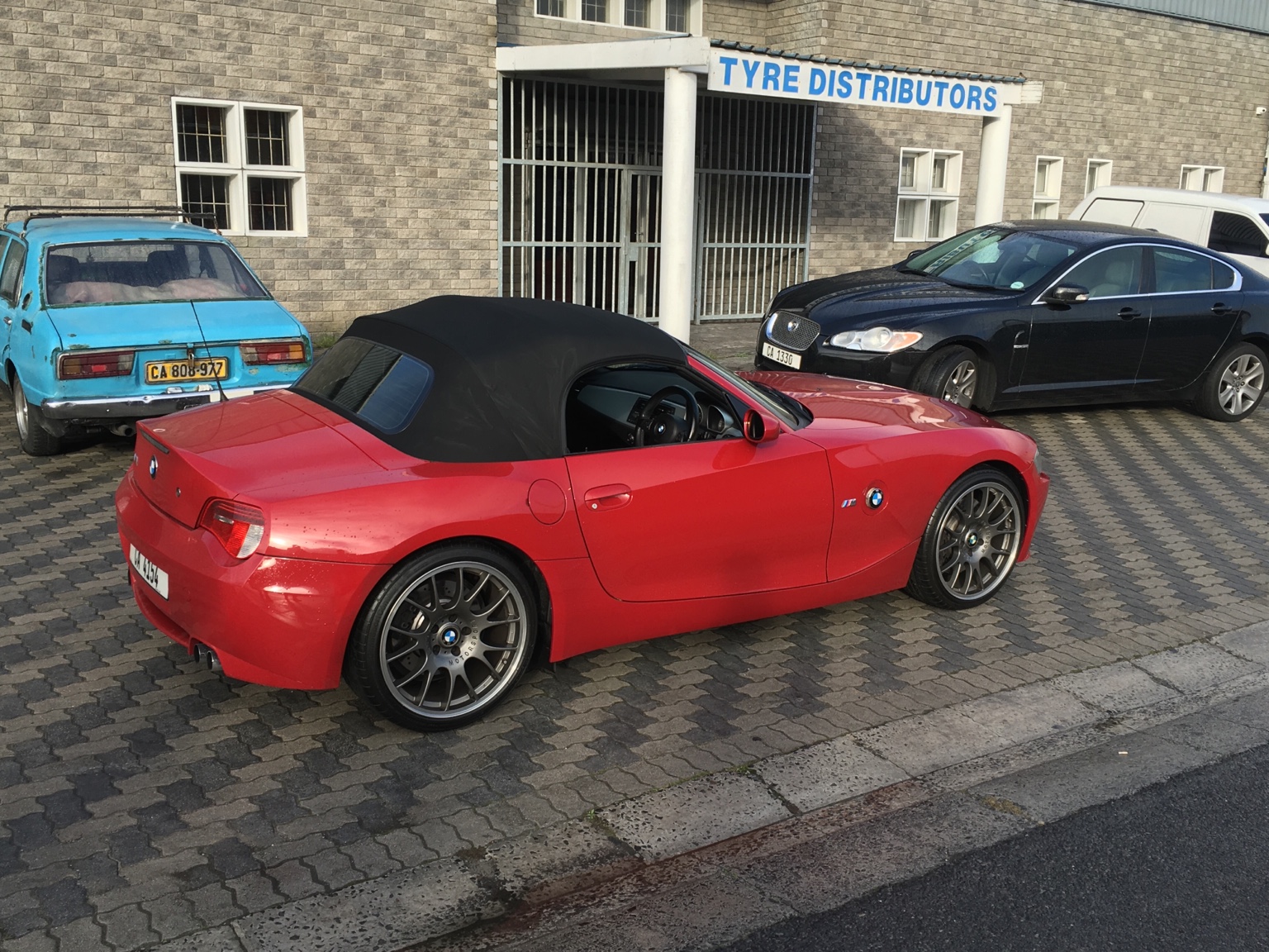

Razz
Thoughts on these wheels on the car?
AdiS
Not to my taste, but if you like them go for it. Just keep the originals for when it comes time to sell :)
