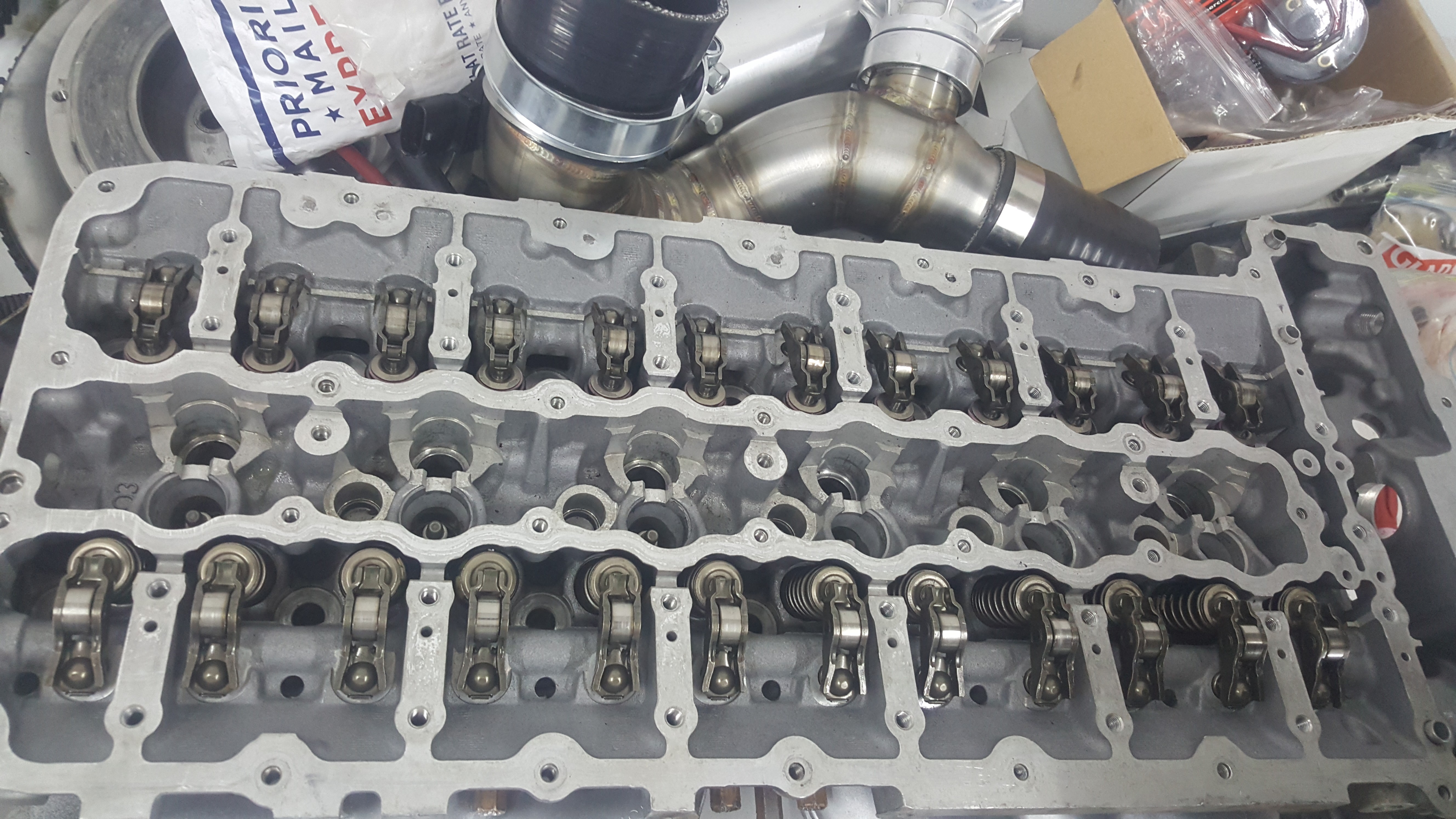

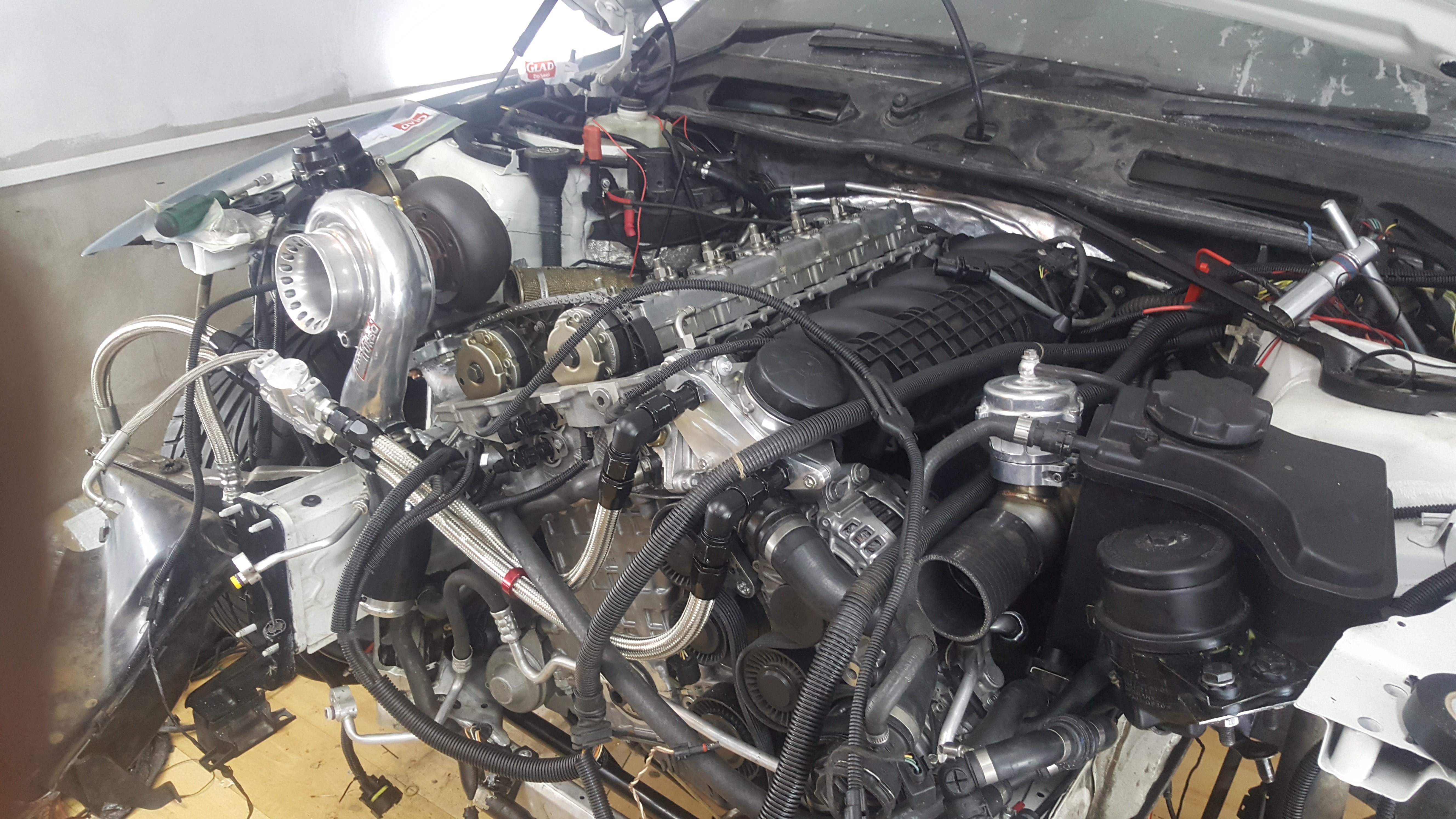

with the head all cleaned up and time to install the vanos as well as cams the day is drawing close

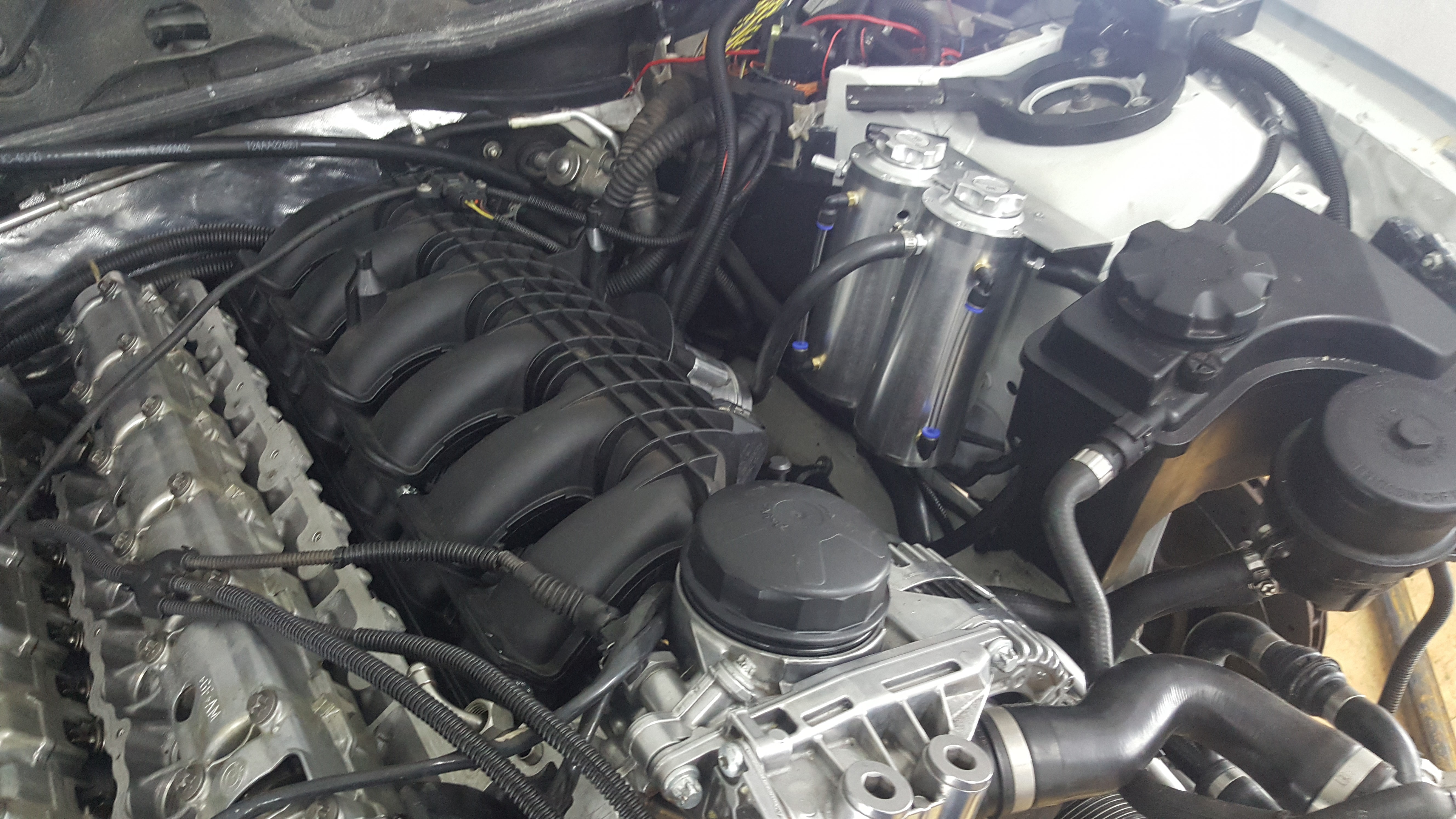

pic of the dual catch can setup

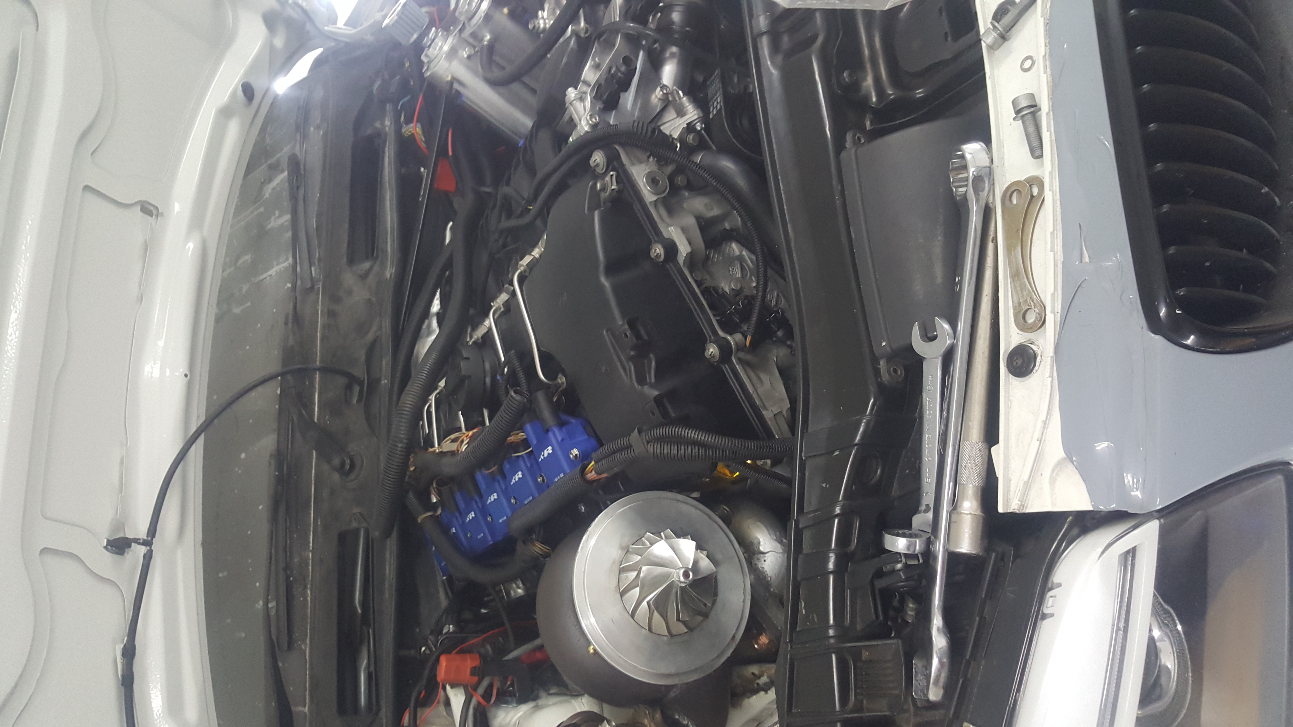

One thing is for sure ARP head studs makes putting the head back so much more easier. With the head one it was time to adapt the oem harness to accommodate the Precision Race Coils.
Once that was complete it was time to fit the E90 M3 cowl cover and and neaten up the engine bay.
