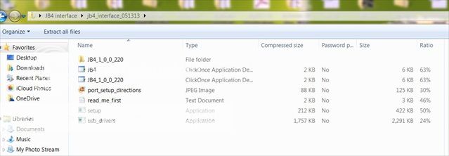

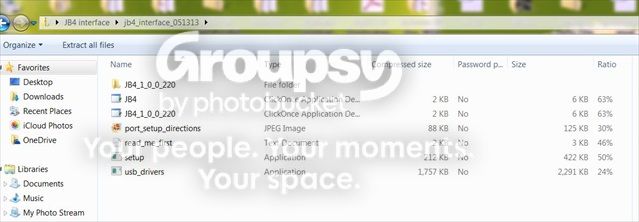

Twinz
Forum - Support
1. Download interface again.
2. Make sure you "extract all" files.
3. The usb drivers folder should download when you click on the setup icon. If not click on the usb setup icon as well and download drivers.
sageman
@twinz, thanks ive gone through the entire setup process twice and fully unistalled and re-installed everything, and followed terry's instruction on the n54tech site but can not get the ports to show in device manager? I will try it again and hopefully it will work, third time lucky!
Yes jb4 is working fine, just want to log and send it through to u to check please.

bit of a longshot here but try using a different port on your laptop and also updating the driver to the usb ports even though it might be up to date and working correctly...
if Microsoft ever made a nice OS it was XP and based on its success was its own downfall...
sageman
@kish i agree xp was the best.
Got it working thanks guys :thumbs:
