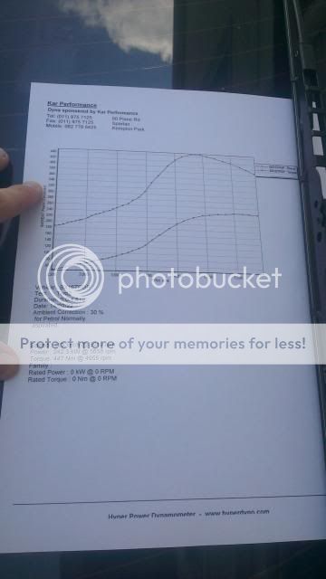

Met up with a few BMW fanatics this morning at KAR:
This time I decided to come with the Supra.
Unfortunately the dyno run was done in 3rd gear.....I will go back to dyno in 4th gear. (Shaine thought it was a 5 speed gearbox) but no biggie! I am really pleased with the graph.
Smooth like da Tropika baby!!!! :rollsmile::rollsmile::rollsmile:
