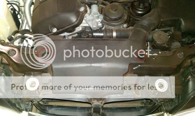

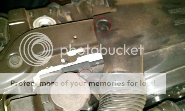

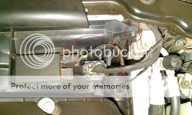

To fit the fan is literally 5 minutes work. Side cutter to lift the expanding rivets and a torx bit to remove one screw (I slotted mine with a hack saw so a normal flat screw drive works just fine - had no Torx available when it broke down once).
Here are the items to remove to loosen the fan and remove it:
Seems fairly wasy. Thanks :ty:
